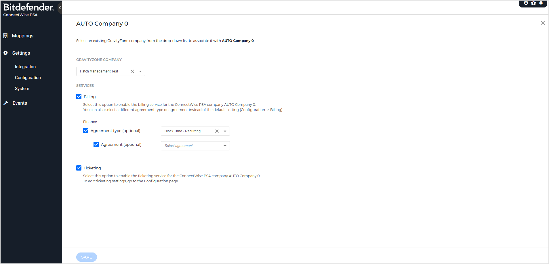

To create a mapping, follow these steps:
  1. Click the edit button for a ConnectWise PSA company.
  2. On the configuration page, select from the drop-down list the corresponding GravityZone company. The list includes only GravityZone companies that are not part of other mappings in the integration.
    You can select GravityZone companies that are suspended or on a trial license. The integration does not display their status and treats them as valid mappings.
  3. Select the checkbox to enable the Billing service, if you want it to be available for this mapping.
    Optionally, under Finance, select more options:
    1. Agreement type - select a different agreement type for this mapping to change the default agreement type selected under Settings > Configuration > Billing.
    2. Agreement - select an exact agreement based on the previous selected agreement type for the current mapping.
  4. Select the checkbox to enable the Ticketing service, if you want it to be available for this mapping.
  5. Click Save.
After the mapping is saved, the status of the mapping will be automatically shown as OK, with a green dot.
