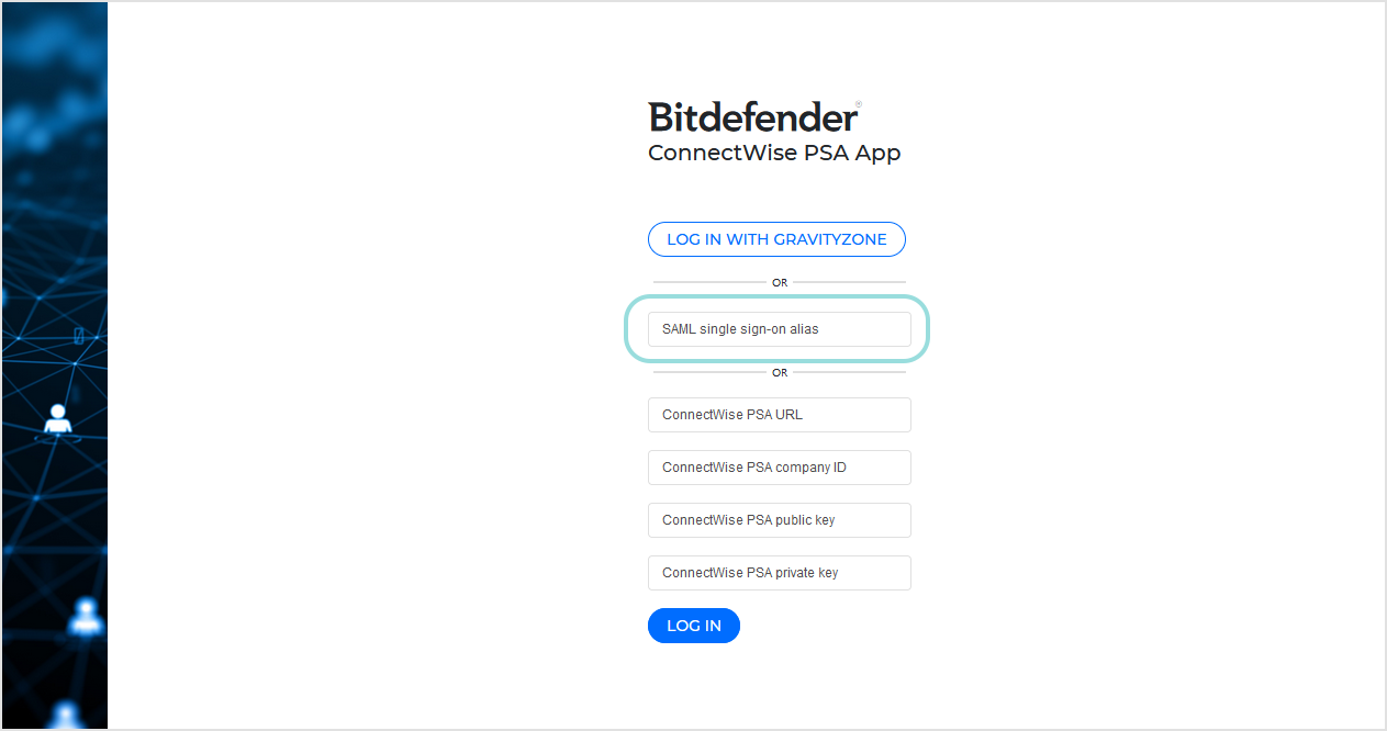

This is how SSO works with ConnectWise PSA App:
  1. You go to ConnectWise PSA App login page and enter the SSO alias configured for your ConnectWise PSA tenant.
  2. ConnectWise PSA App creates a SAML request and it forwards the request and the user to the identity provider configured for your tenant.
  3. You are redirected to the identity provider page, where you must authenticate.
  4. After successfully authenticating with the identity provider, the user is redirected back to ConnectWise PSA App.
  5. ConnectWise PSA App retrieves the response and validates it with the certificate fingerprint.
    Afterwards, ConnectWise PSA App allows you to log in with no other interaction.

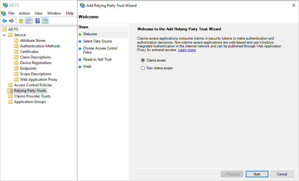

Adding a relying party trust
The connection between ConnectWise PSA App and AD FS is defined using a relying party trust. To add it, follow these steps:
  1. Log in to the server where AD FS is installed.
  2. Launch the AD FS Management application.

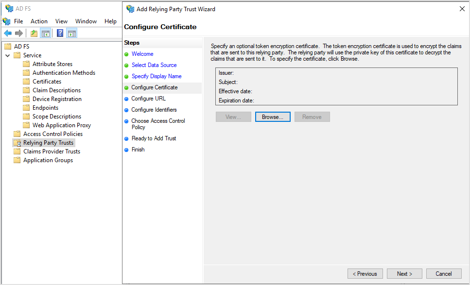

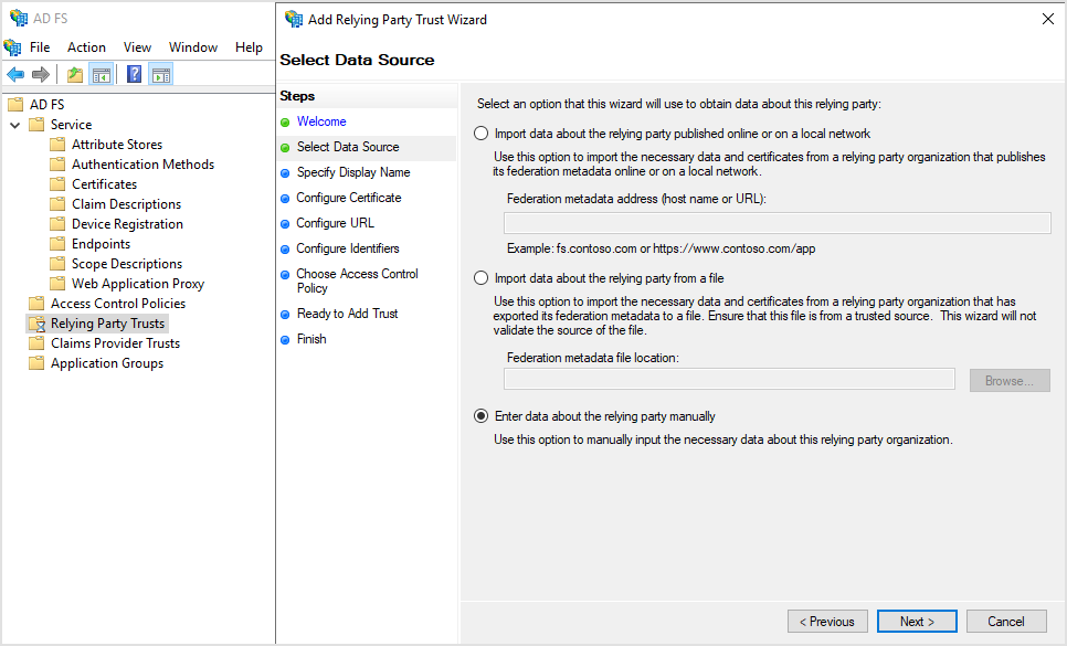

  3. In the application, select Relying Party Trusts > Add Relying Party Trust...
  4. In the Add Relying Party Trust Wizard window, on the Welcome page, select Claims aware and click Start.
  5. On the Select Data Source page, select Enter data about the relying party manually.
  6. Click Next.

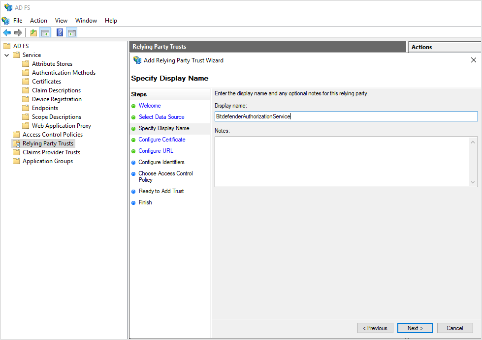

  7. On the Specify Display Name page, enter the name of the service provider. For example, BitdefenderAuthorizationService.
  8. Click Next.
  9. On the Configure Certificate page, click Next.

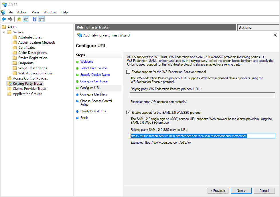

  10. On the Configure URL page, follow these steps:
    1. Select Enable support for the SAML 2.0 WebSSO protocol.
    2. Under Relying party SAML 2.0 SSO service URL, enter the following URL: https://authorization-service.rmm.bitdefender.com/api/saml/assertionconsumerservice
    3. Click Next.

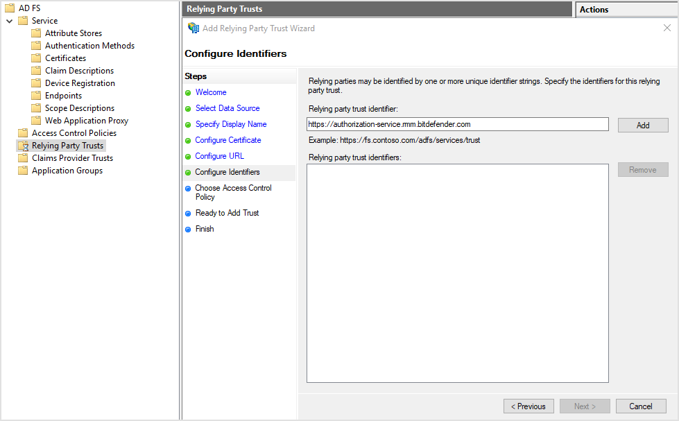

  11. On the Configure Identifiers page, enter the following URL for relying party trust identifier: https://authorization-service.rmm.bitdefender.com
  12. Click Add, then Next.

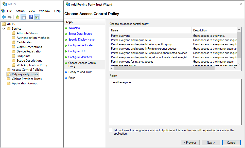

  13. On the Choose Access Control Policy page, select Permit everyone.

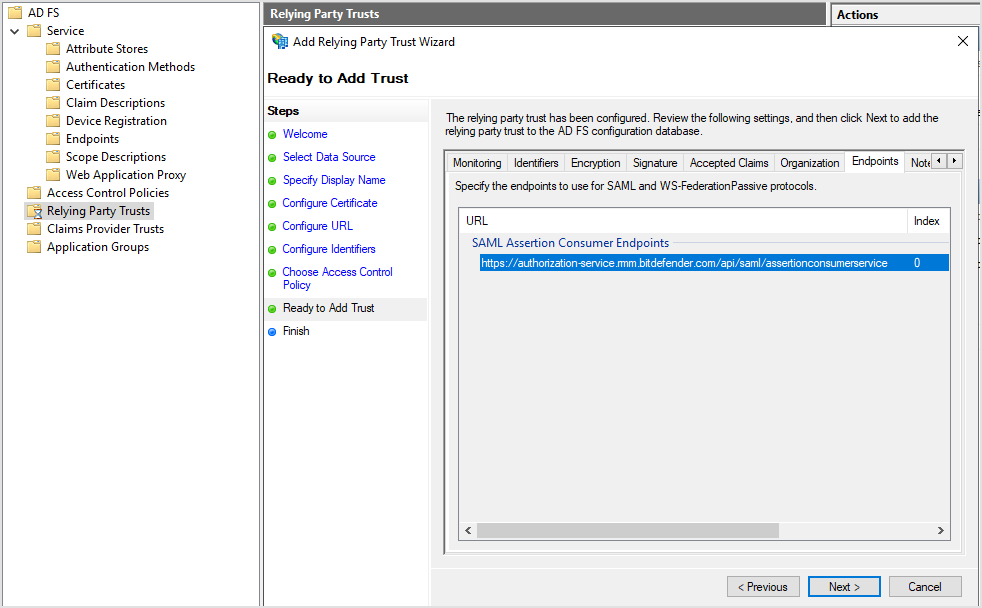

  14. On the Ready to Add Trust page, go to the Endpoints tab and verify the following URL has been added under SAML Assertion Consumer Endpoints:
    https://authorization-service.rmm.bitdefender.com/api/saml/assertionconsumerservice with binding POST

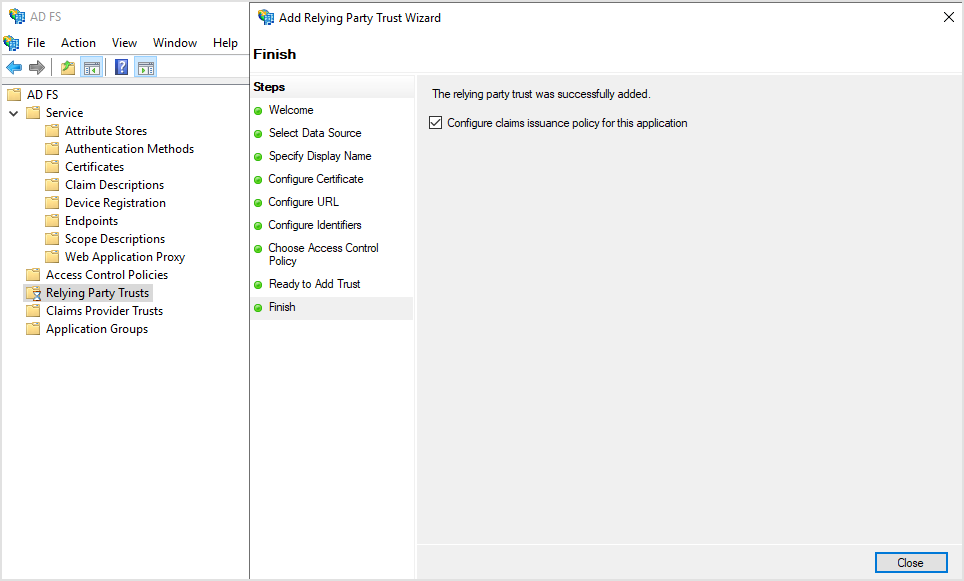

  15. On the Finish page, select Configure claims issuance policy for this application.
  16. Click Close.

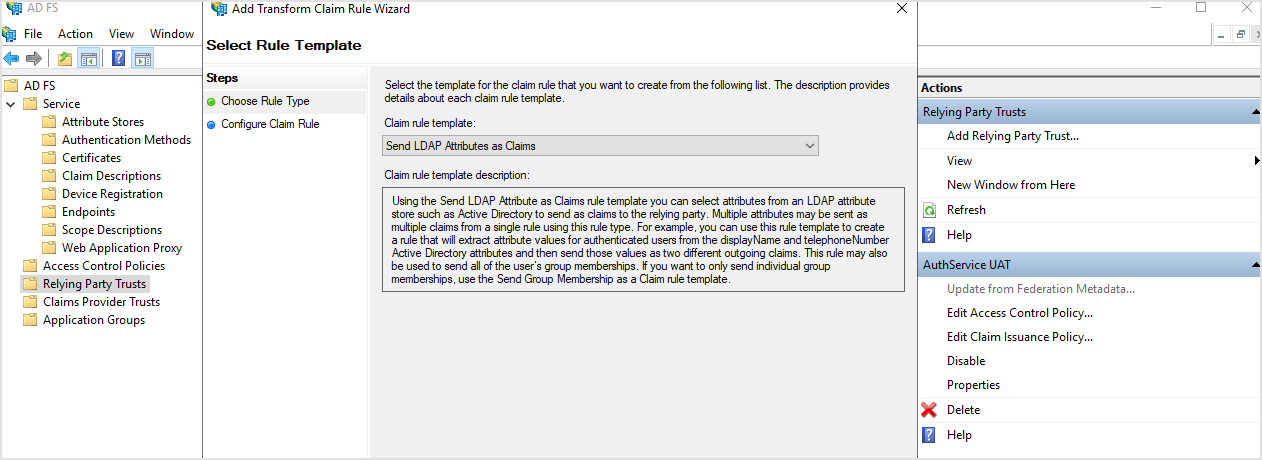

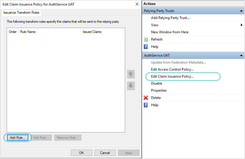

  1. In the AD FS Management application, click Edit Claim Issuance Policy...
  2. Click Add Rule to create a new rule.
  3. In Add Transform Claim Rule Wizard, on the Choose Rule Type page, select Send LDAP Attributes as Claims as claim rule template.
  4. Click Next.

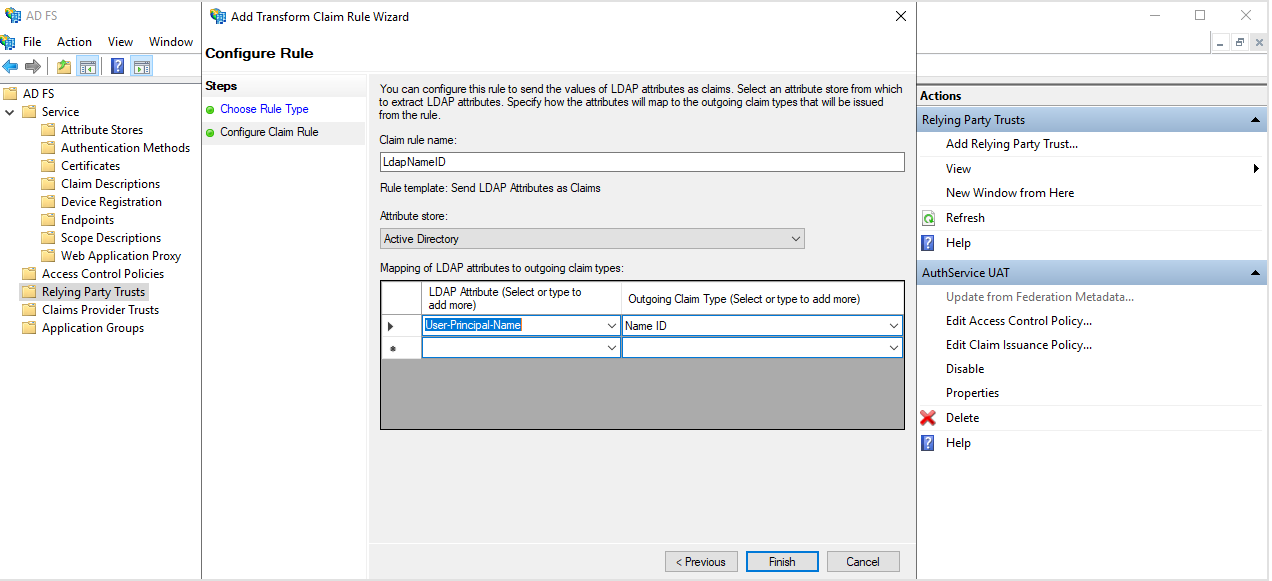

  5. On the Configure Claim Rule page, do this:
    1. In the Claim rule name box, enter a relevant name. For example, LdapNameID.
    2. For Attribute store, select Active Directory.
    3. In the table below, under LDAP Attribute (Select or type to add more), select User-Principal-Name.
    4. Under Outgoing Claim Type (Select or type to add more), select Name ID.
  6. Click OK, then Apply.

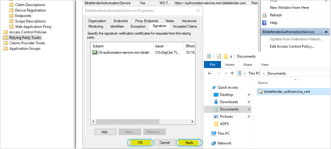

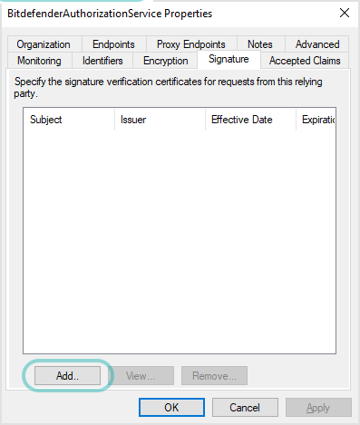

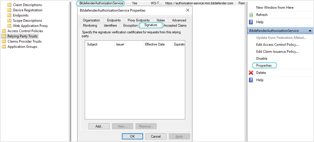

Upload the signature certificate
The ConnectWise PSA App integration with AD FS requires a signature certificate. To create the certificate, refer to the dedicated section at the beginning of this article.
For the certificate to be valid with AD FS, make sure you removed -----BEGIN CERTIFICATE----- and ----END CERTIFICATE----- from it.
To upload the signature certificate, follow these steps:
  1. In the left-side menu of AD FS Management application, go to Relying Party Trusts.
  2. In the central panel, select the relying party trust you created.
  3. In the Properties window, go to the Signature tab.
  4. Click Add.
  5. In the new window, select All Files (*.*) in the drop-down menu and upload the certificate.
  6. In the Properties window, click Add and OK.

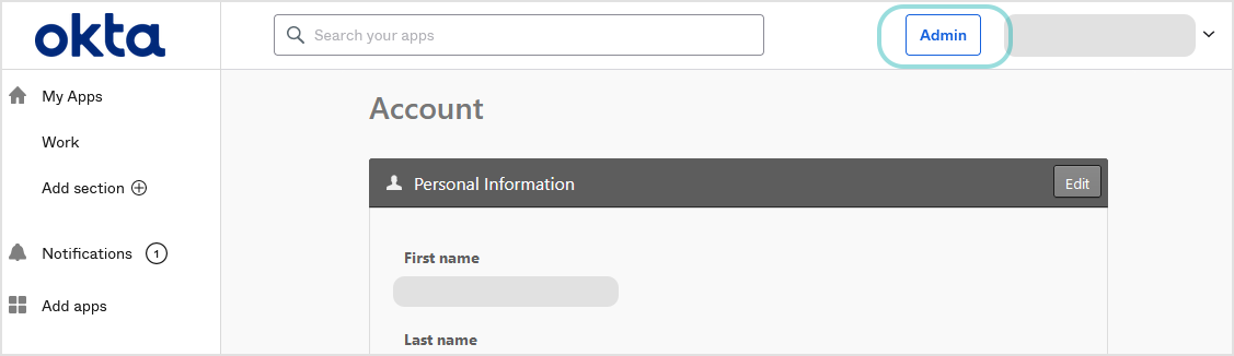

  1. Log in to Okta Admin Console.
  2. If not already selected, click Admin next to your username to access the settings that allow you to configure applications.

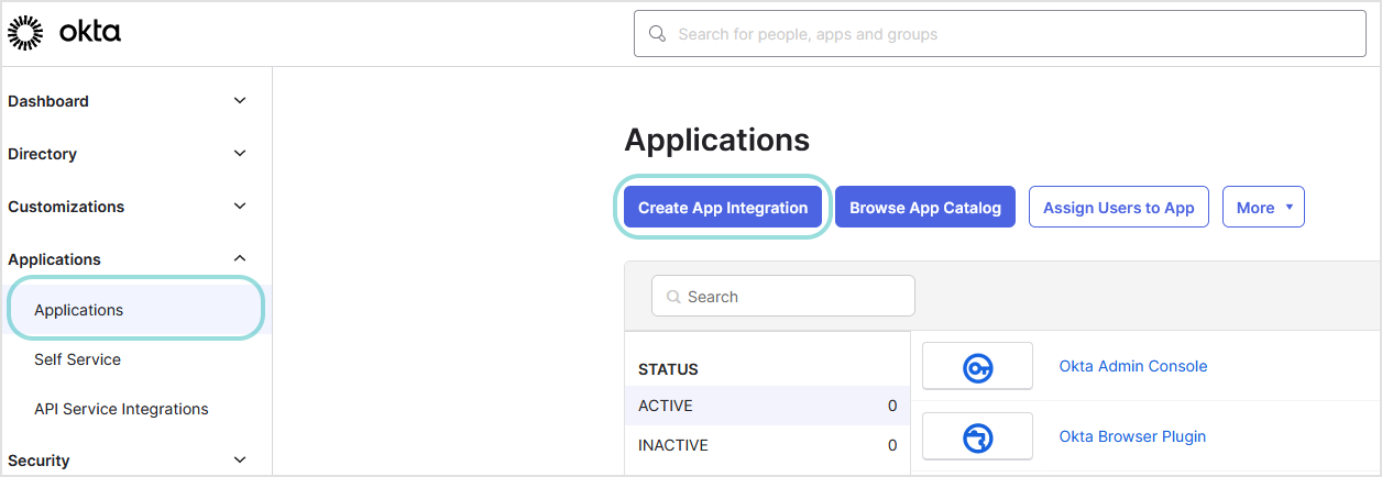

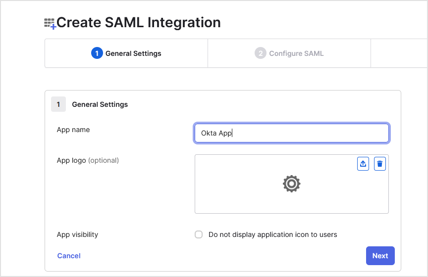

  3. In the left-side menu, go to the Applications section and click Create App Integration.
  4. In the Create a new app integration window, select SAML 2.0 as sign-in method and click Next.
  5. On the Create SAML Integration page, under the General Settings tab, follow these steps:
    1. Enter an app name (for example, ConnectWise PSA App).
    2. Optionally, upload a logo image and set your app’s visibility.
    3. Click Next.

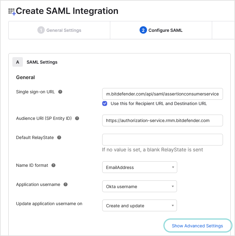

  6. On the Configure SAML page, follow these steps:
    1. Under Single sign on URL, enter https://authorization-service.rmm.bitdefender.com/api/saml/assertionconsumerservice
      Also select the check box for Use this for Recipient URL and Destination URL.
    2. Under Audience URL (SP Entity ID), enter https://authorization-service.rmm.bitdefender.com
    3. For Name ID format, select EmailAddress.

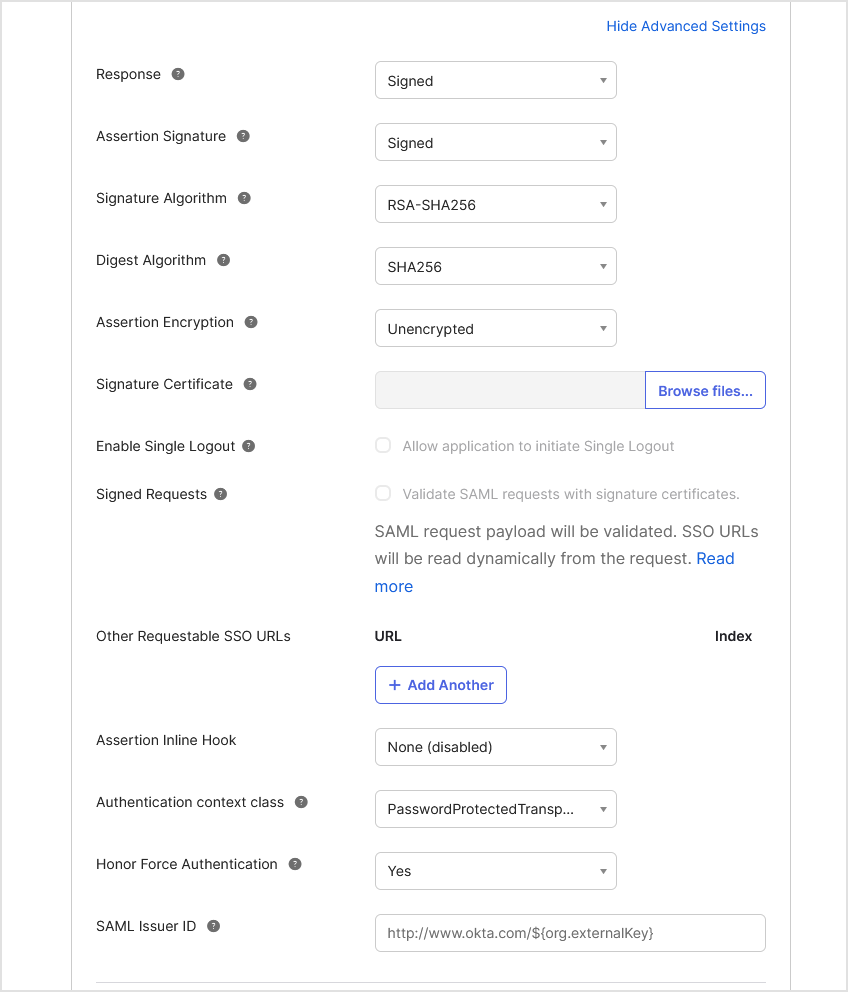

    4. Click the Show Advanced Settings link to add more configuration details.
    5. For Response, select Signed.
    6. For Assertion Signature, select Signed.
    7. For Signature Algorithm, select RSA-SHA256.
    8. For Digest Algorithm, select SHA256.
    9. For Assertion Encryption, select Unencrypted.
    10. For Signature Certificate, click Browse files... to upload the signature certificate that you have previously created.
    11. After you upload the certificate, the options for Enable Single Logout and Signed Requests become active. Do not select neither Allow application to initiate Single Logout nor Validate SAML requests with signature certificates.
    12. Under SP Issuer, enter https://authorization-service.rmm.bitdefender.com
    13. For Authentication context class, select PasswordProtectedTransport.
    14. For Honor Force Authentication, select Yes.
    15. For SAML Issuer ID, leave the default value: http://www.okta.com/${org.externalKey}
      Leave the rest of the fields blank, including Attribute Statements (optional) and Group Attribute Statements (optional).
    16. Click Next.

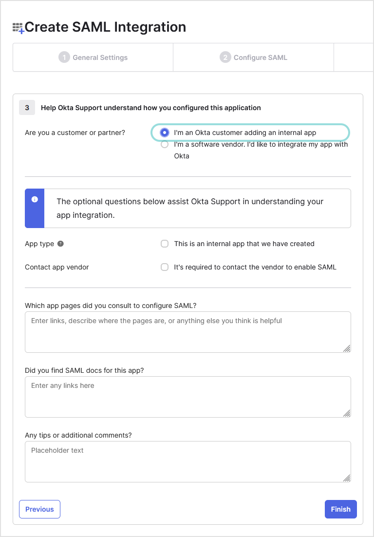

  7. On the Feedback page, select I'm an Okta customer adding an internal app.
  8. Click Finish.

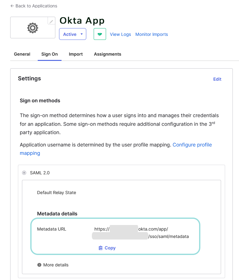

After finishing the configuration, Okta will redirect you to a page containing details about the application you have created. Follow these additional steps:
  1. In the Sign On tab, click the Copy button under the Metadata details section.
    This will copy a URL of the XML file which contains the metadata details that you have to paste in ConnectWise PSA App to enable SSO. Keep it at hand for future use.

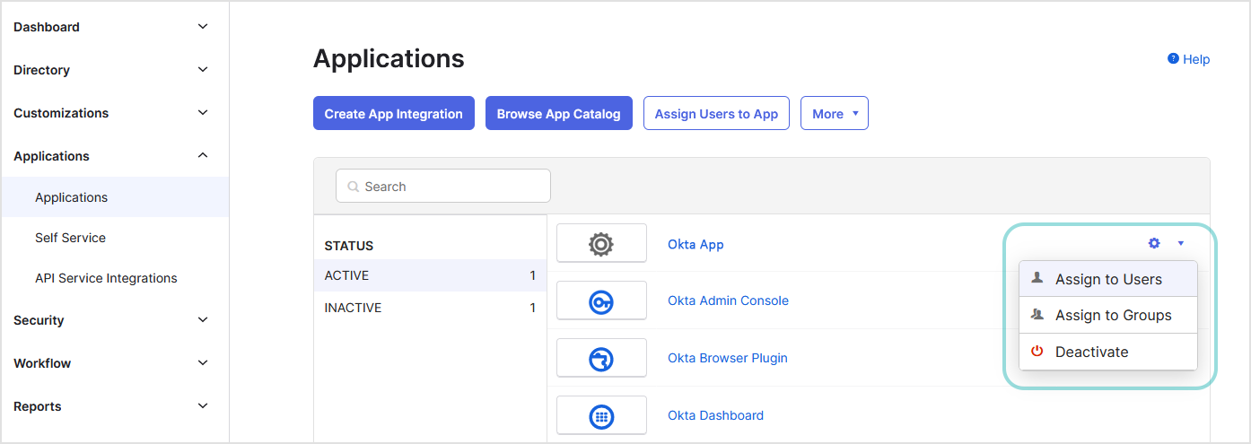

  2. Go to the Applications page in Okta to view the status of your application. The application must be active.
  3. Click the configuration button to assign the application to users, to user groups, or to deactivate it.

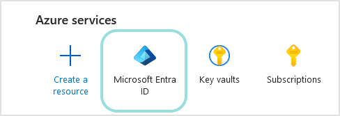

Configuring Microsoft Entra ID
You must configure a non-gallery application that will connect Entra ID to ConnectWise PSA App. To configure a non-gallery application, follow these steps:
  1. Log in to Azure portal.
  2. On the welcome page, go to Microsoft Entra ID.

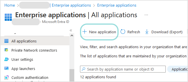

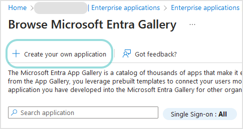

  4. At the upper-side of the page, click + New application.
  5. In the Browse Microsoft Entra Gallery section, click + Create your own application.

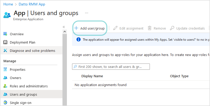

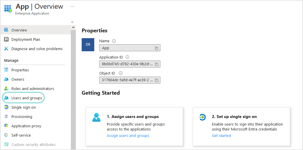

  7. On the Overview page of your application, go to Users and groups.
  8. Click + Add user/group user to assign users or user groups to your application.

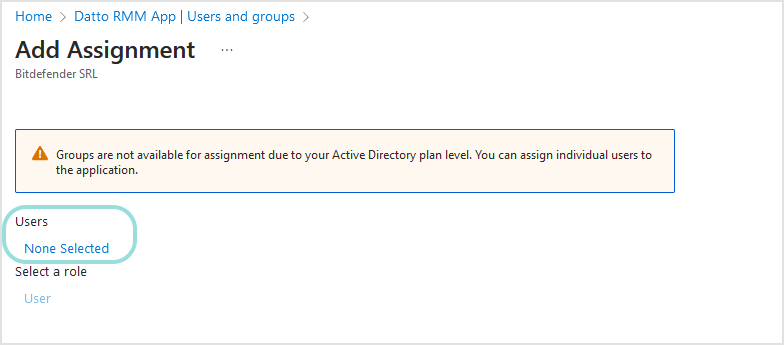

  9. On the Add Assignment page, go to Users and groups and click None Selected.

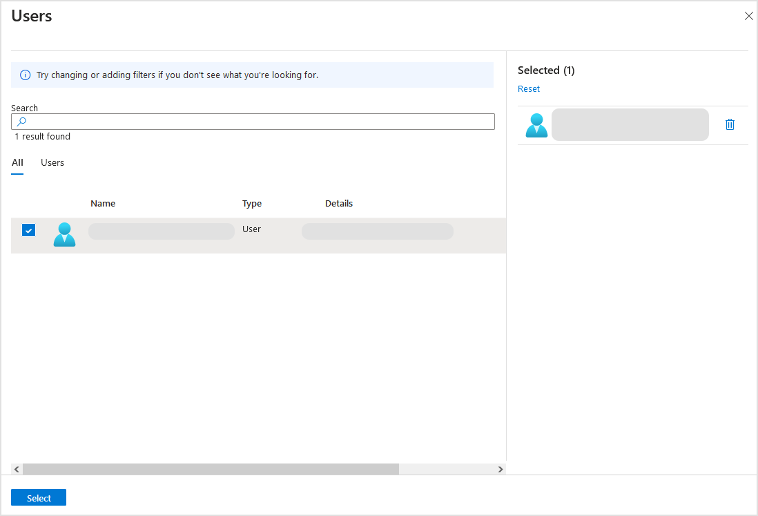

  10. In the right-side panel, select users to assign to the application and click Select.
  11. Back in the Add Assignment page, click Assign to confirm the users attached to your application.

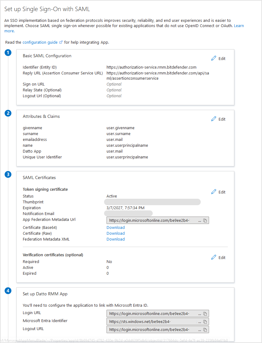

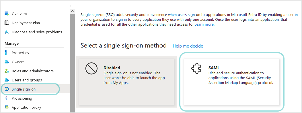

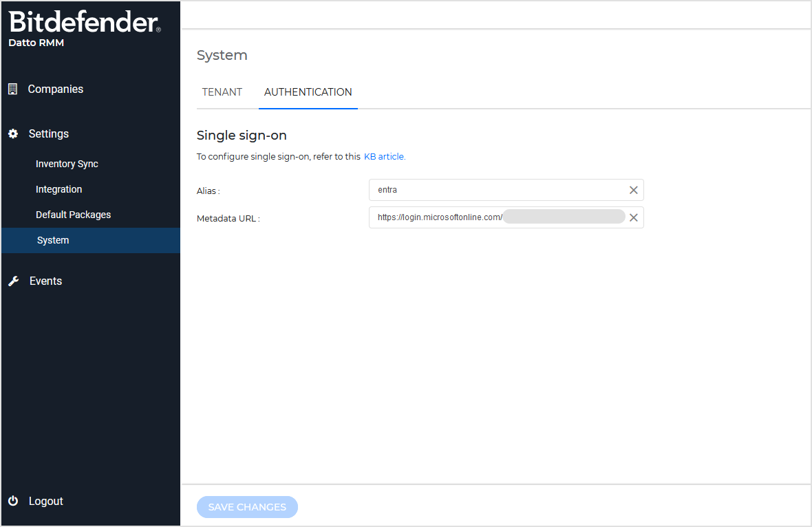

  12. Go to the Single sign-on section and click SAML.
  13. On the Set up Single Sign-On with SAML page, complete the following sections:
    • Basic SAML Configuration
    • Users Attributes & Claims
    • SAML Signing Certificate
    The options for these sections are detailed below.

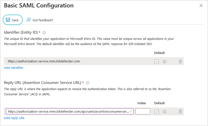

In the Basic SAML Configuration section, follow these steps:
  1. Click the pencil icon to edit.
  2. Configure the following fields:
    • Identifier (Entity ID). Enter https://authorization-service.rmm.bitdefender.com
    • Reply URL (Assertion Consumer Service URL). Enter https://authorization-service.rmm.bitdefender.com/api/saml/assertionconsumerservice
  3. Click Save.
Return to the setup page.

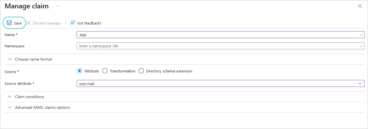

User Attributes & Claims
In the Attributes & Claims section, follow these steps:
  2. On the new page, click the + Add new claim option.
  3. Configure the following fields:
    • Name. Enter a name for this claim.
    • Source. Select Attribute.
    • Source attribute. From the drop-down menu, select user.mail.
  4. Click Save.

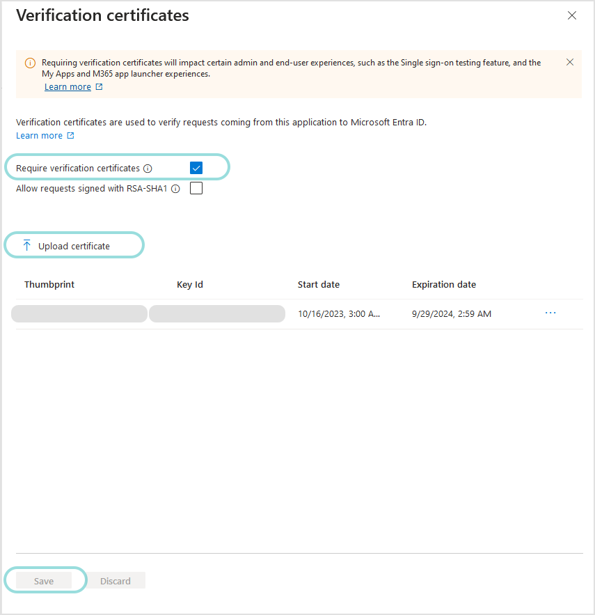

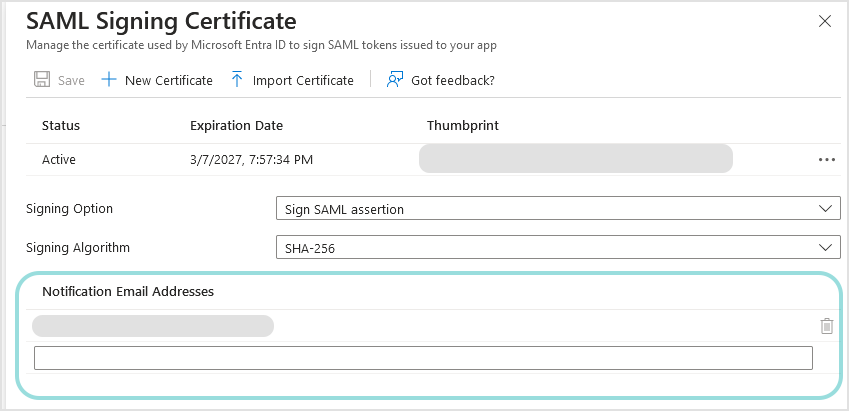

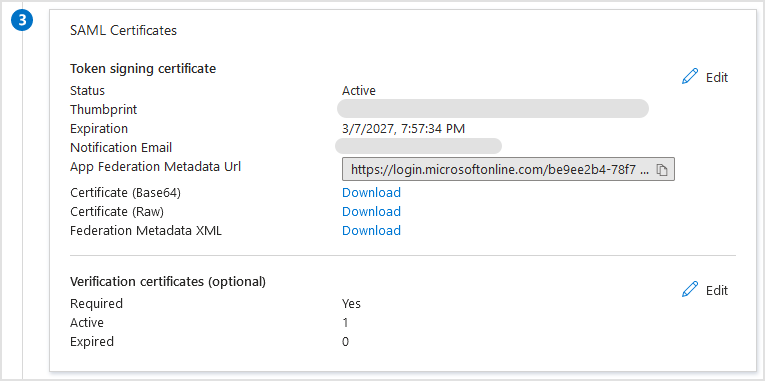

SAML Certificates
Make sure Microsoft Entra ID has a trusted SAML certificate. A self-signed certificate cannot be used with the ConnectWise PSA integration.
In the SAML Certificates section, follow these steps:
  1. For Token signing certificate, click the pencil icon to edit.
  2. In the configuration page, enter an email address for certificate expiry reminders.
  3. Click Save.
  4. Back in the setup page, go to Verification certificates (optional) and click the pencil icon to edit.
  5. In the configuration page, select Require verification certificates and click to upload the certificate that you have previously created.
  6. Click Save.
The SAML Signing Certificate section also displays the App Federation Metadata URL.
This is the metadata URL, which you need to add in ConnectWise PSA App when configuring single sign-on.
Click the Copy to clipboard button to copy and paste the URL somewhere at hand or keep this window open in your browser for future use in ConnectWise PSA App .
Configuring ConnectWise PSA App
After you have configured the identify provider, you must enable single sign-on in ConnectWise PSA App. Follow these steps:
  1. In ConnectWise PSA App, go to System > Authentication.
  2. Under Manage Single Sign-On, enter the the following details:
    • For alias, enter a name.
      The name must be unique (not used by other ConnectWise PSA tenants) and can contain at least five alphanumeric characters. You can use the hyphen (-) as a character.
    • For metadata URL, enter the link you have previously saved when finished configuring the corresponding application in the identity provider.
  3. To enable single sign-on, click Save Changes.
Next time you log in to ConnectWise PSA App with just your alias.
