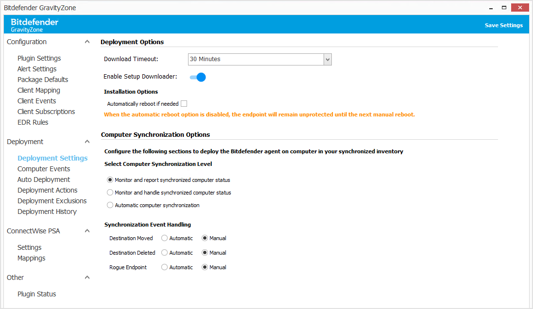

Under Computer Synchronization Options, configure the scope and event handling for the synchronized computer.
The options for the computer synchronization options are the main tool for you to control the synchronization of ConnectWise computers. The computer synchronization task is performed automatically by the plugin each hour.
The Computer Synchronization Options section is available starting with plugin version 1.4.0.167 as part of a controlled rollout. If this section is not available in your integration yet, you can use the Automatic Deployment Retry option under Deployment Options to set the time interval for the Bitdefender security agent to retry installation in case of errors.
Configuring computer synchronization options
These options cover two areas:
Scope – it refers to the computers affected by the sync task. Scope may be:
Only synchronized entities – the sync task operates on ConnectWise Automate computers that have an association with GravityZone endpoints.
Entire inventory – the sync task operates on all computers, regardless they have an association with GravityZone endpoint or not.
Event actions – they refer to the action taken for sync events. Event actions may be:
Report only – the task only reports events in the interface and you have to handle them manually.
Handle – the task tries to handle the events according to the configured options.
To configure the Computer Synchronization Level settings, follow these steps:
Select one of the available options, as described in the table below.
Computer synchronization level
Scope
Event actions
Monitor and report synchronized computer status
The sync task operates only on computers that have an association.
The sync task only reports events in the Computers Events screen. It ignores the options in the Synchronization Event Handling section.
Monitor and handle synchronized computer status
The sync task handles events according to the options in the Synchronization Event Handling section.
Automatic computer synchronization
The sync task operates on all computers (whether they have an association or not), except exclusions.
The Automatic computer synchronization level has in scope all computers belonging to mappd ConnectWise clients for Bitdefender security agent deployment.
To exclude computers, clients, and locations from installing the Bidefender agent, please create exclusions under Deployment Exclusions.
Select the type of action for handling each event:
Automatic - the synchronization task tries to handle the event without your intervention. If it fails, the event will be presented to you for manual fixing.
Manual - you have to manually handle each event generated in the Client Events screen of the plugin.
The synchronization task applies the configured actions only if you selected Monitor and handle synchronized computer status or Automatic computer synchronization.
For example, if you select Automatic computer synchronization and the event handling for all the generated events is set to Manual, the sync task will generate events for possible synchronization issues, but it will not handle them. That means you need to go to the Computer Events screen and take any actions there manually.
Click Save Settings to apply the configuration.

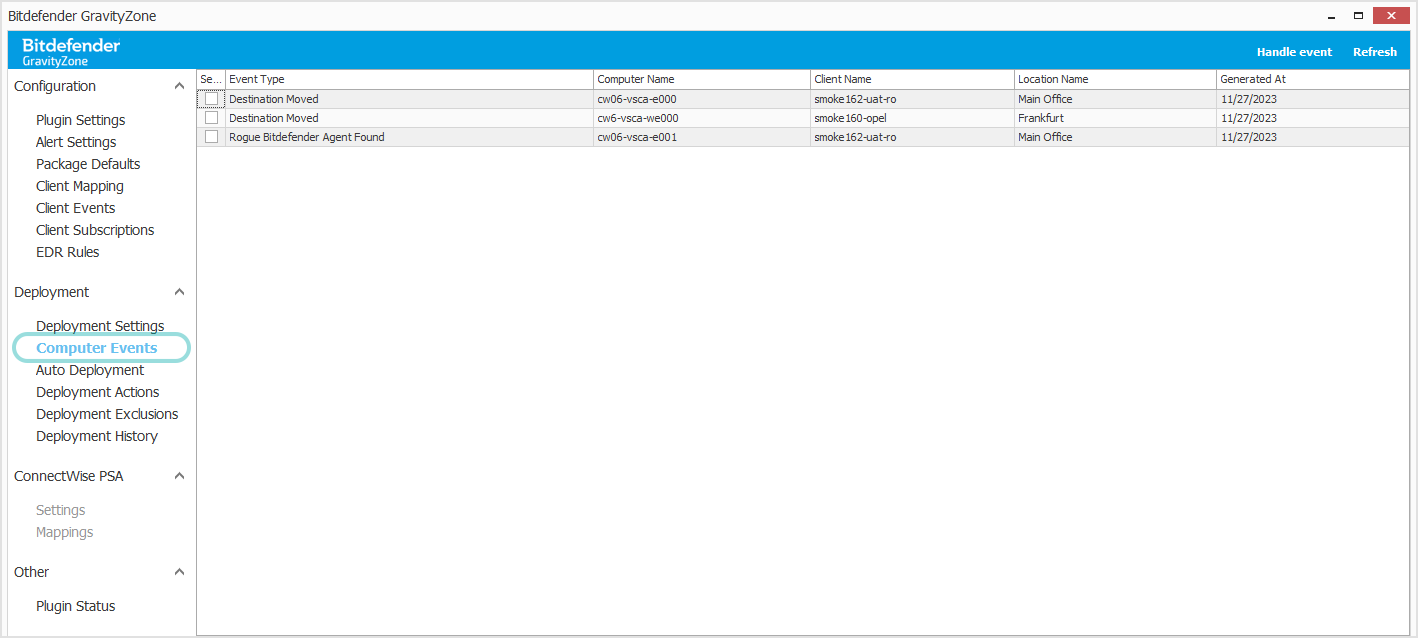

You can view and handle synchronization events manually in the Computer Events screen. This section displays only events that have been configure for manual handling or that the system has failed to handle automatically.
To handle an event, follow these steps:

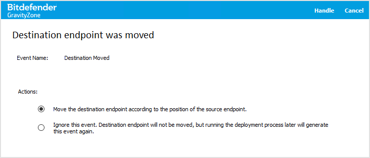

In the Computer Events grid, select the check box corresponding to the event and click Handle event.
In the details window, select an action from the predefined list.
The available actions for each event are described in the table below. Each event has two or more possible actions.
Event type | Description | Manual actions |
Destination Moved | The computer was moved from its original location, inside the same client or between clients. |
Destination Deleted | The Bitdefender security agent was uninstalled from the ConnectWise computer. |

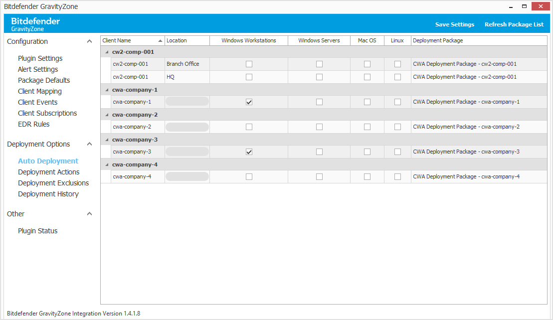

The integration uses auto-deployment to install the Bitdefender agent on new, unprotected machines. If you use the Computer Synchronization Options section under Deployment Settings, deployment attempts occur with each recurrent sync task. If this section is not available to you yet, deployment attempts occur once per day. To ensure successful deployment, verify that the target location is specified and the computers are not excluded.
If the computer synchronization level under Deployment Settings is set to Automatic computer synchronization, all mapped inventory is in scope for Bitdefender agent deployment.
You can select Auto Deployment for Windows workstations and servers, macOS, and Linux machines.
In Automate Control Center, go to Tools > Bitdefender GravityZone.
Go to Auto Deployment.
Select the check boxes corresponding to your target machines.
Click Save Settings in the upper right-hand corner to confirm the changes.
If you are using the computer synchronization options under Deployment Settings, automatic agent deployment occurs with each recurrent sync task. If these features are not available with your plugin,automatic deployment begins within 10 to 15 minutes.

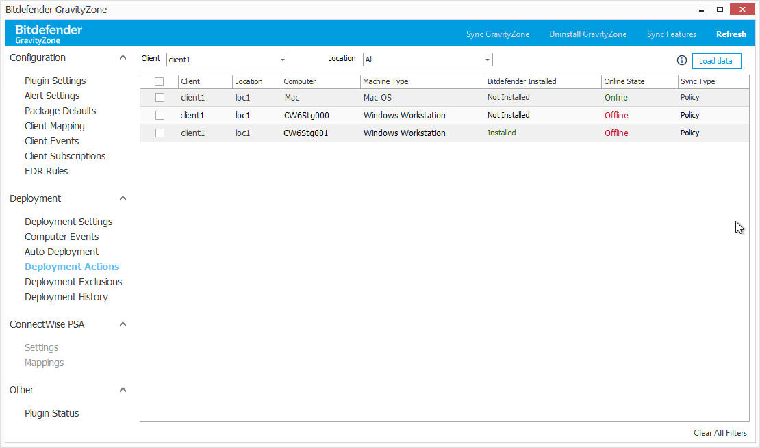

In the Deployment Actions section, you can perform different actions depending on whether you are using the plugin version with advanced synchronization options.
If you are using the plugin version without advanced synchronization options, you can manually initiate installation or uninstallation commands on machines, clients, or locations. Use the right-side menu to make specific selections. If an action is not applicable, the corresponding options in the right-side menu are grayed out. For example, for unprotected machines, the Uninstall GravityZone and Sync Features buttons are disabled.
If you are using the plugin version with advanced synchronization options, you can manually install, uninstall, or synchronize the Bitdefender agent on computers, clients, or locations. By default, the section does not display inventory data. To view entities, use the Client and Location filters and click the Load data button. To reset the filters, use the Clear All Filters option at the bottom of the section.
Loading large inventories may take some time. For best performance, it is recommended that you select up to 3,000 computers at a time.
In the grid, you can view the following details on computers:
Client name
Location name
Computer name
Machine type, which refer to the operating system running on the computer: Windows for workstations, Windows for servers, MacOS, or Linux.
Bitdefender agent installation status, which can be:
Installed - the Bitdefender agent is installed.
Verification Pending - Bitdefender agent verification has not started yet.
Not Installed - the Bitdefender is not installed.
Installed without features - the Bitdefender agent is installed without protection modules or other features.
Installed with Issues - the Bitdefender agent has issues with Full Disk Access and system extensions on macOS, or with critical services not started on Linux, such as
bdsrvscand
,epagd
orbdlogd
.Install Pending - Bitdefender agent installation has not started yet.
Uninstall Pending - uninstalling the Bitdefender has not started yet.
Online state - the computer is either online or offline.
Sync type - the Bitdefender agent synchronizes its features with the GravityZone policy or with the installation package.
The synchronization type is configured in the Client Mapping or Client Subscriptions sections when using the Deployment Modes wizard:
Package - Package Defaults or Custom Package
Policy - Sync with Policies
The following actions are available in this section:
Some options may be grayed out if they do not apply to the selected targets. For example, the Uninstall GravityZone and Sync Features buttons are grayed out when you select unprotected computers.
Sync GravityZone - installs the Bitdefender agent on computers or synchronizes its status.
Uninstall GravityZone - uninstalls the Bitdefender agent from computers.
Sync Features - removes or adds protection modules or other features to the Bitdefender agent according to the active GravityZone policy or to the installation package.
The option is only available for Windows operating systems.
Refresh - reloads inventory data in the grid.
To install the Bitdefender agent:
Select targets in the Client and Location filters.
Click the Load data button to populate the grid with computers.
Select one or more computers.
Click Sync GravityZone.
An install task starts for the selected machines that have the Bitdefender agent not installed. If the Bitdefender agent is installed, the Sync GravityZone action will synchronize the status of the computer and check these scenarios:
