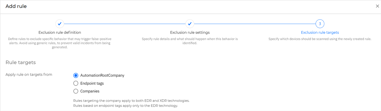

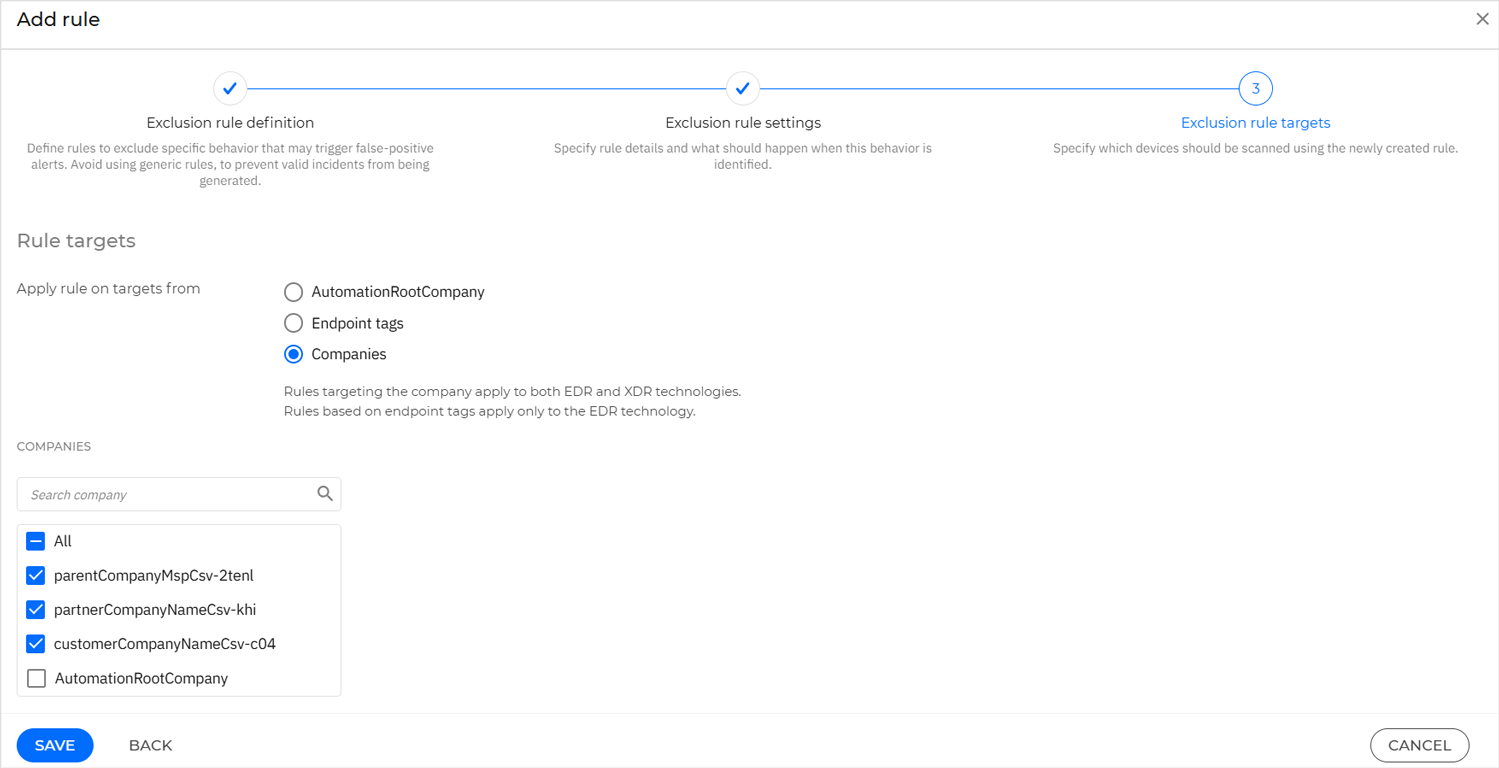

  4. Set the application of the rule in the Exclusion rule targets section:
    There are three methods of applying the rule to endpoints:
    • Apply the rule to your company directly - This method applies the rule to all the managed entities from your company.
      This option will be displayed using your company name.
      This method is compatible with all parameters.
    • Endpoint tags - This method only applies the rule to endpoints that have specific tags assigned.
      Rules applied using this method apply only to behavior detected through the EDR feature. They are not compatible with XDR technology.
      Tip
      You can manage endpoint tags from the Network > Tags Management page.
      Select the checkboxes for the tags you want from the Endpoint tags list on the left side of the section. You can use the search field to look up specific tags.
      All selected tags are added to the Selected endpoint tags list on the right side of the section.
    • Companies - The rule will apply only to the selected managed companies.
      You can select the companies from the Companies list. Your selection automatically appears at the top of the list.

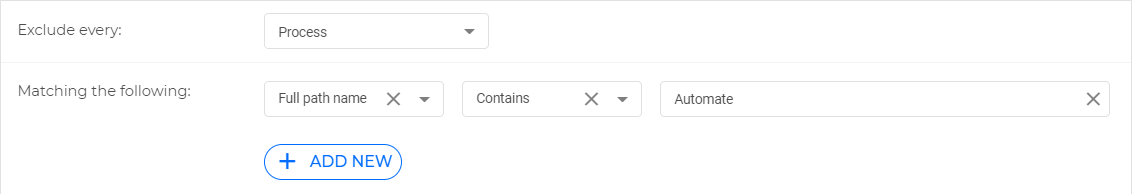

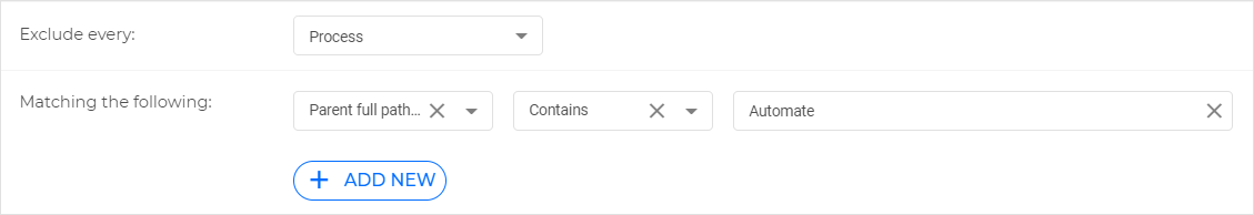

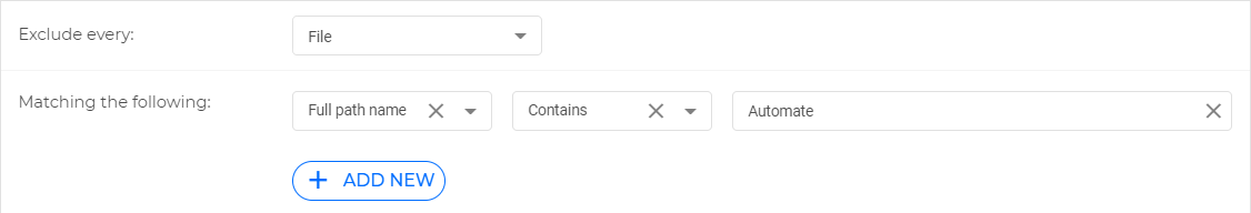

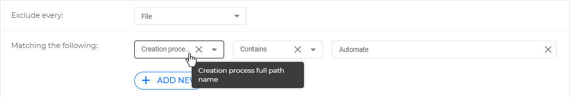

Let's consider the following scenario: you need to exclude anything with the word "Automate" in the name.
To achieve this result, you would have to create four exclusion rules: two for processes and two for files.
Here's an example of what the process rules might look like:
Exclusions - Parent process path
Exclusions - Process path
Here's an example of what the file rules might look like:
Exclusions - File creation process path
Exclusions - File path

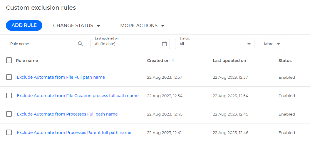

All rules will be listed in the Custom exclusion rules grid:
Exclusion rules
