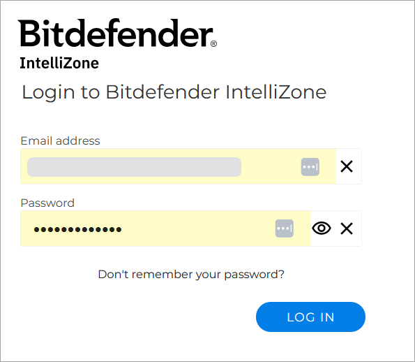

  1. Go to the IntelliZone portal.
  2. Log in using your credentials:

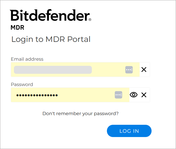

    The following error will appear:
    You will be redirected to the Bitdefender MDR login page.
  5. Enter your IntelliZone credentials and click Log in:
You will be immediately redirected to the IntelliZone console.

  3. Go to the IntelliZone portal and log in.
    You will be logged in normally to the IntelliZone console.
