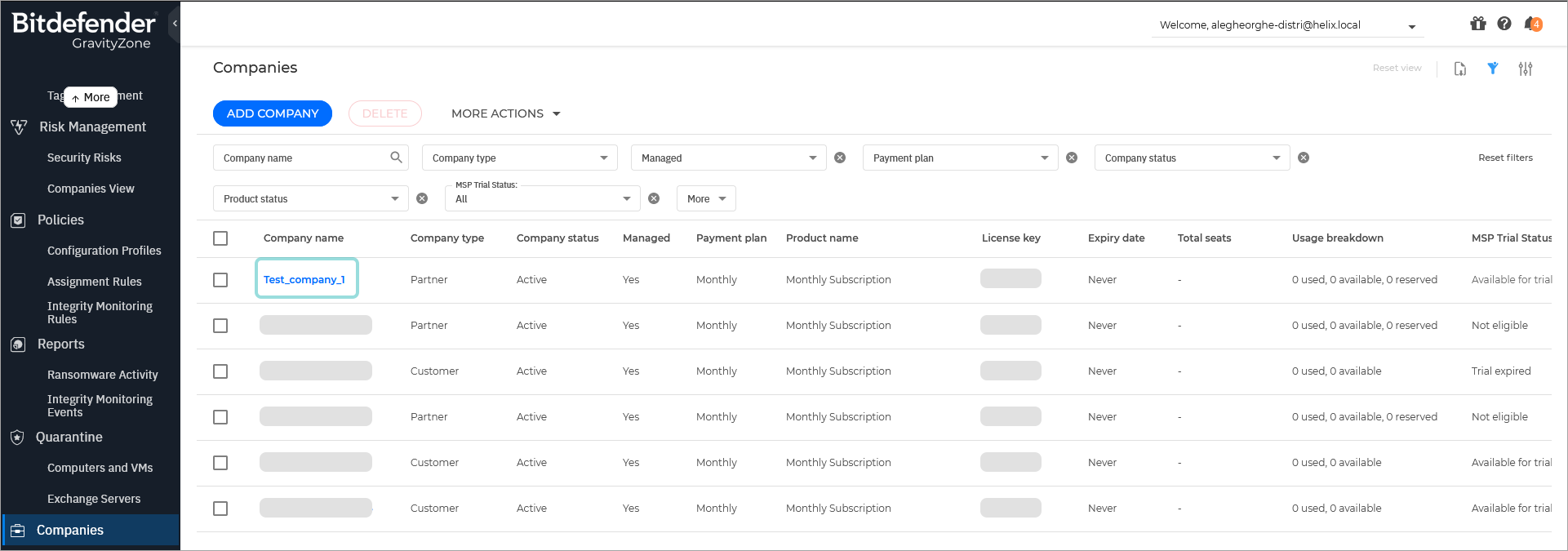

    1. Go to the Companies page from the left side menu.
    2. Click the name of the company you want to enable the service for.
      The Edit company window is displayed.

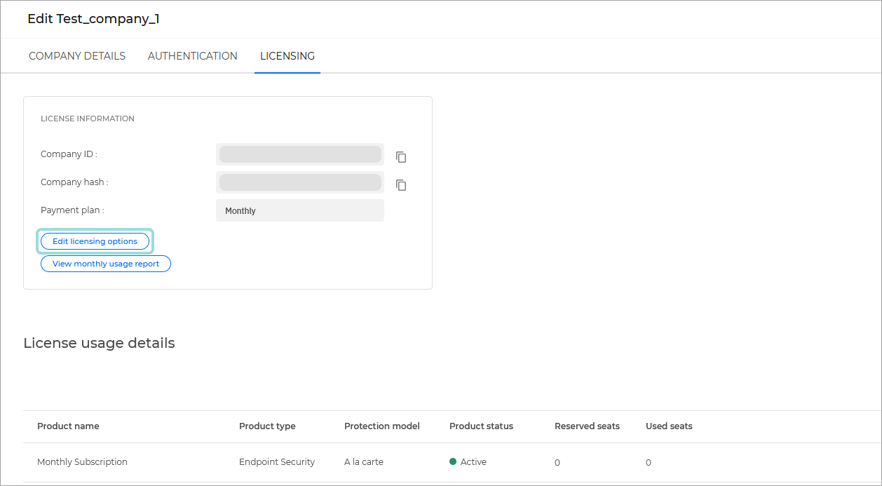

    3. Go to the Licensing tab.
    4. Click the Edit licensing information button under the License information section.
      The Licensing pane is displayed.

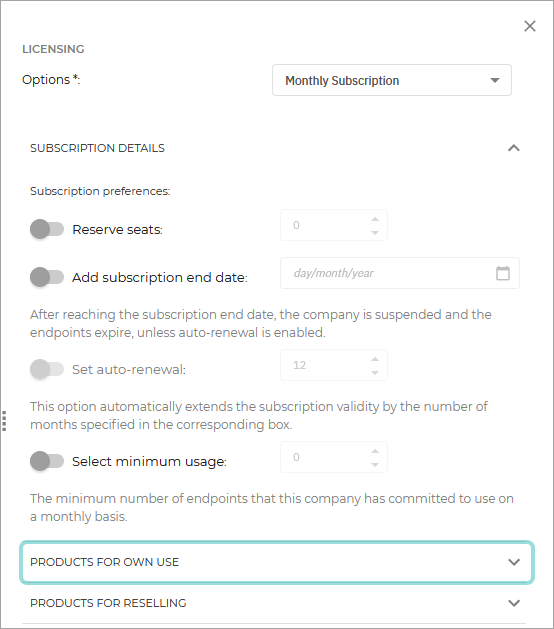

    5. Click on Products for own use to expand the section.
    6. Under Select protection model select one of the available options.

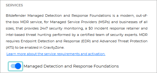

      The Secure Plus and Secure extra include access to the Managed Detection and Response Foundations service. If you select one of these options, ignore step g.
    7. Scroll down to the Services section and enable the Managed Detection and Response Foundations option.
      If you have selected the A la carte protection model, the Endpoint Detection and Response (EDR) and Advanced Threat Security (ATS) add-ons must be enabled before you can enable this option.
    8. Click Save.
