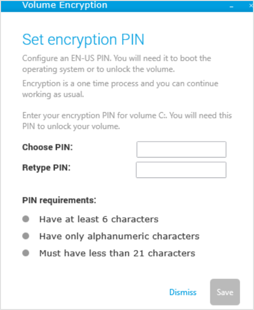

The security agent prompts the users to configure a PIN. For details, refer to Encryption.
If the TPM does not work or GravityZone does not detect it, the user will be prompted to configure an encryption password. For details, see the section below referring to the encryption process on endpoints without TPM.
After clicking the Save button, the security agent sends a recovery key associated with the encryption PIN to the GravityZone console.
Once the GravityZone console returns a confirmation response to the security agent, the encryption process starts on the boot disk (C:) and continues with the other disks.
If clicking the Dismiss option, the encryption window disappears and reappears after a while, as long the policy is active on the endpoint.

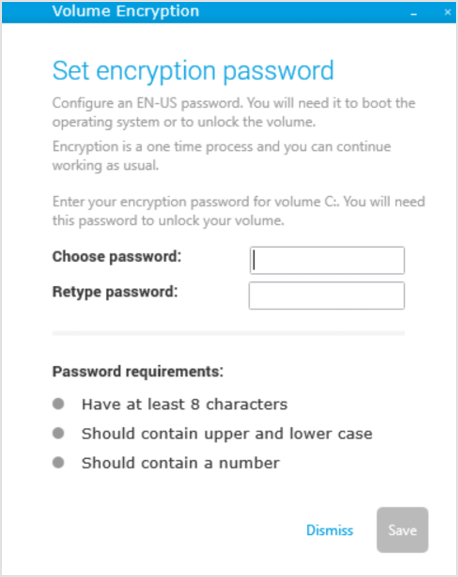

The security agent prompts the users to configure a password. For details, refer to Encryption.
After clicking the Save button, the security agent sends a recovery key associated with the encryption password to the GravityZone console.
When starting an encrypted Windows machine, the users first have to enter the encryption password in the pre-boot environment to unlock the boot volume, then the system credentials. Non-boot volumes are automatically unlocked.
In case the users have forgotten their encryption passwords, they can ask their security administrator for the recovery key to unlock the boot volume.

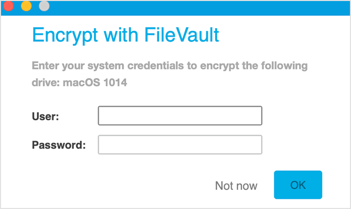

For the boot volume:
The security agent prompts the users to enter their system credentials to start encryption with FileVault.
After clicking the OK button, the security agent sends a recovery key to the GravityZone console and the encryption process starts.
If clicking the Not now option, the encryption window will disappear and reappear after a while, as long as the policy is active on the endpoint.
In case of dual-boot systems, the other boot volume will not be encrypted.

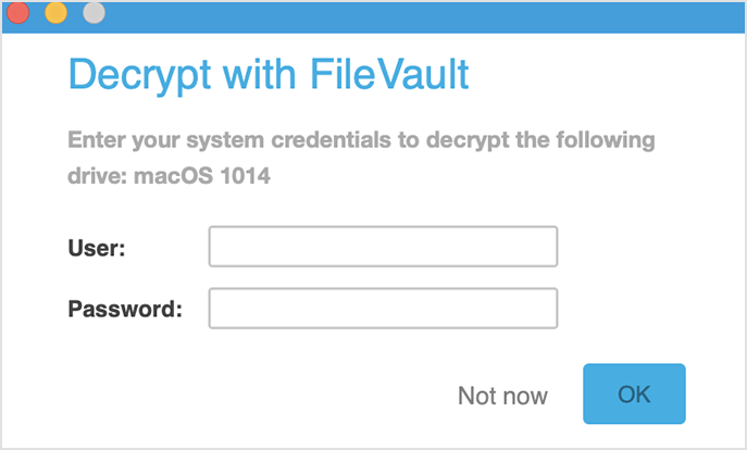

To decrypt volumes on Mac, you need to apply the Full Disk Encryption module enabled and the Decrypt option selected. When the policy is applied:
For the boot volume, the users have to enter their system credentials.

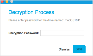

For the non-boot volumes, the users have to enter the disk password they have configured to encrypt those volumes.

On machines with TPM (such as newer laptops), the user must enter a personal identification number (PIN) as encryption password. The PIN must contain:
At least 6 characters.
Only alphanumeric characters.
Less than 21 characters.

On machines without TPM (such as virtual machines), the encryption password must contain:
At least 8 characters.
Capital and small letters.
One or more digits.
The password with this format is also required when the TPM is not functional or not detected by GravityZone.

To encrypt the boot drive with FileVault, the user must enter his system credentials.
