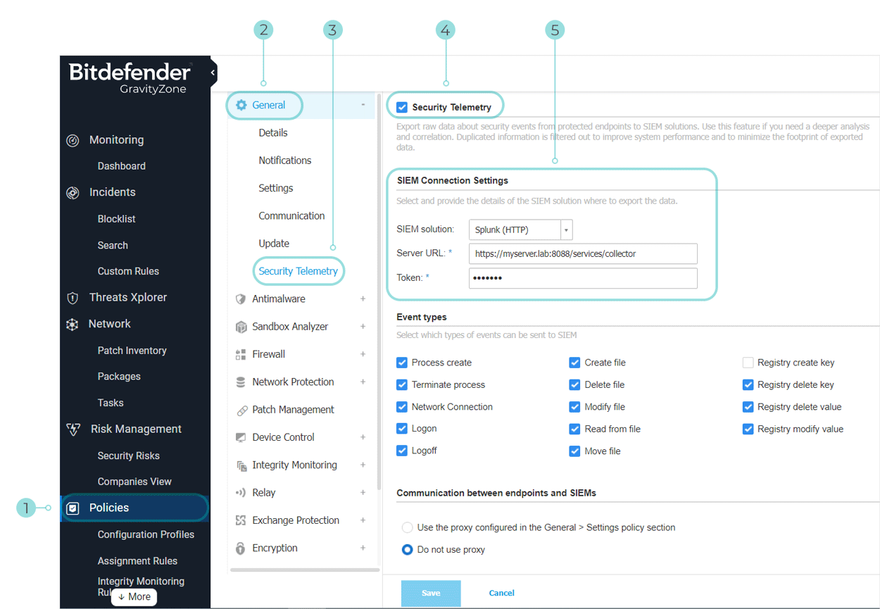

Configure GravityZone
  1. Using the token value for the new HTTP Event Collector, connect to GravityZone Control Center.
  2. Click the policy applied to the managed endpoints to edit it.
  3. Navigate to General > Security Telemetry.
  4. Select the Security Telemetry option.
  5. Under the SIEM Connection Settings section, enter the SIEM server URL and the Splunk token from the newly generated HTTP Event Collector.
    The Splunk server URL should have this format: https://:8088/services/collector
    Security Telemetry settings
  6. If using self-signed certificates, select Bypass validation of the SSL certificate on HTTP collector.
    By default, Control Center checks the server URL and validates the certificates on the server against a public CA. With self-signed certificates, Control Center will return an error and communication between Control Center and the HTTP collector will not be established unless you select this option.
    Important
    This option applies only to the communication between the HTTP collector and GravityZone console, not the endpoints.
    Control Center is responsible for policy enforcement, collector settings and event selection.
  7. Click Save.
For more information on configuring the Security Telemetry section of a policy, refer to this KB article.

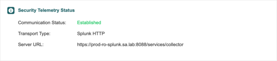

Test the configuration
To validate the configuration:
  2. Go to the Network page from the left side menu.
  3. Select an endpoint that was set to send security telemetry data.
    The endpoint details page opens.
  4. Check the Security Telemetry Status section under the Protection tab. Communication status should be Established.
    Established status
The Security Telemetry events will be forwarded from the managed endpoint where BEST is installed directly to Splunk Enterprise 8. You can review and investigate alerts by searching the raw data and aggregating different fields.
