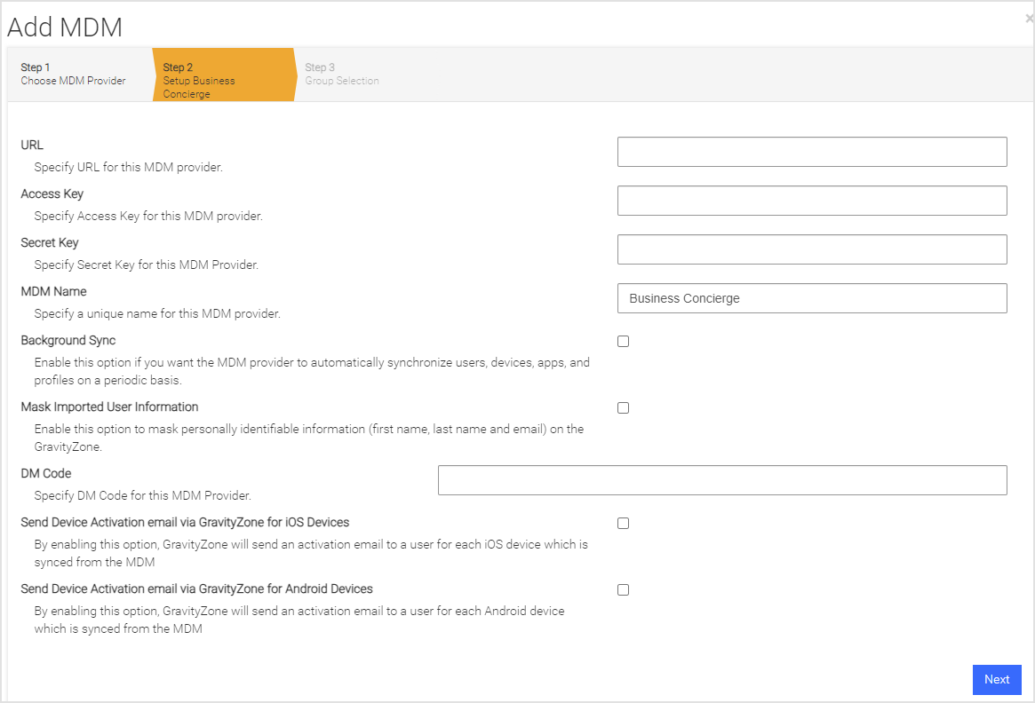

To set up the MDM integration in Mobile Security Console:
  1. Log in to Mobile Security console.
  2. Go to the Manage page.
  3. Select Integrations.
  4. Click on Add MDM and select the MDM integration you want to use.
  5. Enter information pertinent to the UEM integration list in the table, and click Next.
    Item
    Description
    URL
    This is the URL of the Business Concierge Device Management API server. Note: It is possible that this URL is not valid in a browser and can return a 404 error.
    Access Key
    This is the access key provided by the Business Concierge Device Management console.
    Secret Key
    This is the secret key provided by the Business Concierge Device Management console.
    MDM name
    The name used in Mobile Security Console to reference this MDM integration. This name is prepended to the group name to form the Mobile Security Console group name.
    Background Sync
    Check this box to ensure users/devices are synchronized.
    Mask Imported Users Information
    Check this box to mask personally identifiable information about the user when displayed, such as name or email address.
    DM Code
    This is the DM code value that is provided with your Business Concierge Device Management account.
    Send Device Activation email via Mobile Security Console for iOS Devices
    Check this box to send an email to the user for every iOS device synced with the MDM.
    Send Device Activation email via Mobile Security Console for Android Devices
    Leave this checkbox unchecked.
  6. Click Next and choose the User Group(s) to synchronize. The available groups show up in the Available Device Groups list and can be moved to the Selected Mobile Security Console Groups list by clicking on the plus sign (‘+’). This can be reversed by clicking on the minus sign (‘-’).
  7. Click Next.
  8. Specify the MDM alerts if you want to be notified when there are MDM sync errors. If you want more than one email address, separate them by a comma.
  9. Click Finish to save the configuration and start the first synchronization by clicking Sync Now.
