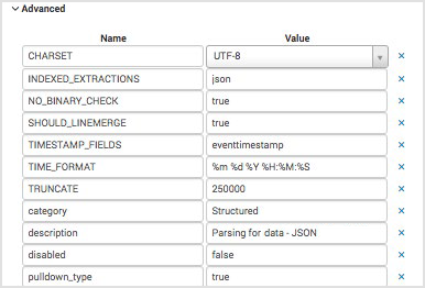

  3. Create a new structured input type called Zjson
    1. Login to Splunk through the web interface.
    2. Navigate to Settings > Source Types.
    3. Enter ‘Zjson’ for the name.
    4. Enter a description.
    5. Set the Destination app: Instrumentation.
    6. Set the Category: Structured.
    7. Set the Indexed Extractions: json
    8. Set the Timestamp Extraction: Advanced.
    9. Set the Timestamp Format: %m %d %Y %H:%M:%S.
    10. Set the Timestamp fields: eventtimestamp.
    11. Match the following values for the Advanced settings:
