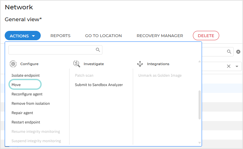

Use the Move action
To move entities using the Move action in the Network table, follow these steps:
  1. Locate the entities you want to move in the Network table.
  2. Select the corresponding checkboxes.
  3. Open the Actions menu at the top of the table and select Move.
  4. On the configuration page, select the destination for the entities.
    The path to the new location will be displayed under Destination.
    If the destination is invalid, an error message will inform you about the issue.
  5. Click Move to initiate the process.

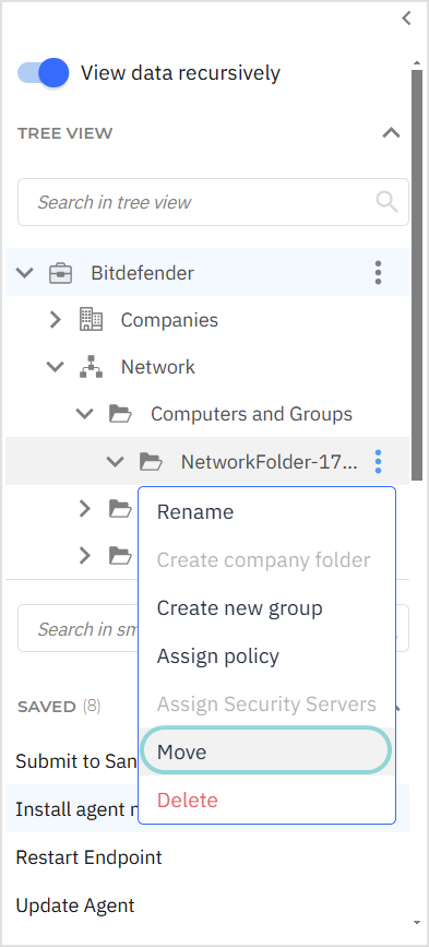

To move one entity at a time within the tree view, follow these steps:
  1. Click the moreIcon.png More icon to open the contextual menu for the entity you want to move.
  2. Select Move.
  3. On the configuration page, select the destination for the entity.
  4. Click Move to initiate the process.
In some cases, moving entities may take some time. A toast message in the lower right-corner of the page will be displayed when the process is complete.

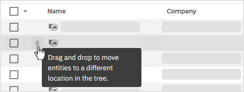

To move one entity from the Network table to a different location, follow these steps:
  1. Locate the entity in the Network table.
  2. Hover over the drag handle (network_drag_icon.png) of the entity.
  3. Drag the entity to the desired location in the tree panel.
  4. Drop the entity.
  5. Confirm the action.

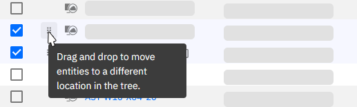

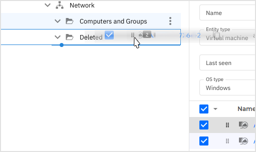

To move multiple entities at the same time, follow these steps:
  1. Select the entities in the Network table.
  2. Drag one of the selected entities to the desired location in the tree panel.
    All selected entities are moved together.
    During the action, an indicator shows how many entities are being moved.
  3. Drop the entity.
  4. Confirm the action.

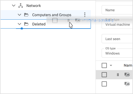

To move an entity to a different location within the tree view, follow these steps:
  1. Drag the entity from its current location in the tree.
  2. Drop it in the desired destination.
  3. Confirm the action.
