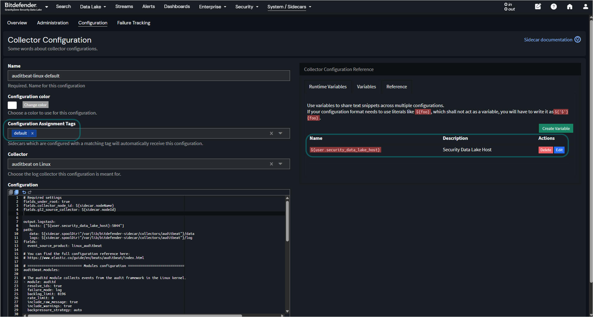

To view the collectors that will be running by default, follow these steps:
  1. Go to System > Sidecars.
  2. Select the Configuration tab.

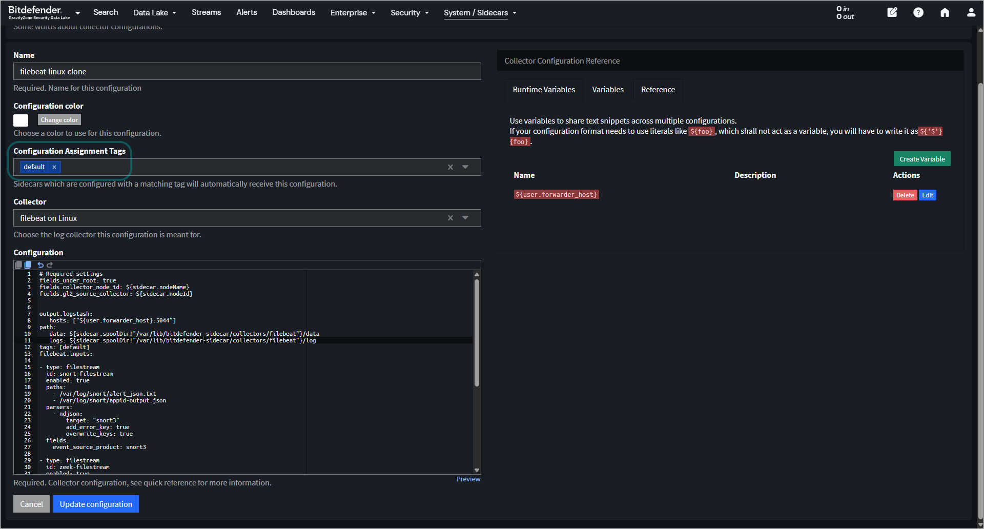

Editing default collectors
You can modify any Sidecar configuration to suit your needs. However, it is not advisable to modify the default collector configurations directly. If you need to modify a default collector configuration, click its More button and select Clone to create a copy of the configuration, which you can then use as the default. This ensures that the original configuration is preserved on the server and can be restored in case an issue arises.

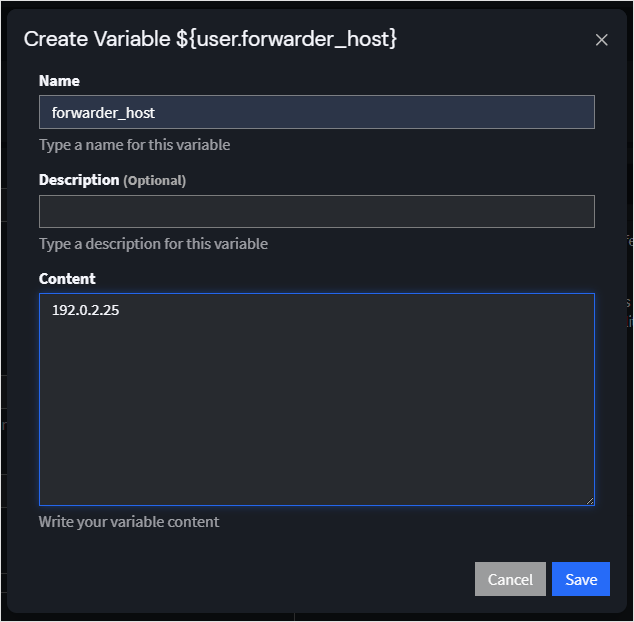

For added convenience, you can define variables, which you can reuse when creating or editing collector configurations. This eliminates the need to manually enter the same value multiple times. For more information on variables, refer to Managing sidecars (Create and edit variables section).
If you remove a configuration's default tag under Configuration Assignment Tags, the configuration will no longer be automatically applied to the Sidecar.
Collector configuration window with default tag
For added convenience, you can define variables, which you can reuse when creating or editing collector configurations. This eliminates the need to manually enter the same value multiple times. For example, you can define a ${user.forwarder_host} variable whose value is the IP address of the Forwarder deployed in your network, and then use the variable across multiple configurations.
To create a configuration variable, follow these steps:
  1. Select Edit for a configuration.
  2. Click the Variables tab in the Collector Configuration Reference section of the configuration page and select Create variable.
  3. In the dialog box, enter a Name and (optional) Description, as well as a value for the variable (such as the forwarder IP address mentioned in the example above) in the Content field.
    Collector configuration variable creation dialog box
  4. When you are done, click Save.
    You can then use the variable (for example, ${user.forwarder_host}) in other configuration files instead of manually entering the value every time.

Assigning tags
You can use tags to control how collector configurations are assigned to hosts. Tags determine which configurations each endpoint receives.
For example, you can create a configuration to collect Apache access logs and assign it the tag apache. Any Sidecar instance running on a web server with the same apache tag will automatically fetch and apply this configuration, allowing it to collect and forward web access logs to Security Data Lake.
This is the relevant section of a typical Sidecar configuration YAML file found on an endpoint:
# A list of tags to assign to this Sidecar. Collector configuration matching any of these tags will automatically be
# applied to the Sidecar.
# Example:
# tags:
# - apache-logs
# - dns-logs
Once a system tag is applied to an endpoint, it automatically begins collecting logs and forwarding them to Security Data Lake.
This feature simplifies configuration management by automatically assigning collector configurations to new clients whose YAML files include the corresponding tags.
Tags can be defined on any endpoint, such as Windows Servers, Windows Workstations, or Linux systems, and can be used across different collectors including Winlogbeat, Filebeat, Metricbeat, and NXLog.
Sidecar also supports assigning multiple collector configurations to the same endpoint. For instance, a Windows client could have configurations for both winlogbeat and sysmon tags applied simultaneously.
