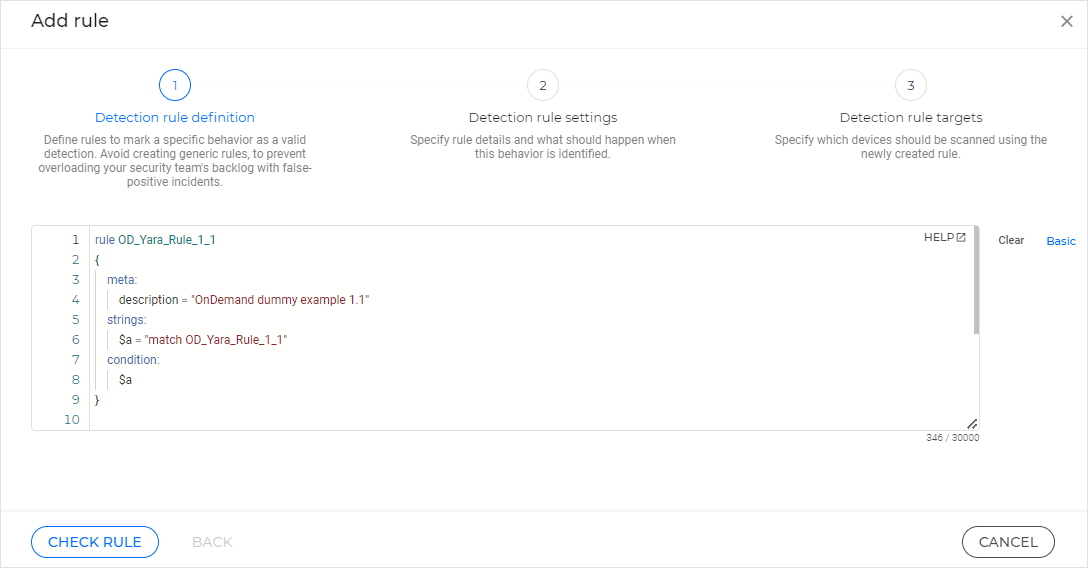

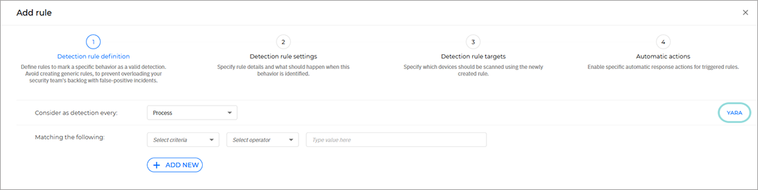

  4. At the Detection rule definition step, click the YARA button to switch to YARA rule definition.
    YARA button
  5. Type your rule query.
    Important
    • Refer to the YARA Performance Guidelines and Writing YARA rules documentation. Following these guidelines can minimize potential performance issues for the endpoints being scanned.
    • You can enter up to 30,000 characters per YARA rule.
    • Only ASCII characters are supported.
    • The YARA detection rules feature does not support the include directive, which allows external file contents to be added during rule compilation.
  6. Click Check rule.
    If there are any errors in the rule syntax, you will receive error messages or warnings. Hover over the highlighted lines to get more detailed information on what needs to be fixed.
  7. Correct any highlighted syntax errors, then click Check rule again.
  8. Once the rule is successfully validated, click Next.

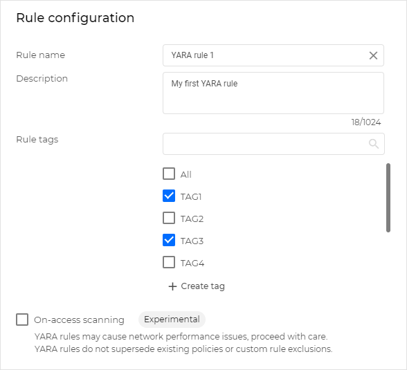

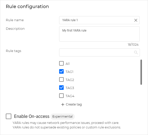

  9. At the Detection rule settings step, in the Rule configuration section, add a descriptive rule name.
  10. Optional: Type a rule description and select relevant tags for the rule.
    Important
    • If you do not have a tag that suits your rule, you can click Create tag and add one.
    • Rule tags can help you identify, group, and sort rules as needed.
  11. Optional: Enable the Enable On-access option to activate the rule immediately after creation.

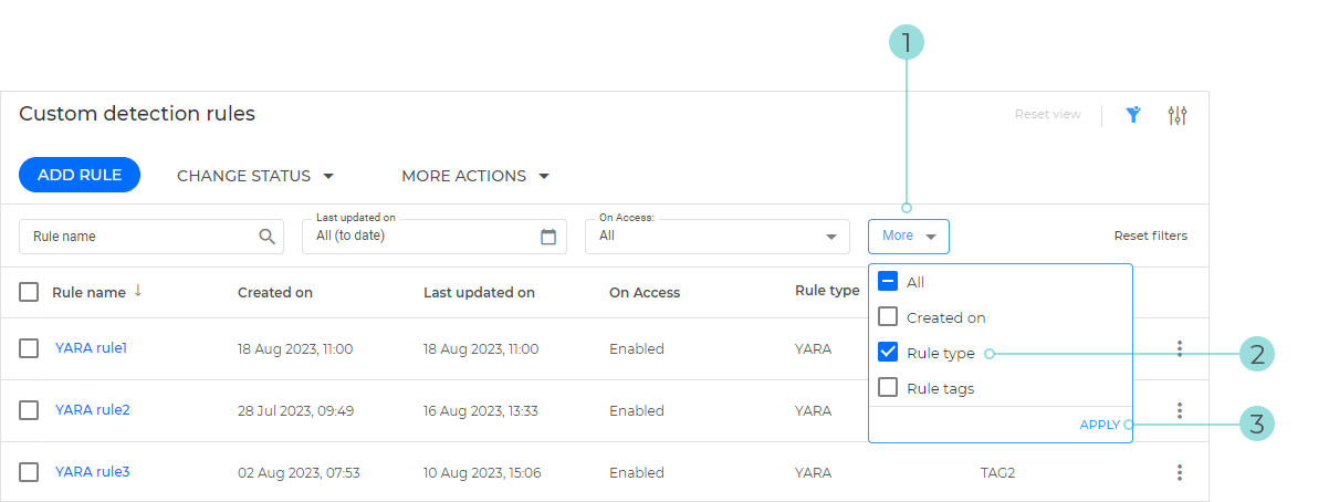

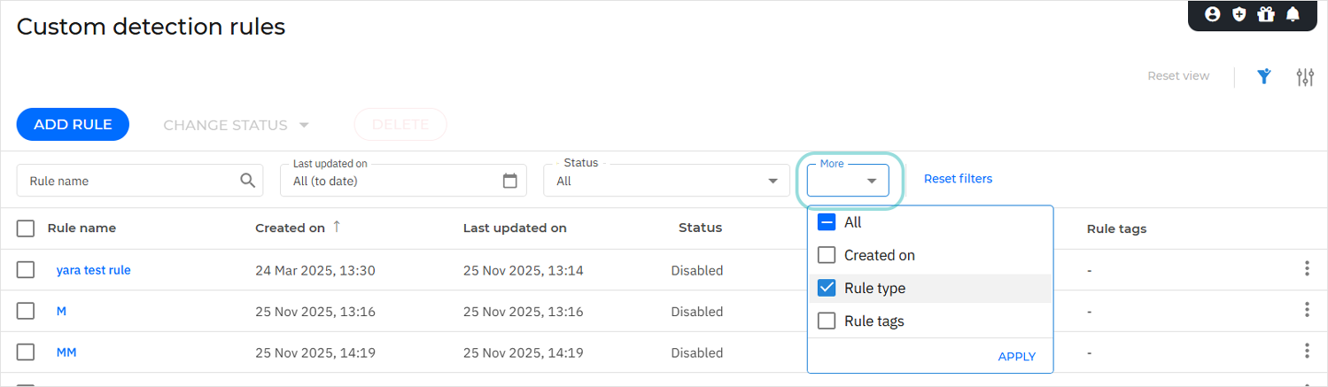

To filter the rules table to display only YARA rules, follow these steps:
  1. Click the More drop-down above the rules table.
  2. Select the Rule type checkbox.
  3. Click Apply.
    This adds the Rule type filter above the table.
  4. Click the Rule type filter.
  5. Select the YARA checkbox.
  6. Click Apply.

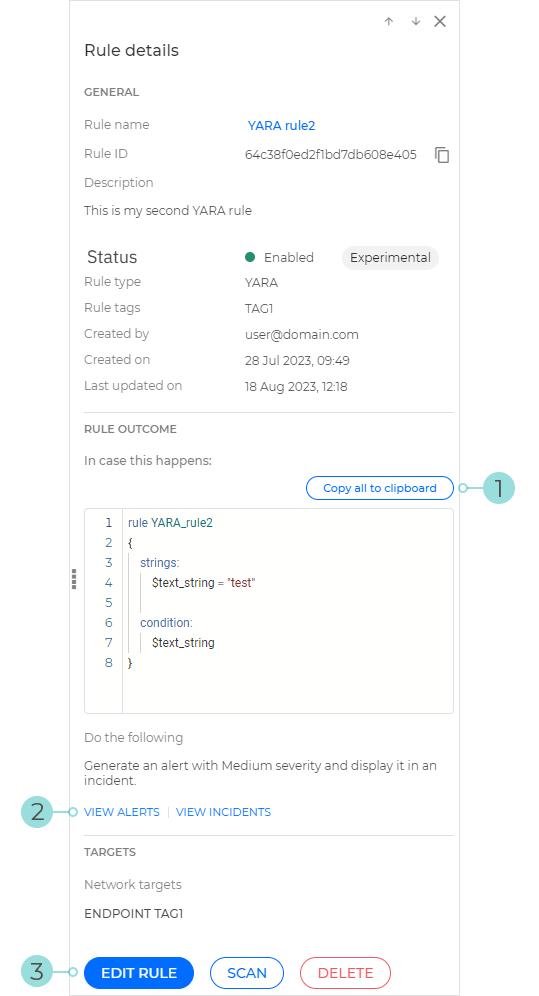

Viewing YARA rule details
Clicking one of the YARA rules in the table opens its details panel. The details panel for YARA rules contains information related to the rule name, ID, description, YARA query, and other rule details.
  1. The Copy all to clipboard button makes it easy to copy the entire YARA query to the clipboard.
  2. The View incidents and View alerts options redirect you to the Incidents and Search pages, respectively. Prefilled queries run automatically to retrieve all the alerts or incidents generated by the YARA rule.
  3. The Edit rule button brings up the rule definition window, where you can change the rule details.

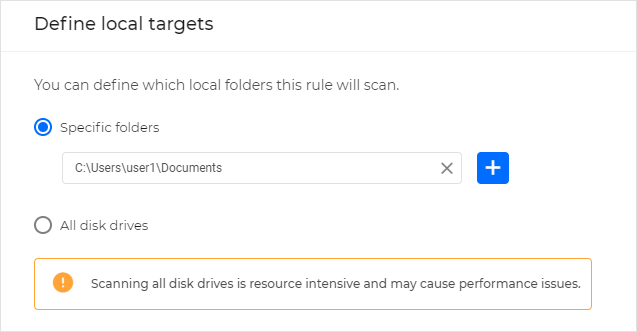

  2. In the Define local targets window, specify the folders or disk drives to scan.
    Important
    • The Specific folders field does not support wildcard characters, but it supports system variables.
    • On-demand scanning of network shares is not supported for YARA rules.
