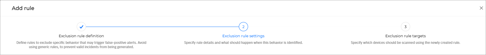

  1. In the Custom exclusion rules page, click the Add rule button.
    You will be redirected to the Add rule page.

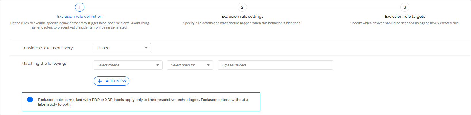

    Exclusions - Add rule page
  2. In the Exclusion rule definition section, configure the following settings:
    1. From the Exclude every field, select the type of element you want to include in the exclusion rule.

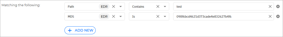

    2. Using the Matching the following settings, configure the settings that will trigger the rule:
      • In the Select criteria field, select the parameters you want for the rule. These are the elements that will be compared against the custom values you enter in the Type value here field.
        Some fields are only compatible with either XDR or EDR technology. These fields are marked with either an EDR or an XDR tag. This means that, for example, a rule that uses a parameter with an EDR tag will not apply to behavior detected through the XDR feature.
        Parameters that have no tags apply to both technologies.
        Tip
        You can use the Alert name parameter to stop certain alerts from generating incidents.
        When using this parameter, make sure that the value you enter matches the alert name displayed in GravityZone. This parameter does not support wildcards and is only compatible with the Is operator.
      • In the Select operator field, set the relationship between the selected criteria and the value you enter in the Type value here field:
        • Is - matches the exact value entered in the value field.
        • Contains - matches all values that contain the string entered in the value field (for example, file extensions).
          Important
          Use wildcards with caution when creating an exclusion rule, as it raises the risk of making it too generic. Generic rules may increase the possibility of ignoring real threats and making your company more vulnerable.
        • Is one of - matches any of the values entered in the value field (an OR operation is performed between the values). You must press Enter after each value, to complete the action.
      • In the Type value here field, enter the custom value you want to compare the criteria against.

    3. (Optional) Use the Add new button to add additional criteria to the rule.
      The rule excludes incidents only when all criteria are met (an AND operation is performed between the added criteria).

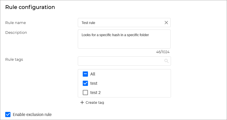

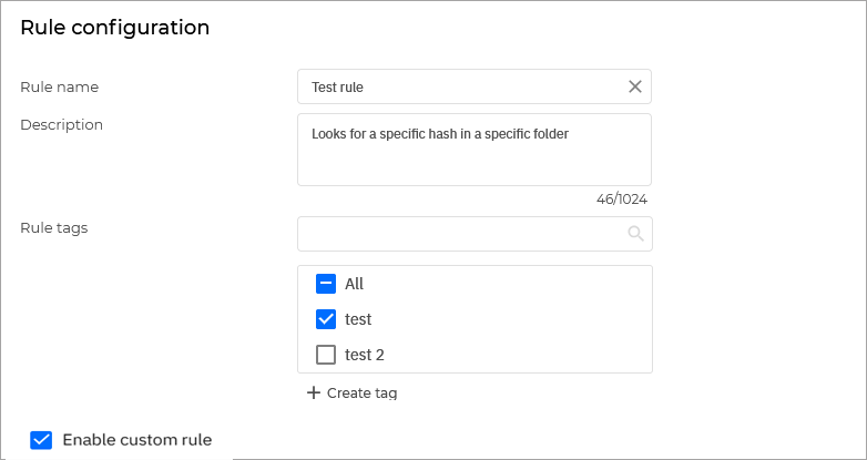

  3. Configure the settings in the Rule configuration section:
    1. Under the Rule configuration section, type in a name, description, and add tags to the rule.
      Rule tags can help you identify, group, and sort for rules as needed. If you do not have a tag that suits your rule, you can click the Create tag button, and add one.
    2. Select the Enable custom rule checkbox to activate the rule immediately after creation.

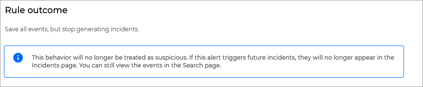

    3. Read the information from the Rule outcome section. This indicates the application and effects of the rule.
    4. Click Next.

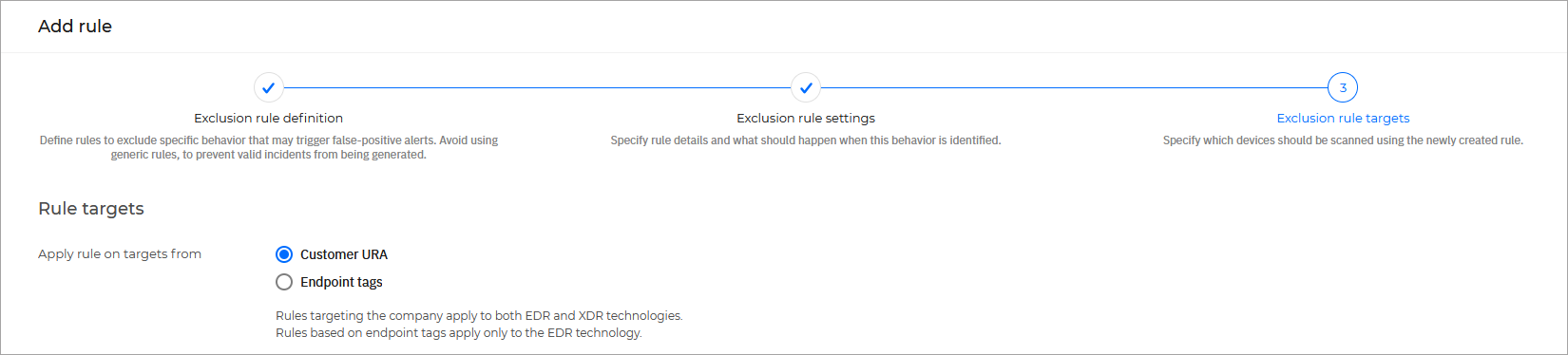

  4. Set the application of the rule in the Exclusion rule targets section:
    There are two methods of applying the rule to endpoints:
    • Apply the rule to your company directly - This method applies the rule to all the managed entities from your company.
      This option will be displayed using your company name.
      This method is compatible with all parameters.

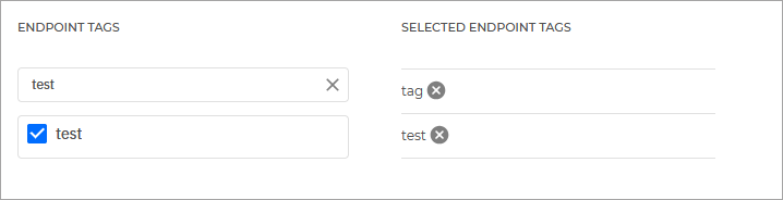

    • Endpoint tags - This method only applies the rule to endpoints that have specific tags assigned.
      Rules applied using this method apply only to behavior detected through the EDR feature. They are not compatible with XDR technology.
      Tip
      You can manage endpoint tags from the Network > Tags Management page.
      Select the checkboxes for the tags you want from the Endpoint tags list on the left side of the section. You can use the search field to look up specific tags.
      All selected tags are added to the Selected endpoint tags list on the right side of the section.
