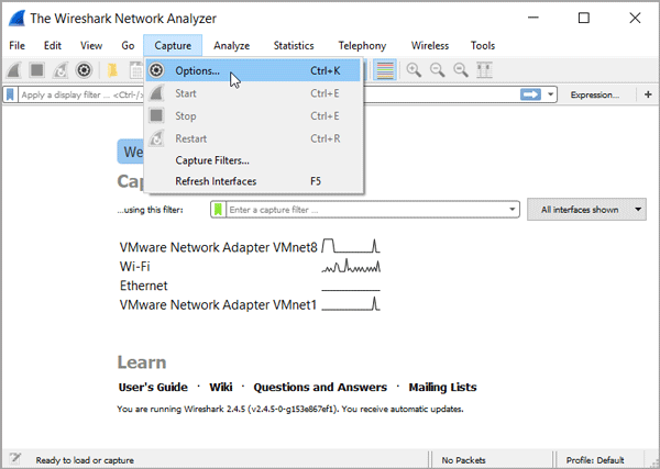

  3. Click Capture > Options…

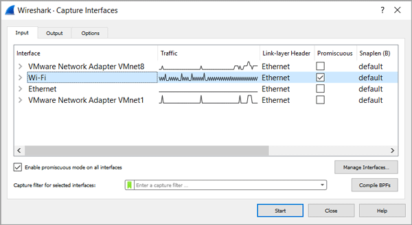

  4. Click the interface on which you need to capture packets.
  5. Click Start to start the capture.
