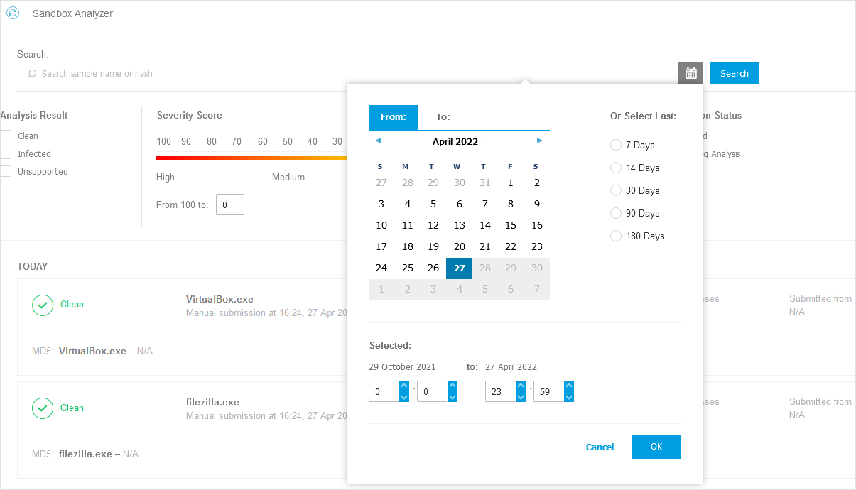

  • Date - To filter by date:
    1. Click the calendar.png calendar icon to configure the searching time frame.
    2. Click the From and To buttons to select the dates defining the time interval.
      You can also select a predetermined period from the list of options, relative to the current time (for example, the last 30 days).
      You can also specify the hour and minutes for each date of the time interval, using the options beneath the calendar.
    3. Click OK to apply the filter.
    Date and time are reported according to your local settings.

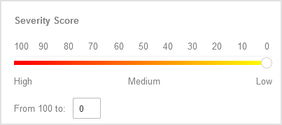

  • Severity score - The value indicates how dangerous is a sample on a scale from 100 to 0 (zero). The higher the score, the more dangerous the sample is.
    The severity score applies to all submitted samples, including those with Clean or Unsupported status.

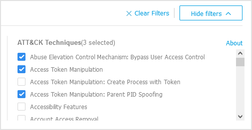

  • ATT&CK techniques. This filtering option integrates MITRE's ATT&CK knowledge base, if applicable. The ATT&CK techniques values change dynamically, based on the security events.
    Click the About link to open ATT&CK Matrix in a new tab.
