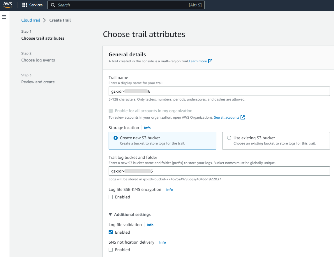

In the CloudTrail page, click the Create a trail button.
Give the trail a name.
In the Storage location section, select Create new S3 bucket.
In the Trail log bucket and folder field enter a unique bucket name.
In the Log file SSE-KMS encryption section, clear the Enabled checkbox.
Leave the rest of the fields with their default settings and click Next.

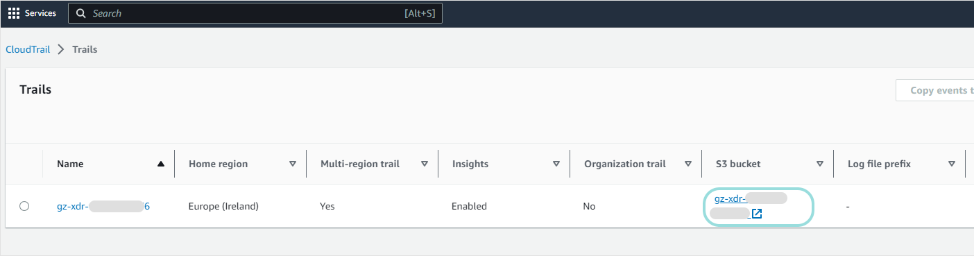

You will be redirected to the Trails grid.
Configure S3 permissions for the AWS Config service.
In the Trails grid, click the S3 bucket.

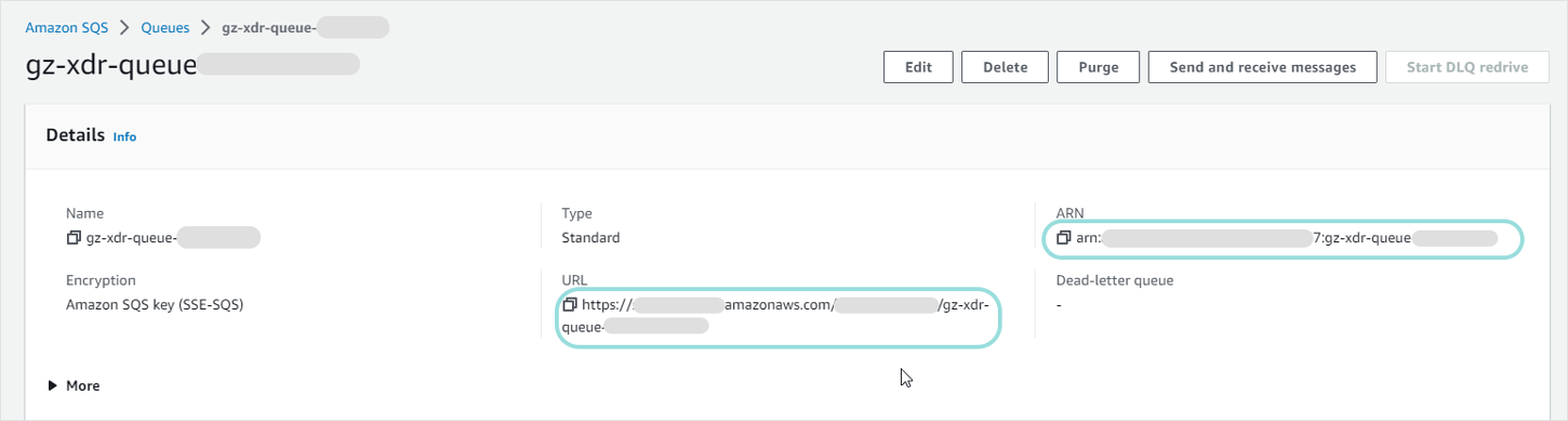

Copy the queue URL and ARN values for later use.
