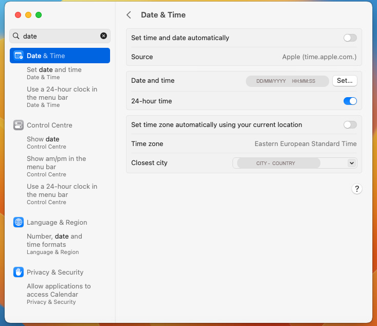

  1. The date and time must be the same as the one in Active Directory.
    Make sure the Computer is in sync with the Active Directory. Many authenticating errors appear due to time differences.

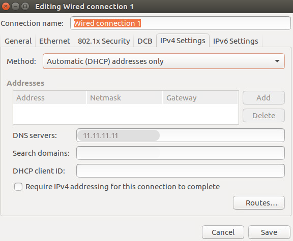

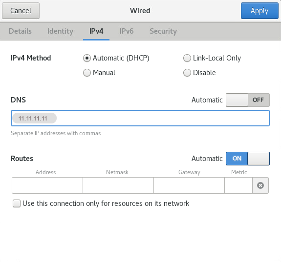

  2. The VM must use the Active Directory server as DNS.
    You can change the DNS settings from Applications > Network > Options > IPv4 Settings.
    Method: Automatic (DHCP) address only
    Automatic: OFF
    DNS servers: 11.11.11.11
    DNS: 11.11.11.11
    Alternatively you can add the following lines to /etc/resolv.conf:
    search example.local
    nameserver 11.11.11.11

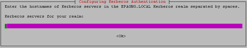

      1. Install the following packages.
        # sudo apt install samba krb5-config krb5-user winbind libpam-winbind libnss-winbind

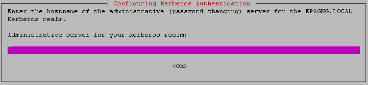

        Enter the domain name using only capital letters:
        Leave blank the Kerberos server for your realm.
        Leave blank the administrative server for your Kerberos realm.

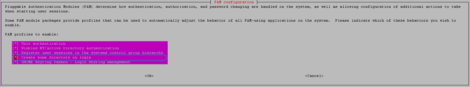

      2. Configure PAM by running the following command and enable “Create home directory on login”.
        # sudo pam-auth-update
        Important
        This command is not applicable for Debian and Ubuntu14.

        Error: KDC or realm is unreachable or can't resolve address
        This problem appears when trying to join Centos6 to Active Directory using SSSD
        "errors": [
                   "description": "failed to generate credentials cache file for keytab file: default",
                   "message": "KDC or realm is unreachable or can't resolve address"
        Resolution
        • Run the following command:
          # authconfig \
           --enablekrb5 \
           --krb5kdc=example.local \
           --krb5adminserver=example.local \
           --krb5realm=EXAMPLE.LOCAL \
           --enablesssd \
           --enablesssdauth \
           --update
        • Check krb5.conf file. It should have the following format:
          [libdefaults]
              default_realm = EXAMPLE.LOCAL
              dns_lookup_kdc = true
              forwardable = true
              default_ccache_name = FILE:/tmp/krb5cc_%{uid}
          [realms]
              EXAMPLE.LOCAL = {
                  admin_server = EXAMPLE.LOCAL
                  #kdc = dc1.EXAMPLE.LOCAL
                  #kdc = dc2.EXAMPLE.LOCAL
          [logging]
              kdc = FILE:/var/log/krb5/krb5kdc.log
              admin_server = FILE:/var/log/krb5/kadmind.log
              default = SYSLOG:NOTICE:DAEMON
          [domain_realm]
              .EXAMPLE.LOCAL = EXAMPLE.LOCAL

        Error: adcli: couldn't connect to domain: Couldn't get kerberos ticket ... Clock skew too great
        The problem appears when the endpoint has a different date & time than Active Directory.
        # adcli join example.local
        Password for Administrator@EXAMPLE.LOCAL:
        adcli: couldn't connect to example.local domain: Couldn't get kerberos ticket for: Administrator@EXAMPLE.LOCAL: Clock skew too great
        Resolution
        • Set the same time zone, date & time on the endpoint as Active Directory.

        Error: Failed to join domain: Invalid configuration ("workgroup" set to 'EXAMPLE.LOCAL', should be 'EXAMPLE') and configuration modification was not requested
        Join command fails due to the fact that authconfig was run incorrectly.
        # net ads join -U Administrator
        Enter Administrator's password:
        Resolution
        • Run the following command correctly.
        # authconfig \
         --enablekrb5 \
         --enablewinbind \
         --enablewinbindauth \
         --smbsecurity=ads \
         --smbrealm=EXAMPLE.LOCAL \
         --smbservers=example.local \
         --smbworkgroup=example\
         --winbindtemplatehomedir=/home/%U \
         --winbindtemplateshell=/bin/bash \
         --enablemkhomedir \
         --enablewinbindusedefaultdomain \
         --update

        Configuring the DNS server address
        1. Go to System Preferences > Network.
        2. Under the Ethernet section, click Advanced.
        3. Under DNS , enter the IP address of the Active Directory.
        4. Click OK to save changes.
        Back in the Network page you can see the fields completed with the data.
        Configuring the Date & Time
        • Set the Date &Time as well as the Time Zone to be the same as in Active Directory.

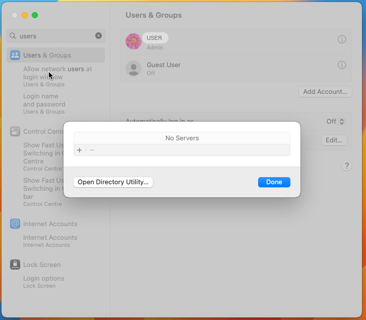

        Joining the Active Directory

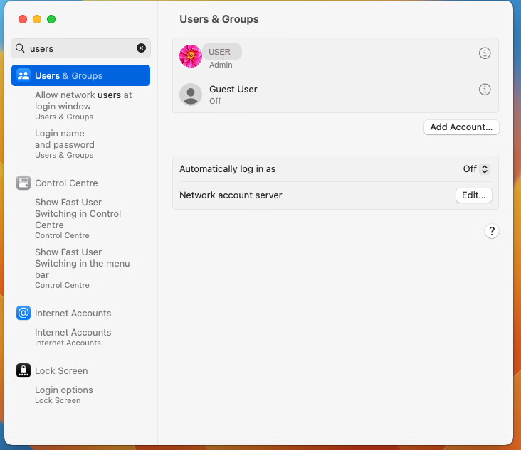

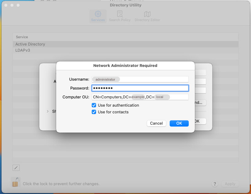

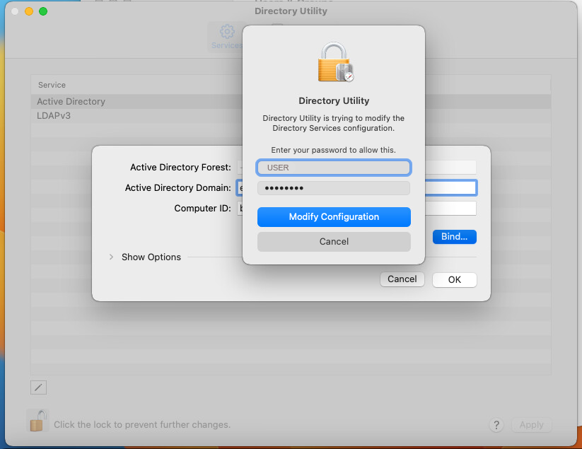

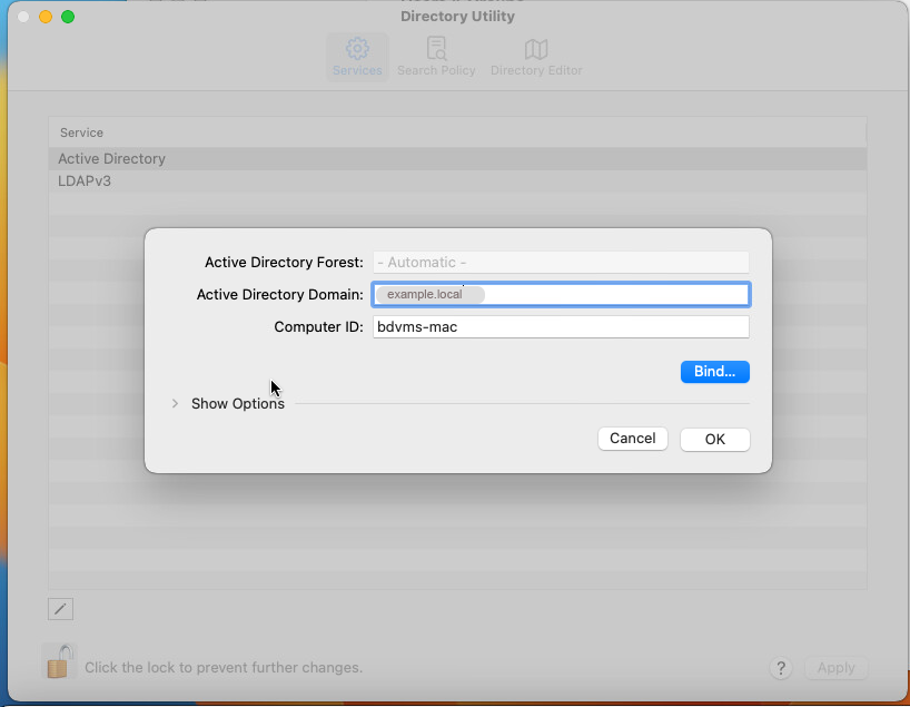

        1. Go to System Preferences > Users & Groups > Network account server.
        2. Click Edit > Open Directory Utility.

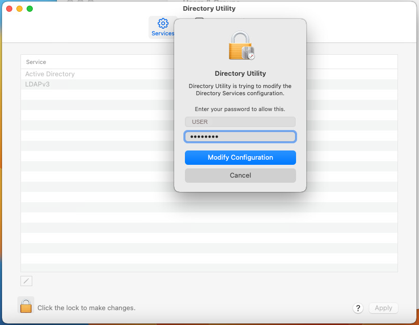

        3. In the Directory Utility enter your local Username and Password.
        4. Insert the Active Directory Domain name and click on Bind.
        5. In the Directory Utility re-enter your local Username and Password.
        6. Insert your domain Username and Password.

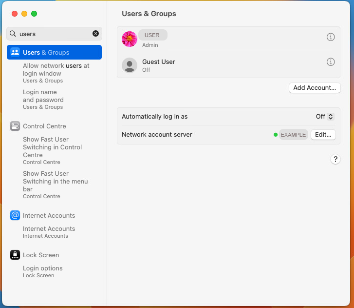

        7. Back in Users & Groups you'll be able to check if your endpoint has successfully joined the Active Directory.
        Important
        If your endpoint name contains a hyphen, you might not be able to bind to a directory domain such as LDAP or Active Directory.
        To establish binding, use a endpoint name that does not contain a hyphen.
