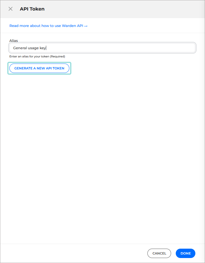

  6. Type in an Alias describing the purpose of the key so you can later identify it, and click the Generate a new API token button:

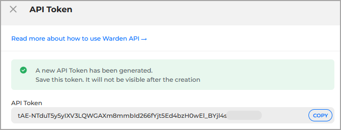

    A new API key is generated and displayed:
  7. Copy the token somewhere safe.
    Important
    Once you close this panel you will no longer be able to display the key from the Cloud Security console.
  8. Click Done.
