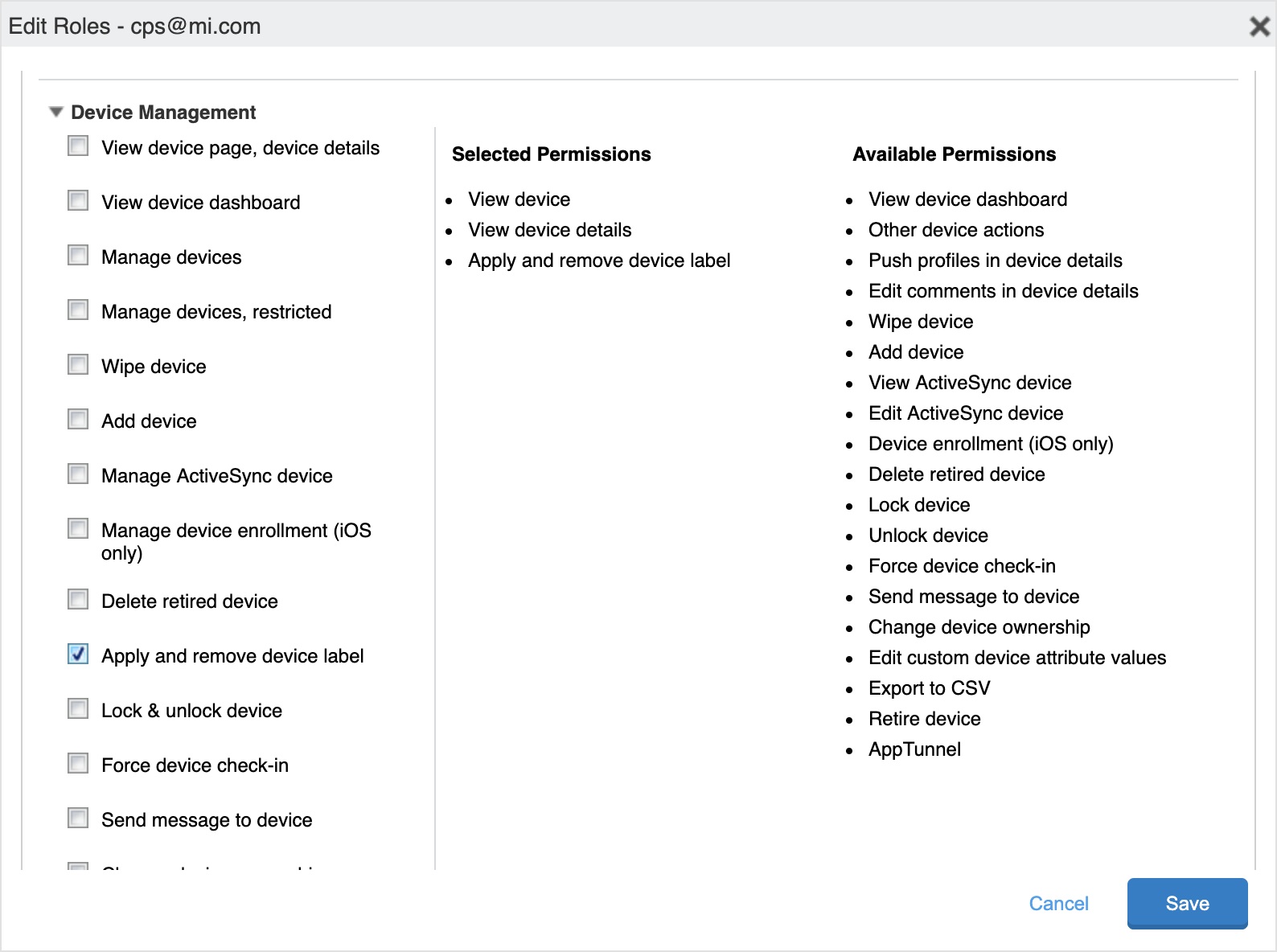

    If using MobileIron Core version 10.8 or later, then in the Device Management section, click on the checkbox for Apply and remove device label, as shown below. If using MobileIron Core prior to version 10.8, then the Apply and remove device label permission is not required.

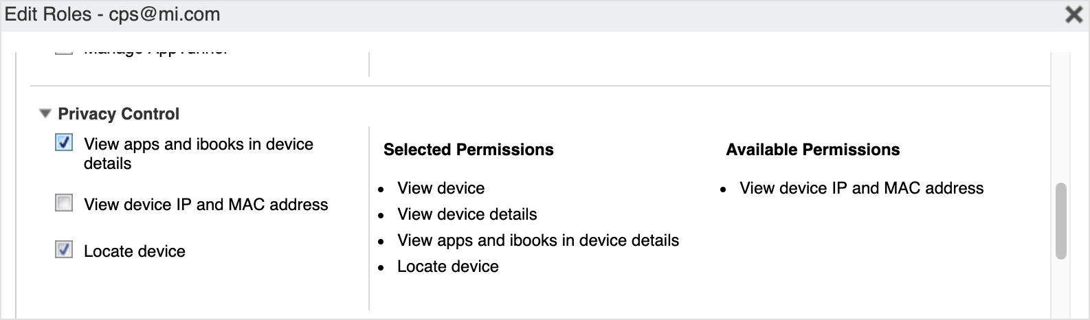

  5. Scroll down to the Privacy Control section, and click on the checkboxes for View apps and ibooks in device details and Locate device.

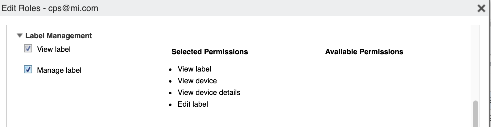

  6. Scroll down to Label Management, and click the checkboxes for View Label and for Manage Label.

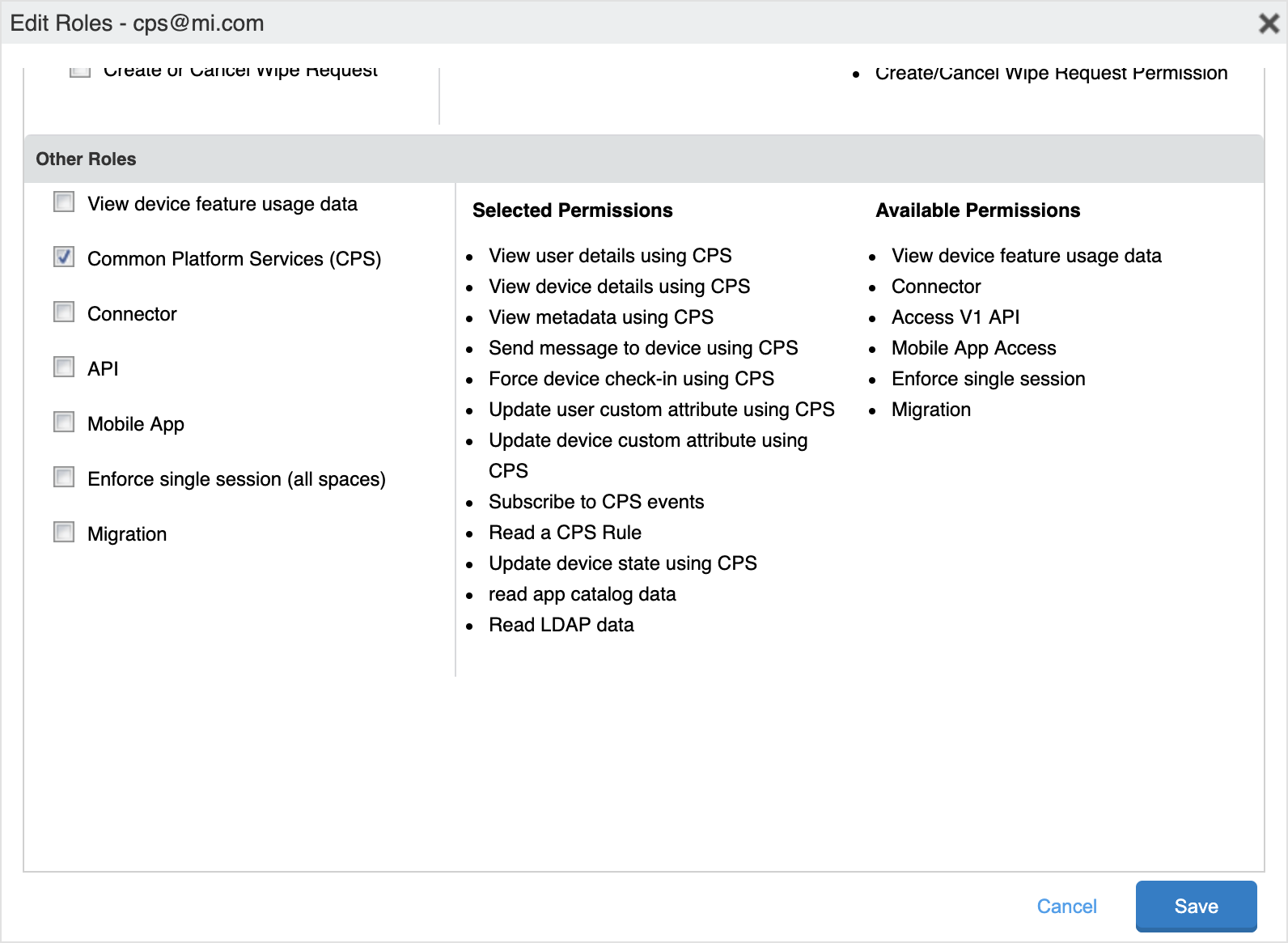

  7. Scroll all the way down to the Other Roles section.
    If using MobileIron Core version 10.8 or later, click on the checkbox for Common Platform Services (CPS). If you are using MobileIron Core prior to version 10.8, an additional permission is required. Click on the checkbox for API.
  8. Click Save.

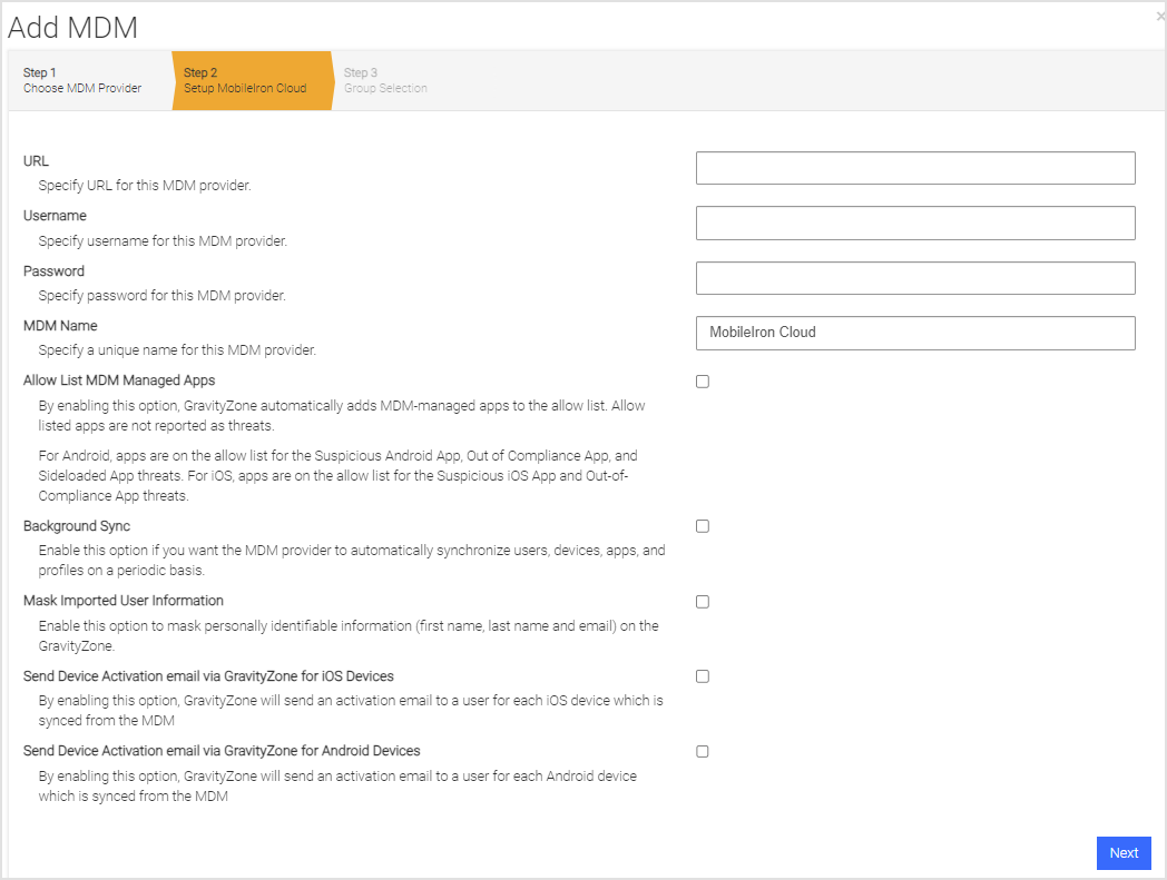

    To set up the MDM integration in Mobile Security Console:
    1. Log in to Mobile Security console.
    2. Go to the Manage page.
    3. Select Integrations.
    4. Click on Add MDM and select the MDM integration you want to use.
    5. Enter information pertinent to the UEM integration list in the table, and click Next.
      Field/Option
      Description
      URL
      URL of the MobileIron API Server.
      Username
      MobileIron Administrator created with the API role access.
      Password
      The password of the MobileIron Administrator.
      MDM Name
      The name used in Mobile Security console to reference this MDM integration. This is prepended to the group name to form the Mobile Security console group name.
      Allow List MDM Managed Apps
      When adding or editing a MobileIron MDM, users have the option to allow (whitelist) iOS and Android apps that are identified as always safe. When this option is enabled and an allowed app is opened on the user’s device, it is not checked for vulnerabilities. For Android, apps are on the allow list for the Suspicious Android App, Out of Compliance App, and Sideloaded App threats. For iOS, apps are on the allow list for the Suspicious iOS App and Out-of-Compliance App threats. Once this option is turned on in the MobileIron MDM, the next step is to add the apps to be allowed (whitelisted) on the Mobile Security console.
      Background Sync
      Check this box to ensure users/devices are synchronized with the MobileIron Labels chosen on the next page.
      Mask Imported Users Information
      Check this box to mask personally identifiable information about the user when displayed, for instance, name or email address.
      Send Device Activation email via Mobile Security console for iOS Devices
      Check this box to send an email to the user for every iOS device synced with the MDM.
      Send Device Activation email via Mobile Security console for Android Devices
      Check this box to send an email to the user for every Android device synced with the MDM.
    6. Click Next and choose the User Group(s) to synchronize. The available groups show up in the Available Device Groups list and can be moved to the Selected Mobile Security Console Groups list by clicking on the plus sign (‘+’). This can be reversed by clicking on the minus sign (‘-’).
    7. Click Next.
    8. Specify the MDM alerts if you want to be notified when there are MDM sync errors. If you want more than one email address, separate them by a comma.
    9. Click Finish to save the configuration and start the first synchronization by clicking Sync Now.

    Scroll down to the Other Roles section. If using MobileIron Core version 10.8 or later, click the checkbox for Common Platform Services (CPS). If using MobileIron Core before version 10.8, additional permission is required, and click on the checkbox for API in the Other Roles section

    5. The Admin Roles pop-up window opens. If using MobileIron Core version 10.8 or later, then in the Device Management section, click on the checkbox for Apply and remove device label, as shown below. If using MobileIron Core before version 10.8, the Apply and remove device label permission is not required.
    6. Scroll down to the Privacy Control section, and click on the checkboxes for View apps and ibooks in device details and for Locate device
    7. Scroll down to Label Management, and click on the checkboxes for View Label and for Manage Label
    8. Scroll down to the Other Roles section. If using MobileIron Core version 10.8 or later, click the checkbox for Common Platform Services (CPS). If using MobileIron Core before version 10.8, additional permission is required, and click on the checkbox for API in the Other Roles section
    9. Click on the blue Save button at the bottom of the pop-up window.

    Configuring within the Mobile Security console
    1. Log in to the Mobile Security console.
    2. Navigate to the Manage page and the Integrations tab, and add the MobileIron Core MDM.

    1. Log in to the Mobile Security Console.
    2. Navigate to the Manage page and the Integrations tab, and add the MobileIron Cloud MDM.
