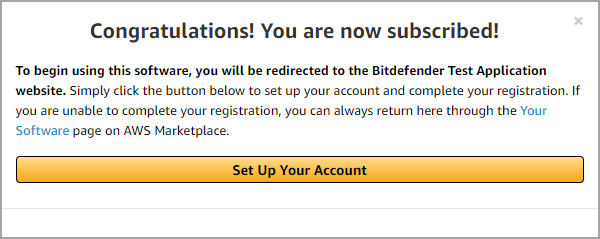

  4. After reading the subscription details, click the Subscribe button. A confirmation message will appear.
    At this point, you are subscribed to Security for AWS. You will be prompted next to set up your Bitdefender GravityZone account.

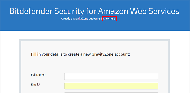

  5. Click Set Up Your Account to proceed. You will be redirected to a subscription form hosted on Bitdefender website. From this point forward, follow the steps according to your Bitdefender customer status:

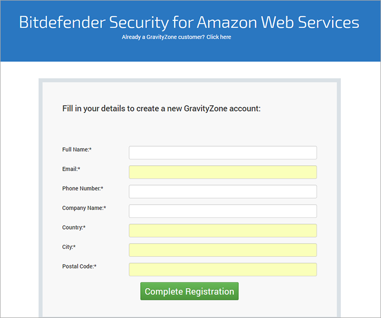

    1. As new customer:
      1. Fill in the required information.
      2. Click Complete Registration to finish.
        If the provided details are valid, a customer company and a user account will be created for you in GravityZone Control Center. You will receive an email confirmation for your subscription to the service on Amazon Marketplace. You will also receive a GravityZone new account confirmation email, with your login details. At this moment, you can access GravityZone Control Center using the link provided in the email.

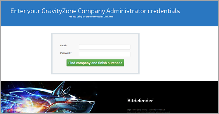

    2. As existing customer, you only need to provide your GravityZone Control Center credentials:
      1. Click the link provided under the form's title.
      2. Enter your GravityZone credentials.
        You must provide the credentials of a company administrator account.
      3. Click Confirm Subscription. If the login credentials are valid, a confirmation message will appear. Access GravityZone Control Center and log in to your account.
