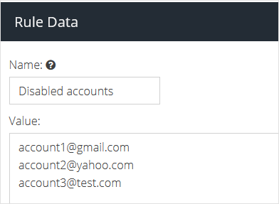

  1. Go to Products > Email Security > Custom Rule Data
  2. Click the Add New button and select Rule Data. Give it a descriptive name (e.g. No Spam filtering) and click Update.
  3. Add the domains you want to be allowed to connect, each on a separate line:

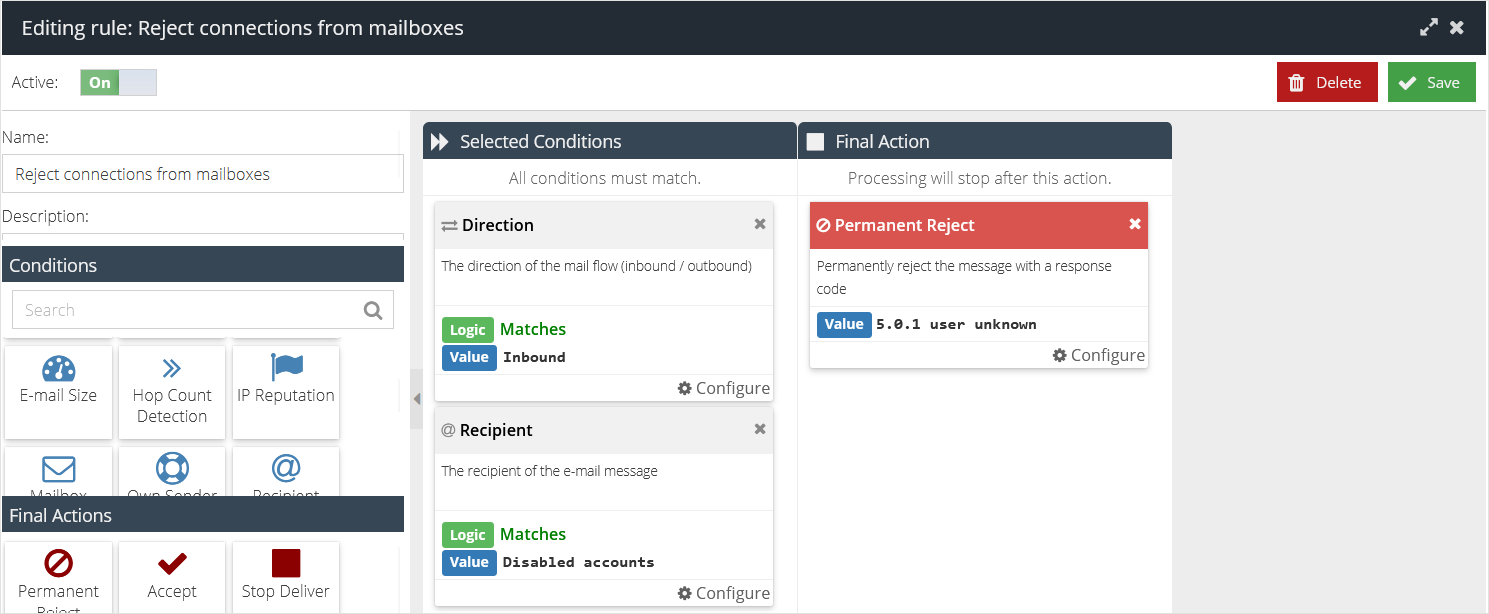

  4. Go to Products > Email Security > Connection rules.
  5. Click the Add Rule emailsecadd.png button.
  6. Add a descriptive rule name and click the Add emailsecadd2.png button.
  7. Add a Direction condition, and set it to Matches: Inbound.
  8. Add a Sender condition, and set it to Does not Match:Allowed Domains (or whatever you named the rule data in step 2).
  9. Add a Sender IP Geo-location condition, set it to Matches: and select one or more countries you want to restrict.
  10. Add a Permanent Reject Final Action, and set it to Value: 5.7.1 geoip restriction.
  11. Click the Save emailsecsave.png button.
  12. Decide the priority of the rule in relation the other existing rules and drag it to the appropriate position in the Connection Rules window.
