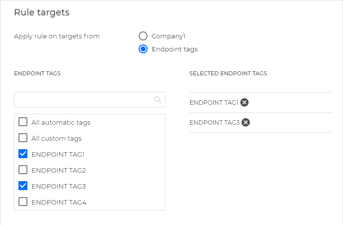

  14. At the Detection rule targets step, in the Rule targets section, select which endpoints the rule will scan.
    1. Select the entire company or specific endpoint tags.
    2. If you select the Endpoint tags option, select the tags from the list in the left-side menu.
      Your current selection will be displayed in the right-side menu.
      • The rule will apply only to the endpoints that have the selected tags applied.
      • These tags are created and managed in Network > Tags management.

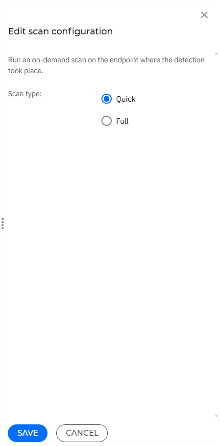

  18. If you selected Antimalware scan in the previous step, you can click Edit settings next to the Antimalware scan action.
    The Edit scan configuration side panel will then open.
    1. If you want to initiate an on-demand scan on the affected endpoint, select either a Quick or Full scan.
    2. Click Save.
