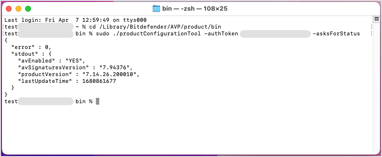

- Change the working directory by using the following command: - cd /Library/Bitdefender/AVP/product/bin/
- Run supported commands with administrator privileges (command - sudo).- The command format is - sudo ./productConfigurationTool -authToken password command - For details on the - authTokenparameter, the required password and supported commands, refer to the sections below in this article.

asksForStatus
Retrieves information about:
- Antimalware module status (enabled or disabled).
- Antimalware signatures version.
- Product version.
- The time of the last update.
How to use it:
sudo ./productConfigurationTool	-authToken password -asksForStatusExample of output in case of success:
					"error" : 0,
					"stdout" : {
					"avEnabled" : "YES",
					"avSignaturesVersion" : "69440",
					"productVersion" : "4.0.0.175873",
					"lastUpdateTime" : 1507185205
					}Example of output in case of fail:
"error" : 100
