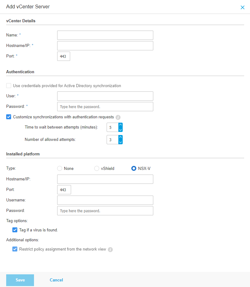

  1. In Control Center, navigate to Configuration > Virtualization Providers > Management Platforms.
  2. Click the add.png Add button at the upper side of the table. A configuration window will appear.
  3. Specify the NSX-V integration details:
    • Add the vCenter details.
    • Add Installed platform details, selecting NSX-V:
      1. The hostname or the IP address of the associated vCenter Server system.
      2. The NSX-V port. The default value is 433.
      3. The username.
      4. The password.
  4. Click Save.
  5. After the integration is added, you must register by pressing the sva_op_register_button.png Register button.

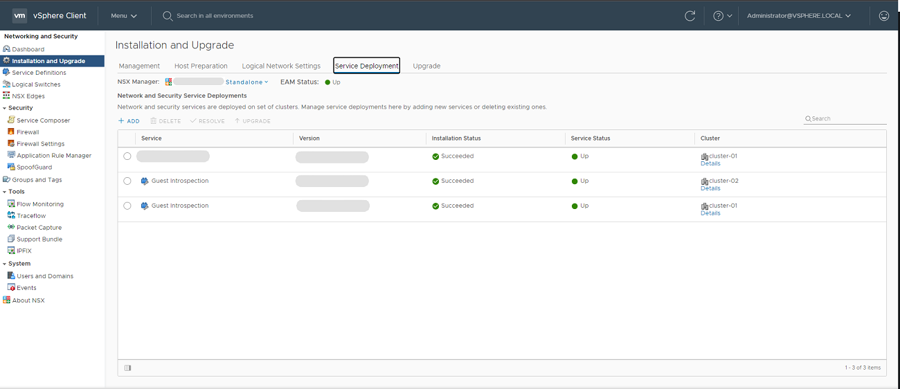

  1. In vCenter, go to the MenuNetworking and Security.
  2. Go to Installation and Upgrade > Service Deployment.
  3. Deploy Guest Introspection, using the plus button on the cluster that should be protected by the Bitdefender Security Server.
  4. Wait until Guest introspection has displays the Succeded installation status and the service status is Up.
  5. Select the Bitdefender service.
  6. Click Deploy.

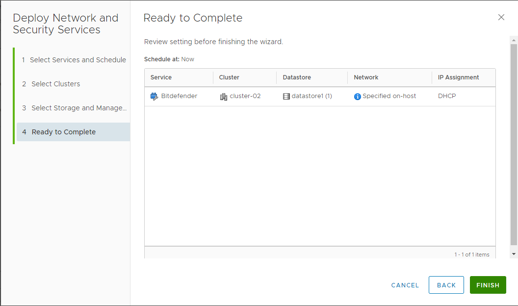

  7. Specify the service deployment details:
    • In the Cluster field, select the cluster where the service needs to be deployed.
    • In the Data Store field, you can select a data store where the Security Server disk can be stored.
      For more information, refer to the official VMware Documentation.
    • Under the Network column, you must configure the Management Network interface and the Assignation Mode.
  8. Click Finish.

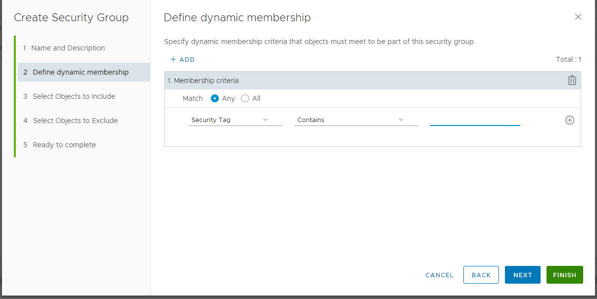

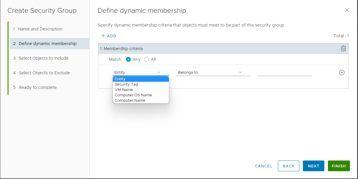

Protected VM Group
Create a group for protected VMs by following these steps:

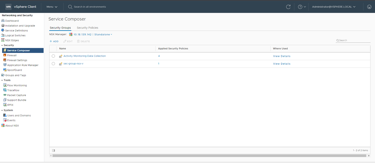

  1. In vCenter, go to the Networking and Security page.
  2. Click Service Composer.
  3. In the Security Group section, click Add.
  4. Specify the group details:
    Enter the security group name and description. Under Compute Members, click Set Members to define membership of the group:
    1. Go to the Membership Criteria tab and click Add criteria.
    2. In the third column, click Contains.
    3. In the Scope field, enter the following tag:
      ANTI_VIRUS
    4. Click Apply.

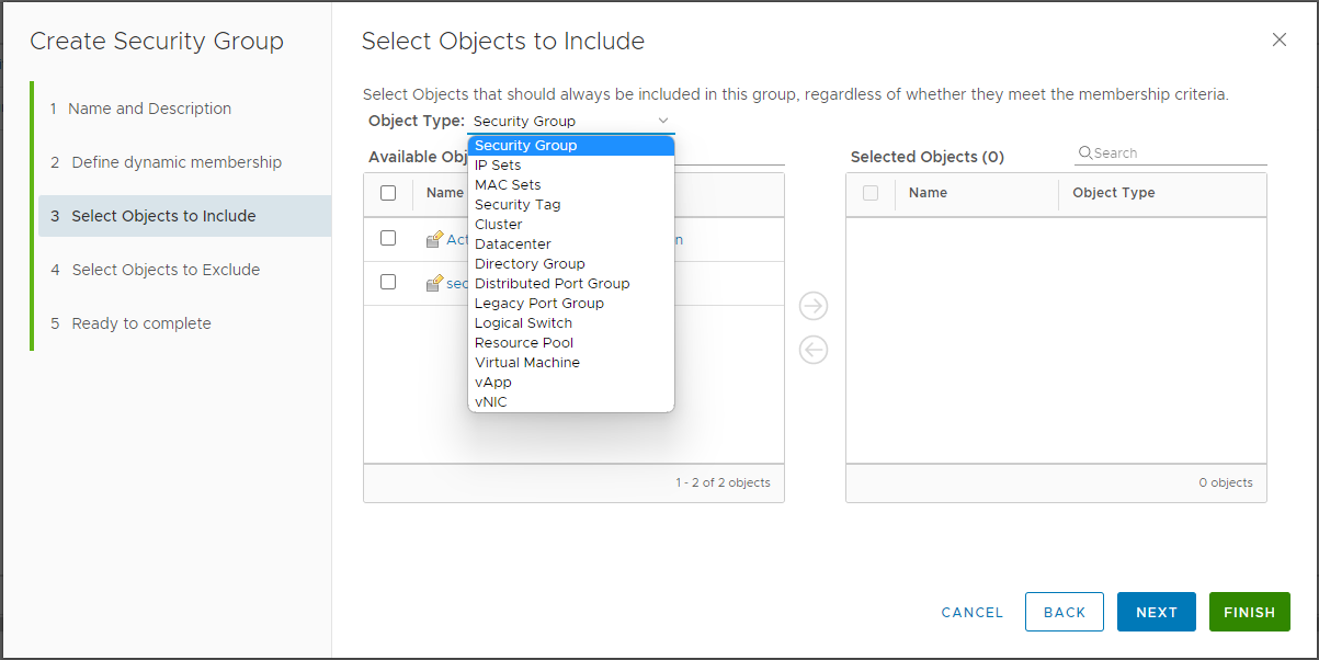

  5. Define a dynamic membership using available criteria.
  6. Include objects from Object type dropdown list.
    Users can also exclude objects in this page.
  7. Click Finish.
    The group for the protected VMs is now added.

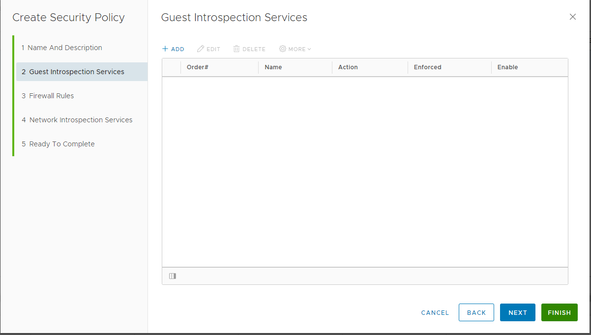

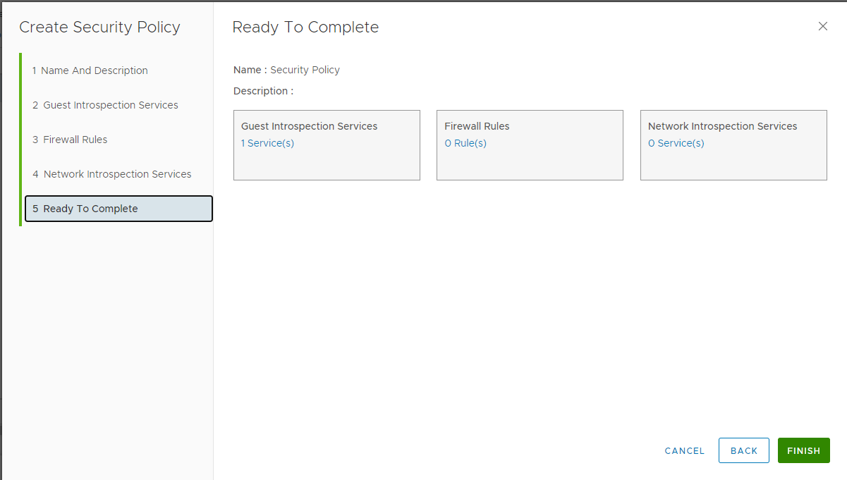

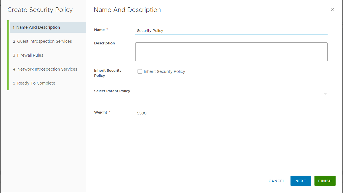

  3. In the Security Policies section, click Add.
  4. Add your security policy name.

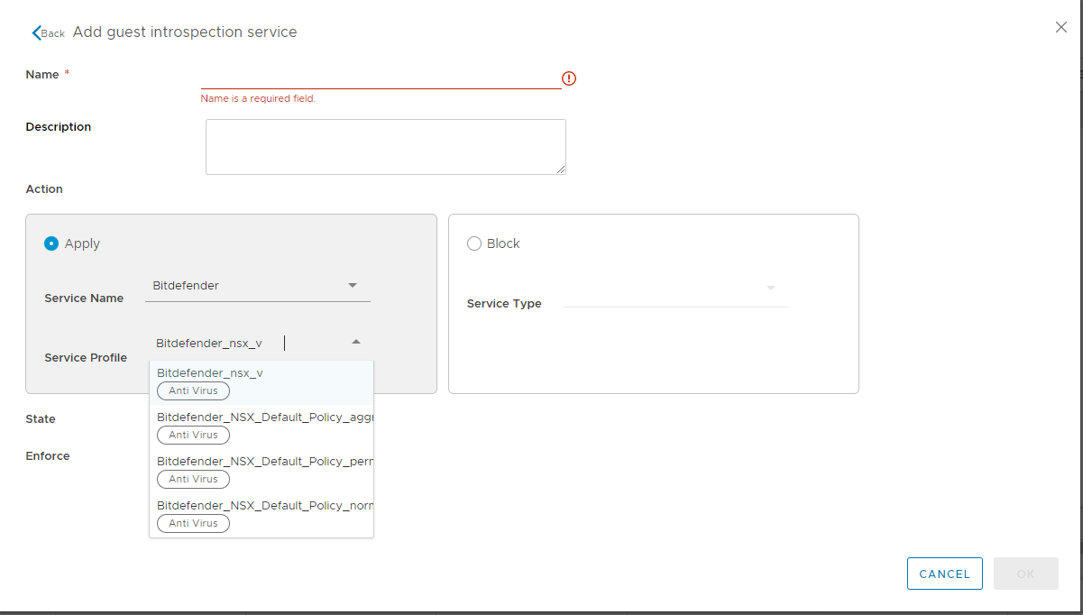

  5. In the Guest Introspection Services page, click Add.
  6. Specify the guest introspective service name.
  7. Select the Bitdefender as the service name.
  8. Select the service profile associated with the GravityZone policy settings.
  9. On the Ready to Complete page, click Finish.
    The service profile is now added.

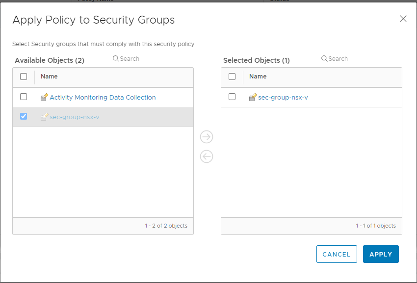

Apply the security policy to security groups
To associate a security group that needs to be protected by a specific service profile, you need to apply the security policy to that group or groups.
You can apply the policy by following these steps:
  3. In Security Policies, select your policy.
  4. Click Apply.
  5. Select and include your security group or groups.
  6. Click Apply.
