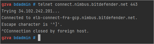

To check the connectivity, follow these steps:
  1. Open a SSH connection from your GravityZone appliance.
  2. Log in with the username: bdadmin and the password that you have set.
  3. Type the commands below to install telnet and check the connectivity:
    sudo apt install telnet
    telnet connect.nimbus.bitdefender.net 443
    If the connection is successful, the result will be similar to:
