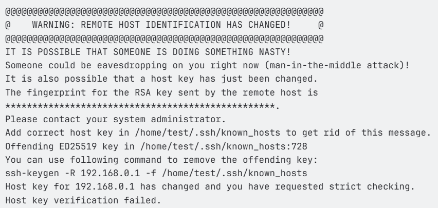

  • A warning similar to the following may be displayed after enabling or disabling SSH/SCP inspection, when reconnecting to a server whose host key had previously been accepted:
    It can occur because enabling or disabling SSH/SCP inspection changes the SSH connection path, causing the SSH client to detect a different host key than the one previously stored in the known_hosts file.
    To resolve this warning, remove the existing known_hosts entry for the destination server.
    For example:
    ssh-keygen -R 192.168.0.1 -f /home/test/.ssh/known_hosts
    When you retry the connection, you will be prompted to verify and accept the new host key.
