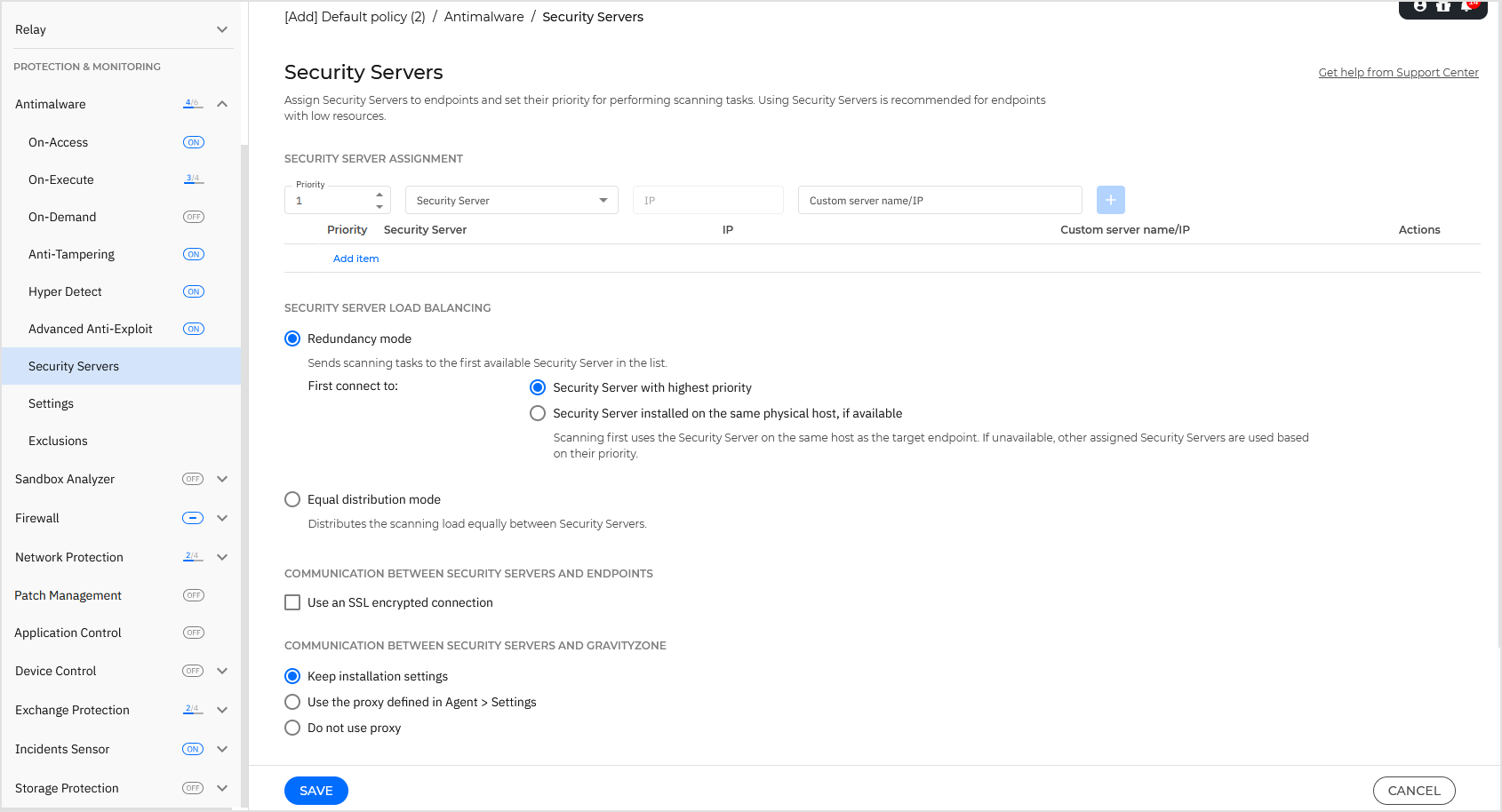

Security Servers
In the Antimalware > Security Servers section of the policy, you can assign Security Servers to endpoints in your environment, to streamline the distribution of scanning tasks, and customize Security Server specific settings.

To assign a Security Server to the target endpoints:
Under the Security Server assignment section, set the priority of the new Security Server.
Click the Security Server drop-down list and then select a Security Server.
If the Security Server is in DMZ or behind a NAT server, enter the FQDN or IP of the NAT server in the Custom server name/IP field.
Important
Make sure that port forwarding is correctly configured on the NAT server so that the traffic from endpoints can reach the Security Server. For details, refer to GravityZone (on-premises) communication ports
Click the
Add button.
The Security Server is added to the list.
Repeat the previous steps to add other Security Servers, if available or needed.
To change the priority of the Security Server assignments, drag and drop the entries in the table in the preferred order.
When assigning more Security Servers, the one on top of the list has the highest priority and will be selected first.
If this Security Server is unavailable or overloaded, the next Security Server is selected.
Scan traffic is redirected to the first Security Server that is available and has a convenient load.
To return to the default order of the Security Server instances, click Reset priority.

Security Server load balancing
You can customize how scanning tasks are being distributed among available Security Servers by choosing one of these Security Server operating modes:
Redundancy mode - Select one of these options:
Security Server with highest priority - Select this option for the scanning tasks to be sent to the first Security Server in the list.
Security Server installed on the same physical host, if available - Select this option for the scanning tasks to use the Security Server on the same host as the target endpoint. If unavailable, other assigned Security Servers are used based on priority.
Important
This option works only with Security Server Multi-Platform and only if GravityZone is integrated with the virtualized environment.
Equal distribution mode - Select this mode to distribute the scanning load equally between Security Server instances.
Communication between the Security Server and the endpoint
Enable the Use an SSL encrypted connection option if you want to encrypt the connection between the target endpoints and the specified Security Server appliances.
By default, GravityZone uses self-signed security certificates. You can change them with your own certificates in the Configuration > Certificates page of Control Center.
Communication between the Security Server and GravityZone
Choose one of the available options to define your proxy preferences for the communication between the selected Security Server machines and GravityZone:
Keep installation settings - to use the same proxy settings defined with the installation package.
Use proxy defined in the Agent > Settings - to use the proxy settings defined in the current policy, under Agent > Settings section.
Do not use proxy - when the target endpoints do not communicate with the specific Bitdefender components via proxy.
