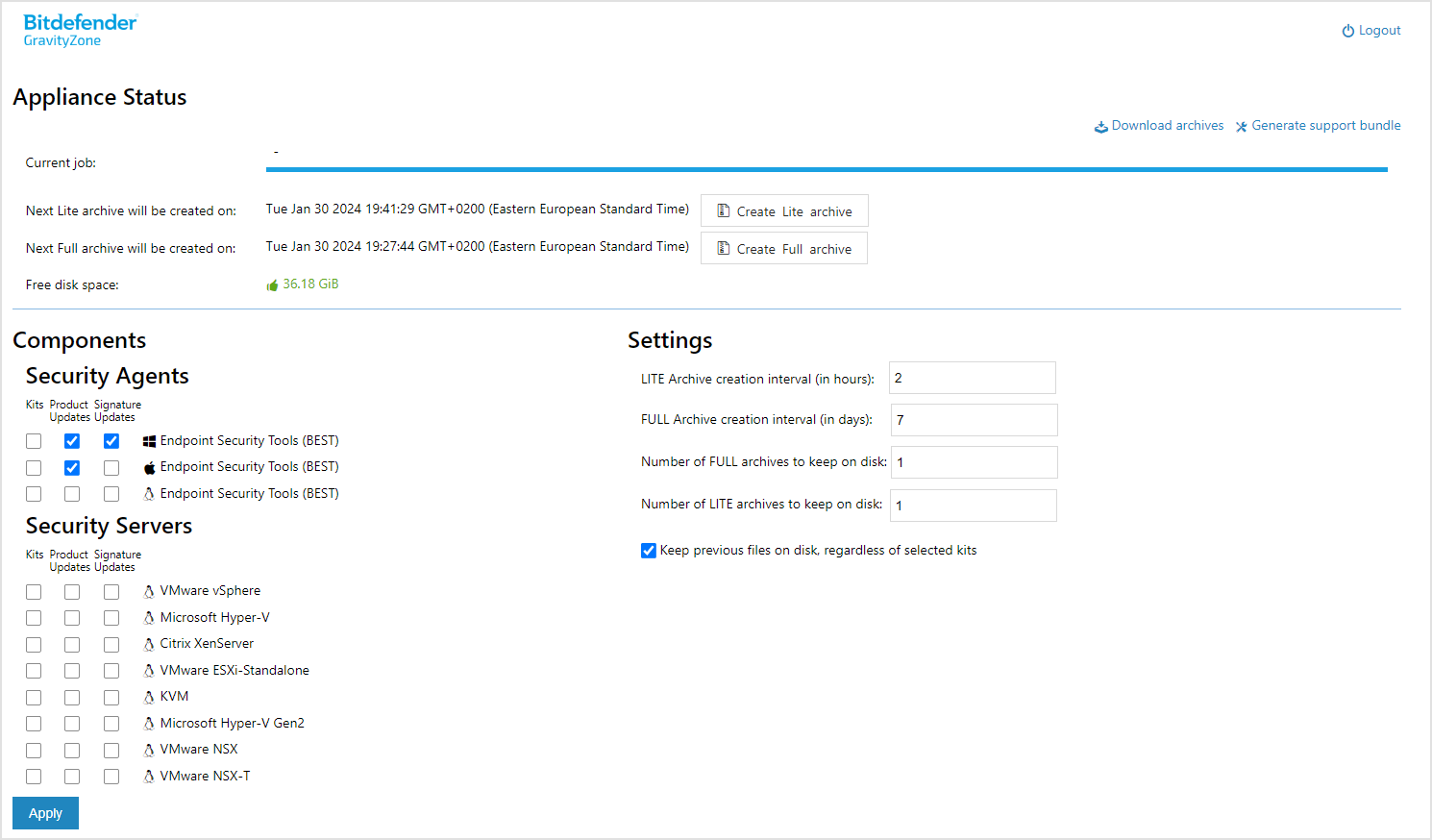

  1. Access the web service through a URL of this form: https://Online-Instance-Update-Server-IP-or-Hostname, with the username bdadmin and the password you have set.
  2. Configure the offline update archive as follows:
    • Under Components > Security Agents select the security agent kits, product updates, and signature updates you want to include in the offline update archive.
    • Under Components > Security Servers select the Security Server kits, product updates, and signature updates you want to include in the offline update archive.
    • Under Settings, edit your update archive preferences.
      A CRON job installed on the online instance will check every day for available updates (kits, product updates, signature updates). A second CRON job will check every minute if new lite or full archives should be created based on the selected time interval and if there is enough free disk space available.
      You can use the Full Archive creation interval (in days) and Lite Archive creation interval (in hours) options to set time intervals at which the CRON job will create the following archives:
      • Full archive (selected product updates + signature updates + install kits + Debian repositories)
      • Lite archive (selected signature updates)
      To maintain previously downloaded installation kits on disk, regardless of your current kit selection use the option Keep previous files on disk, regardless of selected kits.

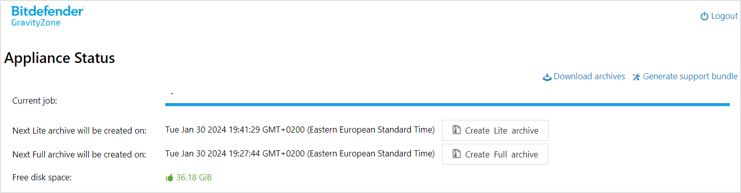

  3. Click Create > Full archive to create the first full archive. Wait until the archive is created.
    All archives are created in the following location:
    https://Online-Instance-Update-Server-IP-or-Hostname/snapshots

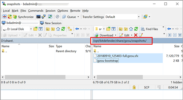

  4. Download the full update archive and the gzou-bootstrap file from the online instance. The gzou-bootstrap file is only required during the initial setup of the offline GravityZone instance. For future updates, you only need the update archive (Full or Lite).
    You have several options at hand:
    • Via the web service: click Download archives to access the page containing the links to the update files. Click the full update archive and the gzou-bootstrap file links to download them on your endpoint.
    • Use your preferred SCP/SCTP client (WinSCP, for example) to establish an SCP session with the online instance and transfer the above-mentioned files to any location in your online network. The default path on the online instance is:
      /opt/bitdefender/share/gzou/snapshots
    • Via SAMBA share. Use a read-only SAMBA share to retrieve the offline update archives from the following location:
      \\Online-Instance-Update-Server-IP-or-Hostname\gzou-snapshots
      The credentials for accessing the SAMBA share, if requested, are the same as the online instance credentials (bdadmin user and password).

  3. Transfer the update archive and the gzou-bootstrap file downloaded from the online instance to the /home/bdadmin directory of the offline instance using a portable media device (USB stick).
    Important
    For the offline update to work, make sure that:
    • The update archive and the gzou-bootstrap file are in the same folder.
    • The update archive is a full archive.

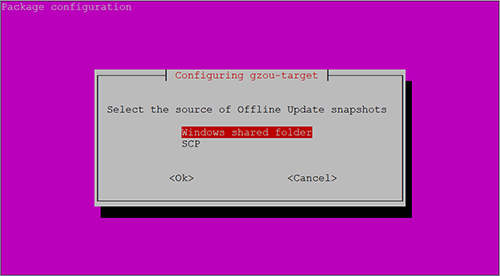

  5. Choose the method of transferring the update archives to the offline instance:
    1. Select Windows shared folder (Samba share). In this case, you will have to specify the path to a Windows share from the isolated network, where the offline instance will automatically connect to retrieve the update archives. Enter the credentials required to access the specified location.
    2. Select SCP if you will manually transfer the files to the /opt/bitdefender/share/gzou/snapshots/ folder of the offline instance via SCP.
      If you want to change the transfer method at a later time:
      1. Access the offline instance's TTY terminal in your virtual environment (or connect to it via SSH).
      2. Log in with the bdadmin user and the password you have set.
      3. Run the command sudo su to gain root privileges.
      4. Run:
        rm -f /opt/bitdefender/etc/gzou-target.json
        dpkg-reconfigure gzou-target
        A configuration dialog will appear where you can make the changes that you want.

  2. Transfer the update archive to the offline instance using one of the methods below:
    • Samba share
      Use a USB stick to transfer the update archive to the configured Samba share from the isolated network. The files will be automatically pulled into the following offline instance directory: /opt/bitdefender/share/gzou/snapshots/
    • SCP
      Manually transfer the files to the /opt/bitdefender/share/gzou/snapshots/ folder of the offline instance via SCP.
