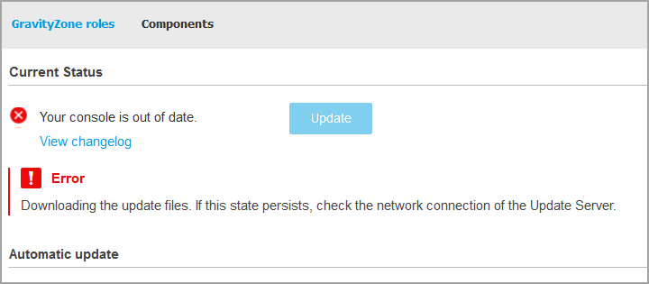

    If your GravityZone version is older than version 6.41.2-1, you need to run two updates: first to bring your GravityZone to this version, and second to update the OS.
    After the first update, wait until repositories have finished mirroring. Meanwhile, you may notice the following error: "Downloading the update files. If this state persists, check the network connection of the Update Server", informing you that GravityZone is not ready for the update.

Q3: Why isn’t the update starting when I click the Update button?
A: Most probably, pre-requirement conditions are not met. Check the errors and warnings that appear in the Configuration > Update > GravityZone roles page.
