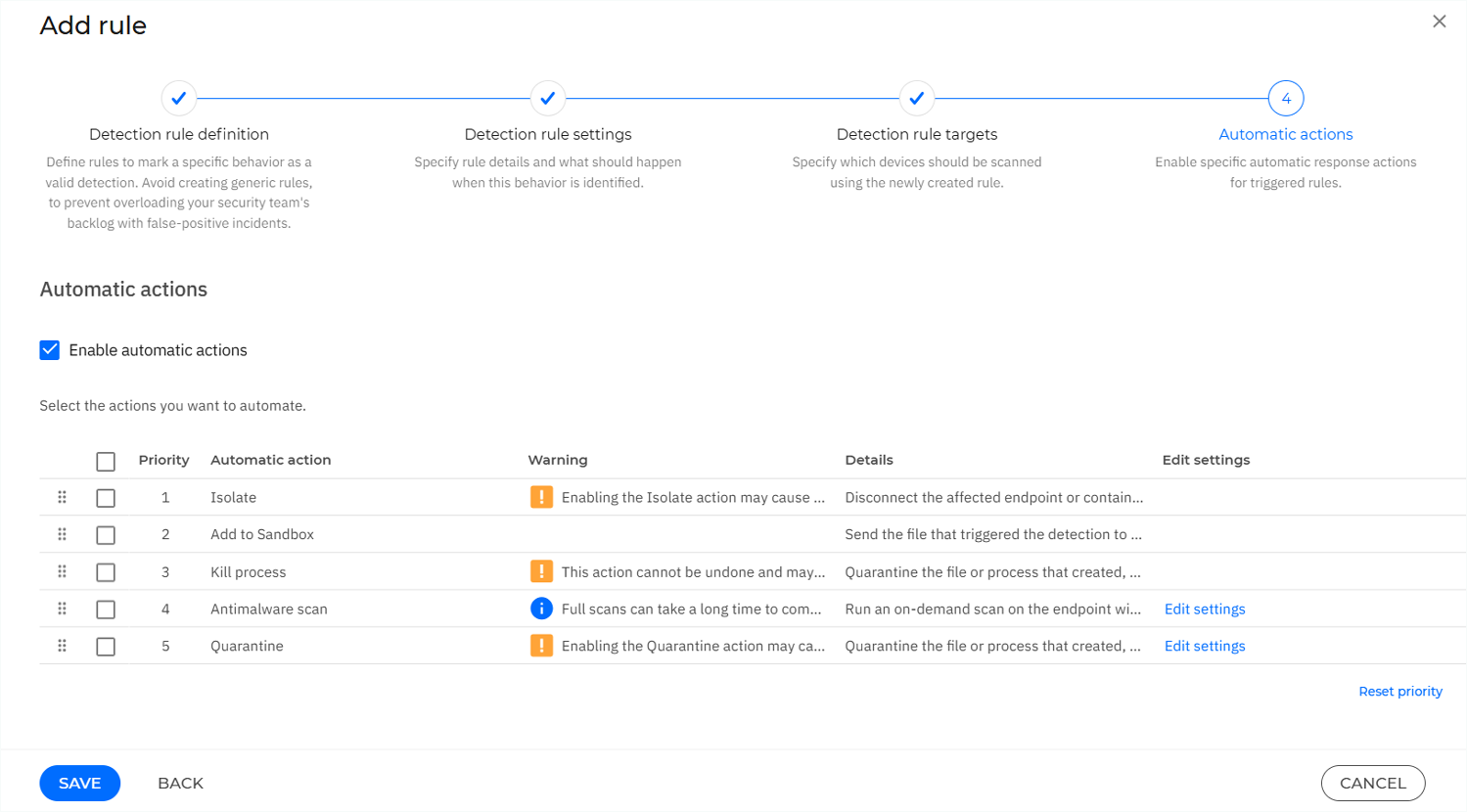

  16. Optional: At the Automatic actions step, configure which response actions are automatically triggered when the YARA detection rule is matched and set their execution priority.
    1. Select Enable automatic actions to activate automatic actions.
    2. Drag and drop the response actions to reorder them according to your desired priority.
      To restore the default order, click Reset priority.
    3. Select the actions you want to enable for the YARA rule.
      The following automatic actions are available:
      • Isolate
      • Add to Sandbox
      • Kill process
      • Antimalware scan
      • Quarantine

  19. Click Save.
  20. If any of the Isolate, Kill process, or Quarantine actions are selected, the dialog box below is displayed. After reviewing the rule configuration, click Create rule.

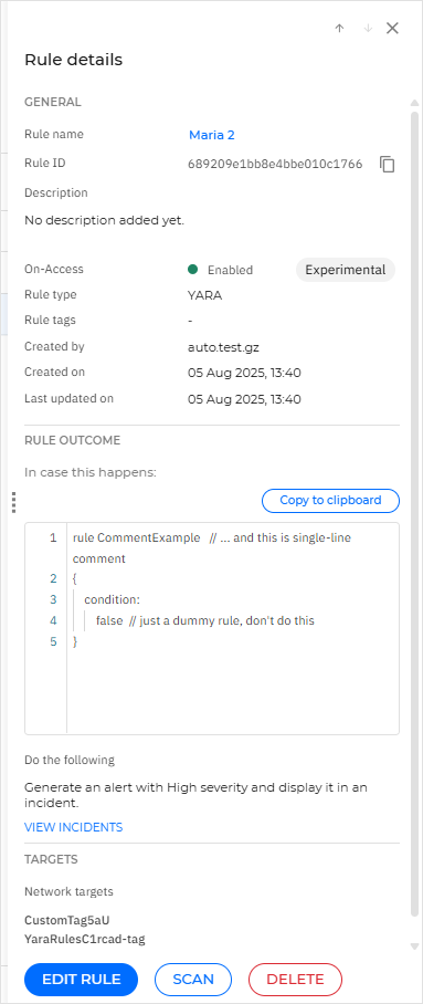

Viewing YARA rule details
Clicking one of the YARA rules in the table opens its details panel. The details panel for YARA rules contains information related to the rule name, ID, description, YARA query, and other rule details.
  1. The Copy all to clipboard button makes it easy to copy the entire YARA query to the clipboard.
  2. The View incidents option redirects you to the Incidents page. Prefilled queries run automatically to retrieve all the incidents generated by the YARA rule.
  3. The Edit rule button brings up the rule definition window, where you can change the rule details.
