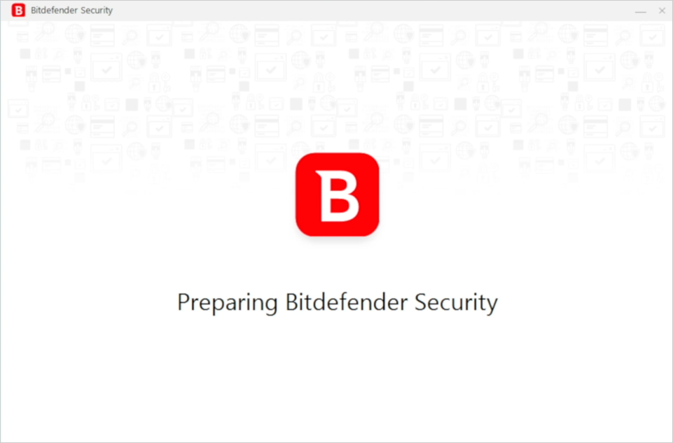

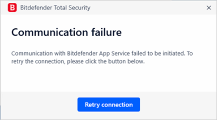

Some users have encountered an error that prevents the Bitdefender interface from launching properly: “Communication failure. Communication with Bitdefender App Service failed to be initiated.” Additionally, attempts to reinstall Bitdefender result in the installation process stalling at “Preparing Bitdefender Security” without progressing further.
Communication failure. Communication with Bitdefender App Service failed to be initiated.   Preparing Bitdefender Security

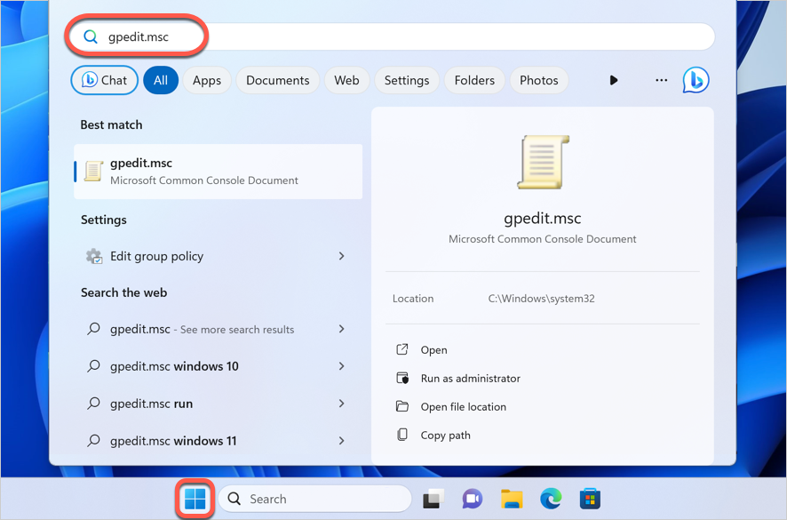

1. Click on the Start menu ( ⊞ ), type gpedit.msc and press Enter on your keyboard.
gpedit.msc
2. If Windows prompts you to allow the action, click “Yes” / “Continue” to proceed.

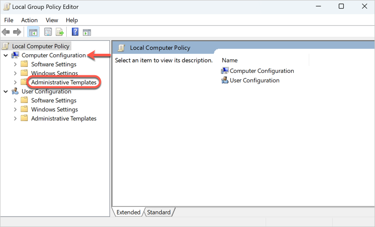

3. The Local Group Policy Editor window will appear. In the Computer Configuration section, double-click on Administrative Templates.

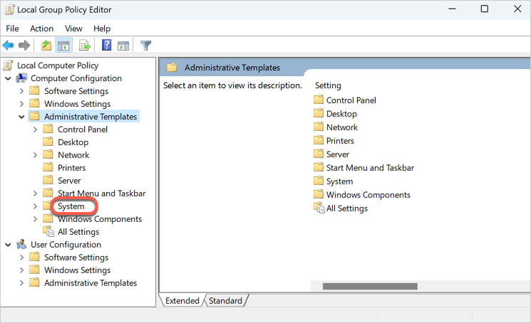

4. After expanding the Administrative Templates entry, double-click on System.
System

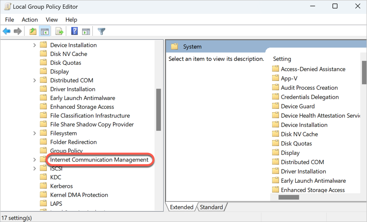

5. Within System, scroll down until you locate and double-click on Internet Communication Management.

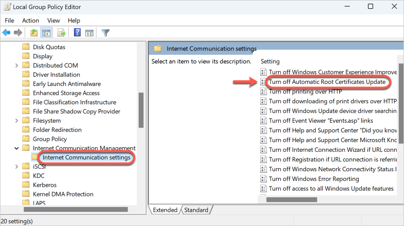

6. Double-click Internet Communication settings, then, on the right side of the window double-click the item Turn off Automatic Root Certificates Update.

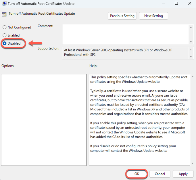

7. Select Disabled and click OK to apply the changes.
Disabled
