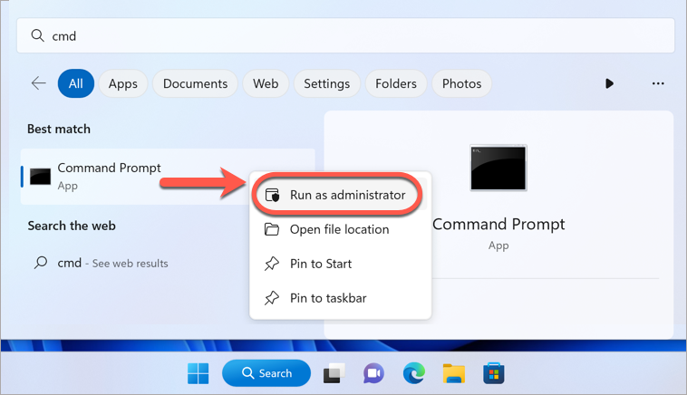

- Click the Windows Start menu (Windows logo ⊞ in the bottom-left corner).
- Type cmd in the search bar.
- Right-click on Command Prompt from the search results and choose the Run as administrator option.

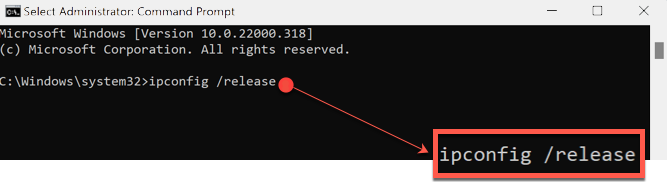

- This will open a black window with some text. In the black window, type exactly ipconfig /release then press the Enter key on your keyboard. Wait a moment.
- Next, type ipconfig /flushdns and press Enter again. Wait a moment.
- Type ipconfig /renew and press Enter once more. Wait a moment.
- Type netsh winsock reset and press Enter. Give it a little time.
- Lastly, type netsh int ip reset and press Enter. Wait a bit.
- After you’ve entered all the commands and they’ve finished running, restart your computer to apply changes.
