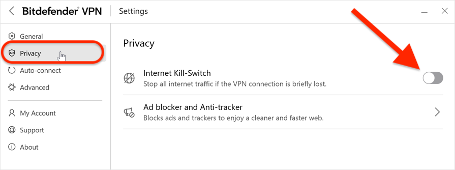

8. Turn off Kill Switch
If the Kill Switch feature is enabled before the connection is fully established, it may interrupt the VPN before it can configure routing correctly.
- Open Bitdefender VPN → Settings → Privacy → temporarily disable Internet Kill Switch.

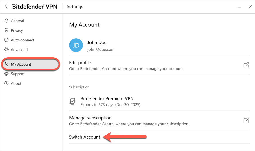

11. Sign-in again
To make sure you are signed in with the right Central account and the VPN app communicates properly with Bitdefender Central, use the Switch Account feature:
- Click Settings at the top of the Bitdefender VPN window.
- Next, select My Account on the left hand side menu and click on Switch Account.
- Enter the email & password associated with your Bitdefender Central account, then try again to connect to VPN.

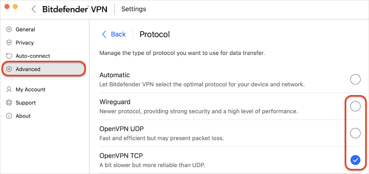

7. Try other VPN protocols
Some networks restrict specific VPN types, and switching the protocol can often restore connectivity.
- Open Bitdefender VPN → Settings → Advanced → Protocol → select a different protocol (e.g. Wireguard, OpenVPN UDP, OpenVPN TCP).

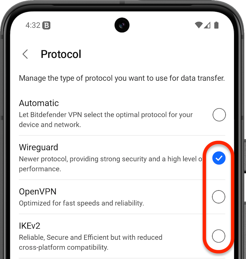

9. Try other VPN protocols
- Open Bitdefender VPN → Settings → Advanced → Protocol → select a different protocol (e.g. Wireguard, OpenVPN, IKEv2).

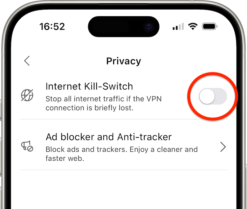

10. Turn off Kill Switch

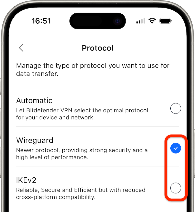

- Open Bitdefender VPN → Settings → Advanced → Protocol → select a different protocol (e.g. Wireguard, IKEv2).
