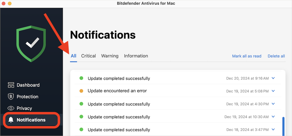

- Check update error frequency: Open Bitdefender, click “Notifications” on the left-side menu, and select “All” tab. If you see occasional update error notifications followed by successful updates, no action is required — Bitdefender is up to date.
- If no successful updates in 24 hours: Use the table of contents below to quickly jump to the solution for your specific update error.

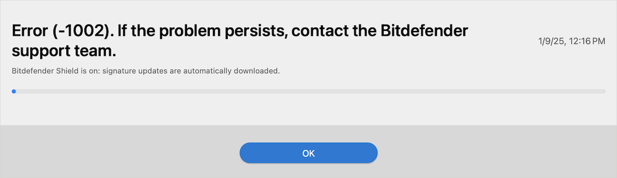

Error -1002, -1011: Internet Connection Issues
These errors occur when your internet connection is unstable or temporarily unavailable.

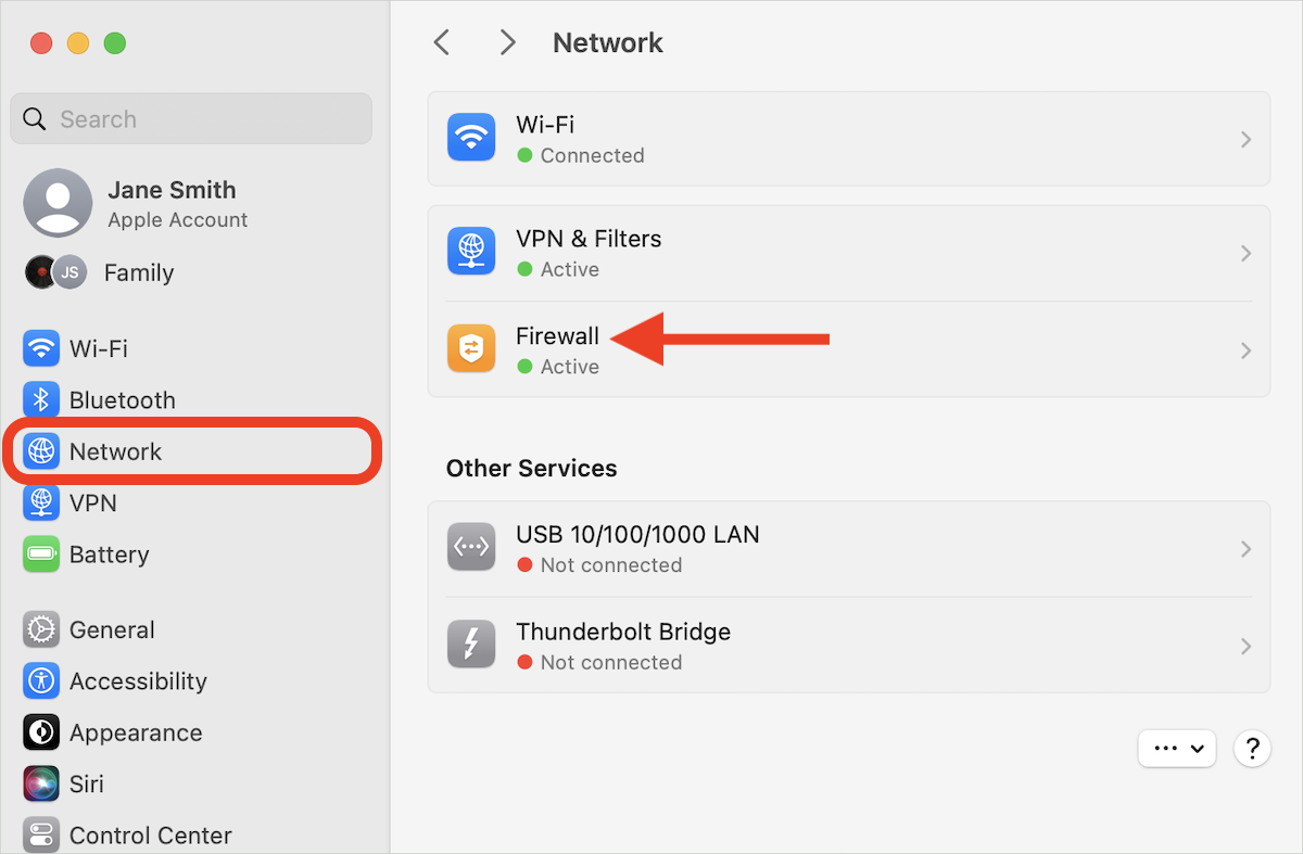

- Disable firewall temporarily:
- Turn off any third-party firewall apps (e.g. Little Snitch) running on your Mac or router.
- To turn off macOS firewall, follow these steps based on your macOS version:
- macOS Ventura 13 and later:
- Click the Apple logo at the top left of your screen.
- Select System Settings in the menu.
- Click Network in the sidebar, then click Firewall on the right.
- Use the switch to turn off the Firewall.

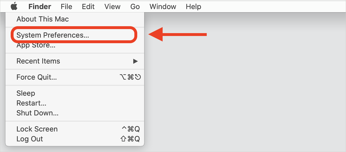

- macOS Monterey 12 and earlier:
- Select System Preferences in the menu.

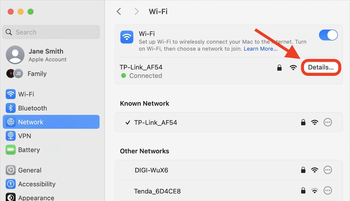

- Disable proxy settings:
- To turn off the proxy server on a Mac, follow these steps based on your macOS version:
- Select Network in the sidebar, then choose the network you are connected to on the right.
- Click the Details button.
- Select Proxies in the sidebar and turn off all proxy switches on the right.

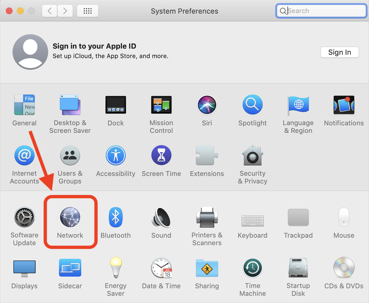

- Go to Network.
- Select the network you are connected to in the sidebar, then click the Advanced button on the right.
- Open the Proxies tab, then uncheck all proxy settings.

- Disable proxy temporarily:
- Ensure you’re not using a proxy that requires authentication, as Bitdefender Antivirus for Mac can only update when the proxy server doesn’t require authentication. There’s no need to adjust any Bitdefender settings.
- If you must use a proxy server that requires authentication, follow these steps to temporarily switch to a direct connection and allow Bitdefender to update:
- Type
*.bitdefender.comin Bypass proxy settings for these hosts & domains and click OK.

- Go to Network.

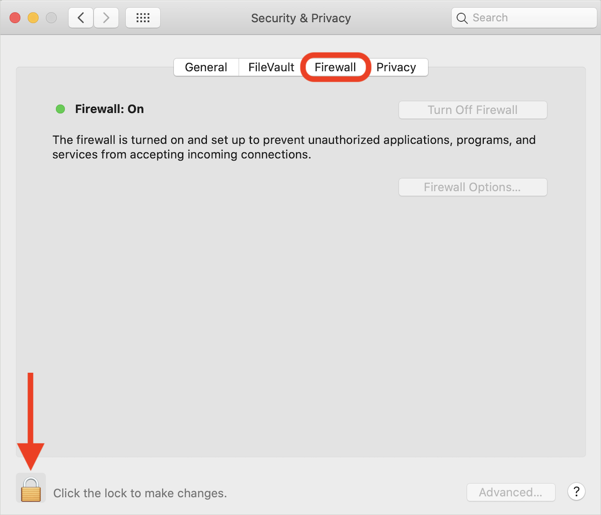

- Go to the Security & Privacy panel.
- Open the Firewall tab.
- Click the padlock icon in the bottom left corner and enter your Mac administrator password when prompted.
- Click the Turn off Firewall button.

- Change DNS settings:
- Try connecting your Mac computer to a different internet network (e.g., using your phone’s hotspot).
