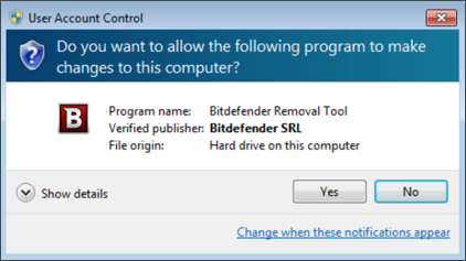

Step 2: Double-click the downloaded file BDREvilDecryptor.exe and allow it to run by clicking Yes in the User Account Control dialog box.

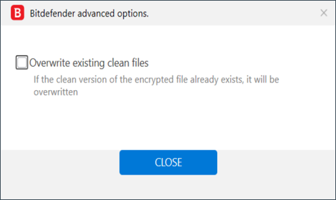

You can also check the “Overwrite existing clean files” option under ADVANCED OPTIONS, so the tool will overwrite any existing clean files with their decrypted equivalent.
Then press the START TOOL button.
