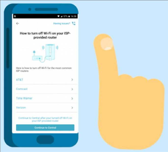

Option B. If you have a modem-router combo device, you cannot unplug it. Just turn off its Wi-Fi in the Central app. You’ll find a quick guide on how to disable Wi-Fi on most router models.
option B

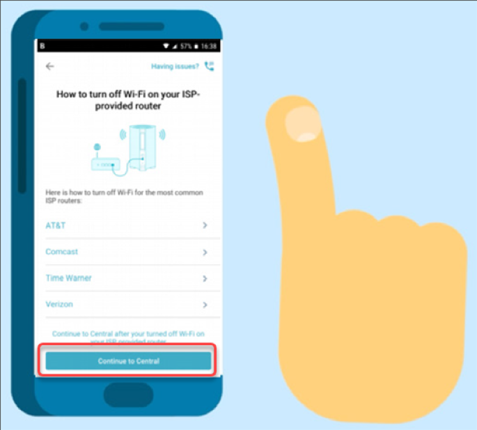

Step 22. Tap Continue to Central after turning off Wi-Fi on your ISP provided router.
Installing Bitdefender BOX using your ISP-provided router
