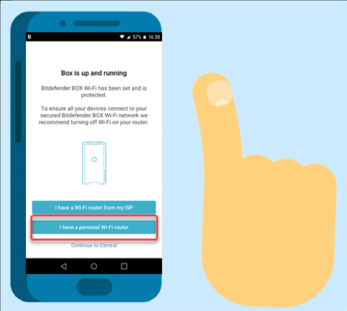

Step 19. Tap I have a personal Wi-Fi router in the Central app.

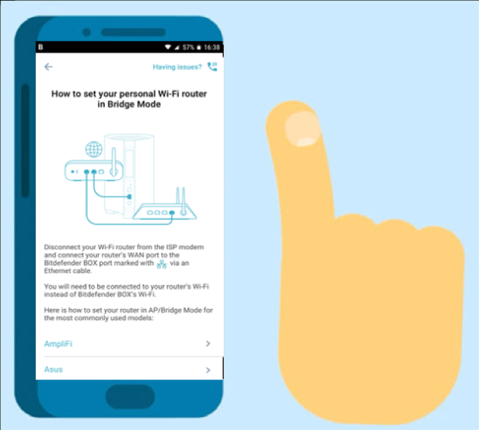

Step 20. Disconnect your personal router from the ISP modem and connect your router’s WAN port to the Bitdefender BOX port marked with this sign via an Ethernet cable. You will need to stay connected to your router’s Wi-Fi instead of Bitdefender BOX Wi-Fi.

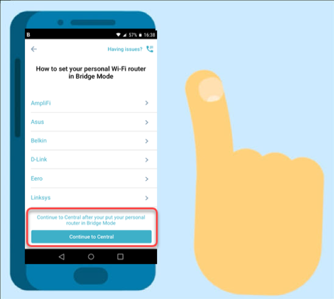

Unsure how to set your router to AP or Bridge Mode? We have a handy list of instructions for the most popular router models.
Step 21. Tap Continue to Central after you put your personal router in Bridge Mode.
