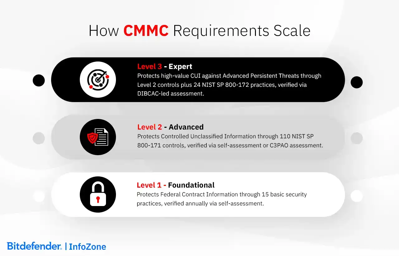

How CMMC Requirements Scale
Level 1: Foundational
Most often, smaller companies providing common products or services fall under this category, such as contractors who handle Federal Contract Information (FCI) - information not for public release but not classified or sensitive.
At this level, the organization must follow 15 basic security practices. These come from the Federal Acquisition Regulation (FAR) 52.204-21. The focus is on simple but basic controls – like limiting access and securing systems and physical spaces.
Compliance is checked through a self-assessment annually. The results must be reported to the Supplier Performance Risk System (SPRS). You cannot use Plans of Action and Milestones (POA&Ms) to delay requirements. Specifically, at Level 1, all practices must be fully implemented before the self-assessment. POA&Ms are not permitted to cover missing controls; organizations must correct any gaps before submitting results to SPRS. Documentation is minimal and should show that each practice is in place.
Level 2: Advanced
CMMC Level 2 compliance is required for contractors that process or store Controlled Unclassified Information (CUI). This level applies to a wide range of suppliers in the DoD supply chain, particularly those involved with technical documentation, engineering data, or other unclassified but sensitive project information. It incorporates all 110 controls from NIST SP 800-171, covering 14 cybersecurity domains such as access control, incident response, system integrity, audit logging, and risk assessment.
Assessments may be conducted via a self-assessment when contracts involve lower-risk CUI, or third-party assessments conducted by a Certified Third-Party Assessment Organization (C3PAO) for contracts with higher sensitivity. When permitted, POA&Ms must meet CMMC closure standards, typically within 180 days and with a minimum score threshold.
Level 3: Expert
Targets organizations supporting DoD programs where high-value CUI is at risk from Advanced Persistent Threats (APTs). It includes the 110 controls from NIST SP 800-171, along with an additional 24 practices from NIST SP 800-172, focused on advanced threat detection, continuous monitoring, and incident response capabilities.
Only the Defense Industrial Base Cybersecurity Assessment Center (DIBCAC) conducts Level 3 assessments. Currently, there are about 1,500 contractors that qualify for this level, coming from critical defense areas such as weapons systems, intelligence, and classified operations.

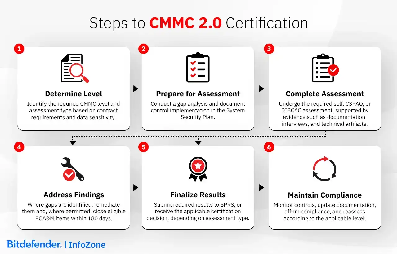

CMMC 2.0 Certification Process
CMMC is different from typical compliance frameworks because it ties certification directly to eligibility for Department of Defense (DoD) contracts. Understanding the certification process is, therefore, critical for maintaining a competitive edge. There are key differences at each level, but there are certain general steps in the certification process.
Determine Your Required Level and Assessment Type
CMMC level is assessed based on contract stipulations and the sensitivity of the information handled.
Prepare for Certification
Effective preparation involves conducting a gap analysis against the required practices and developing a System Security Plan (SSP) that documents how each control is implemented. For any unmet requirements, organizations may use a POA&M - allowed at Levels 2 and 3 only, with strict limitations and a 180-day remediation window.
Assessment Process
  • Self-Assessments (Level 1 and some Level 2): Conducted internally using DoD-provided methodology. Results must be submitted annually to the SPRS, along with a senior official’s affirmation.
  • Third-Party Assessments (Level 2 C3PAO): Include a pre-assessment planning phase, formal evidence review, interviews, and technical validation. Findings may result in:
    1. Final Certification
    if all requirements are met
    2. Conditional Certification if minor issues are documented in a POA&M and resolved within 180 day
    3. Failure, requiring remediation before reassessment
    4. Government-Led Assessments (Level 3): Conducted by the DIBCAC following successful Level 2 certification. These are more intensive, especially around controls targeting advanced persistent threats.
Evidence Requirements
  • Documentation – Basically, anything that outlines what the organization is doing and wants to do, from procedures and policies to System Security Plans (SSP)
  • Personnel Interviews – To verify that staff know their responsibilities and are actually following the documented practices
  • Technical Artifacts – System logs, configuration exports, screenshots - anything that shows the controls exist and are functioning as described
  • Direct Observations – Seeing the controls in action, like Multi-Factor Authentication (MFA) in use or how system access is restricted in real-time
As a rule of thumb, it is recommended to organize your evidence by control family so it's easier to match to the requirements. Also, as gaps or inconsistencies slow things down, do a sanity check upfront and make sure that what is written, said, and shown matches.
Maintaining Certification
Certification remains valid for a period of three years; however, organizations are required to affirm compliance annually to remain eligible for federal contracts. Ongoing compliance depends on continuous monitoring of security controls, timely updates to documentation as systems evolve, and maintaining a state of readiness for potential audits or reassessments at any time.
Working with Assessment Partners
Organizations subject to third-party assessments should engage a C3PAO with experience in their industry and familiarity with applicable technologies. Consultants and Registered Provider Organizations (RPOs) can provide support during preparation by offering gap analyses, documentation reviews, mock assessments, etc.
Steps to CMMC 2.0 Certification
