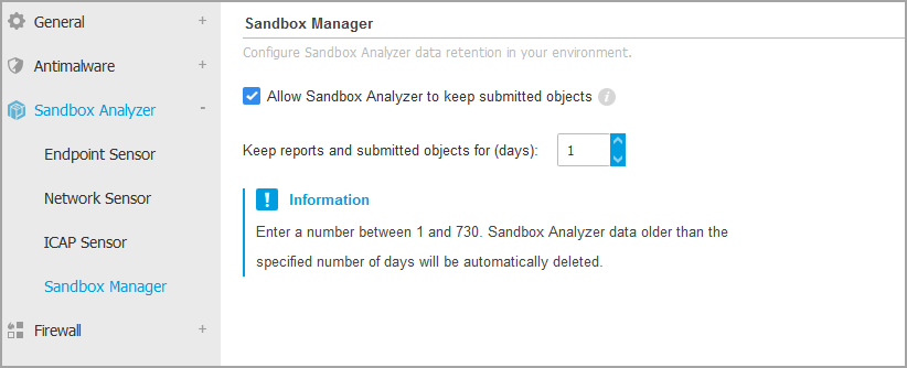

In this section you configure data retention for your Sandbox Analyzer instances:
Select the check box Allow Sandbox Analyzer to keep submitted objects.
This setting allows you to use the Resubmit to analyze option in the submission cards area of the Sandbox Analyzer reporting interface.
Specify the number of days you want Sandbox Analyzer to keep reports and submitted objects on the datastore. The default period is 14 days.
You can extend this interval to 730 days. After the defined period expires, all data will be deleted.
![policies-sandbox-op-manager.png](image/uuid-8c02e228-b426-7f7b-66bc-f5c4247ab56e.png)
