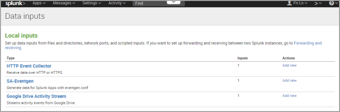

  2. Go to Settings > Data Inputs > HTTP Event Colector.
    Image-Splunk-http-event

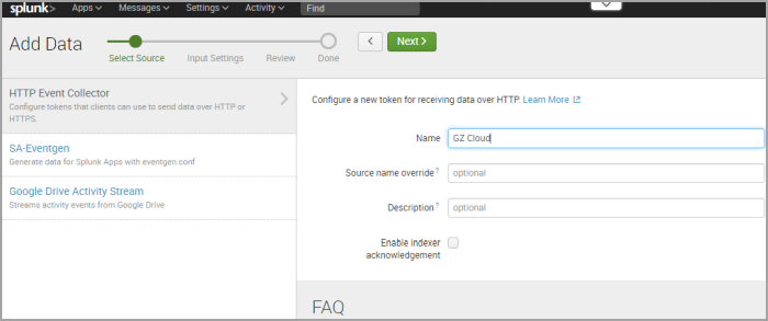

  3. Click New Token.
  4. In the Add Data screen, fill in the Name field, as suggested in the image below, and click Next.
    Image-Splunk-select-source

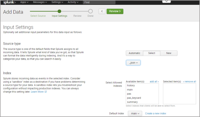

  5. For Source type, click Select and choose _json.
    Image-Splunk-select-json

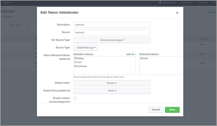

    When using Bitdefender Splunk App, after installing Splunk Bitdefender Add-on, click Select and choose bitdefender:gz as the source.
    source type

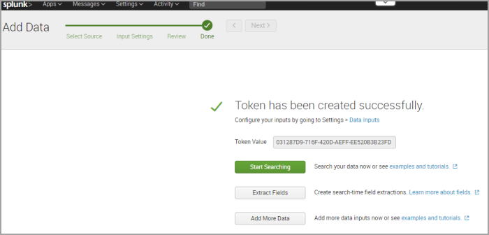

    The token has been created successfully. Copy the token value and save it. You will need it later to enable the integration.
    Image-Splunk-token

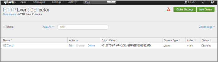

  9. Go to Settings > Data Inputs > HTTP Event Collector and click Global Settings.
    Image-Splunk-global-settings
  10. In the new window, under All Tokens section, select Enabled.
    Image-Splunk-all-tokens
  11. Click Save.
