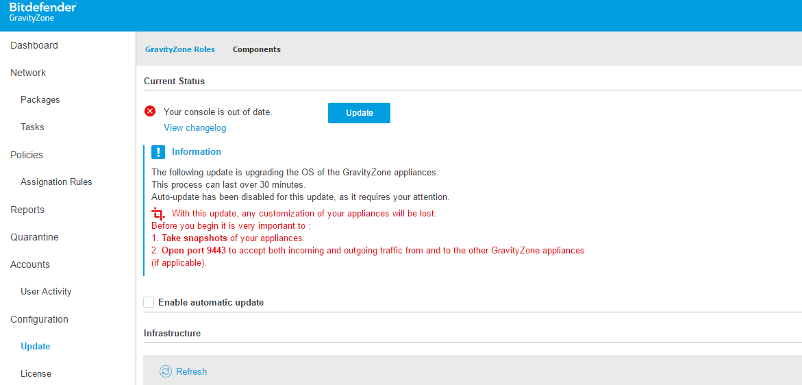

Perform an update task in Control Center. GravityZone provides regular fixes and improvements, but also updates its sources and makes your environment ready for OS upgrade. This is what you have to do:
  1. Log in to Control Center.
  2. Go to Configuration > Update.
  3. Click the Update button in the GravityZone Roles tab.
  4. The updating process begins and it might take about 30 minutes or more. Upon completion, you are informed that your console is out of date and the Update button appears again.
The Update page in Control Center after completing the first stage.

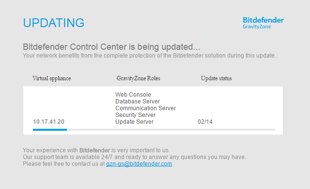

  3. After confirmation, the OS upgrade begins and might last about 30 minutes or more. A progress window will show you how the process is taking place. Depending on your GravityZone configuration (whether it is a single appliance having all roles or there are multiple appliances with specific roles), the progress window looks slightly different.
    The progress window for a GravityZone environment with a single appliance having all roles.
    The OS upgrade must complete 14 steps, which mainly consist of:
