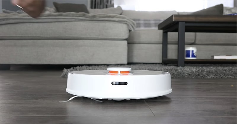

Using this inspiration, the researchers built a proof-of-concept attack using a Xiaomi Roborock vacuum cleaning robot. They called their creation “LidarPhone”, which they described as a “remote, stealthy, and scalable acoustic eavesdropping attack.”
In a scenario presented by the researchers in an explanatory video, they described how a sensitive Zoom conversation could vibrate nearby objects such as a trashcan.
A compromised robot vacuum cleaner might then target the trashcan, and record its vibrations via its LiDAR sensors. The light intensity signal gathered by the hacked vacuum cleaner could be sent to a cloud-based server where it could later be analysed and converted back into the original audio by a remote attacker.
