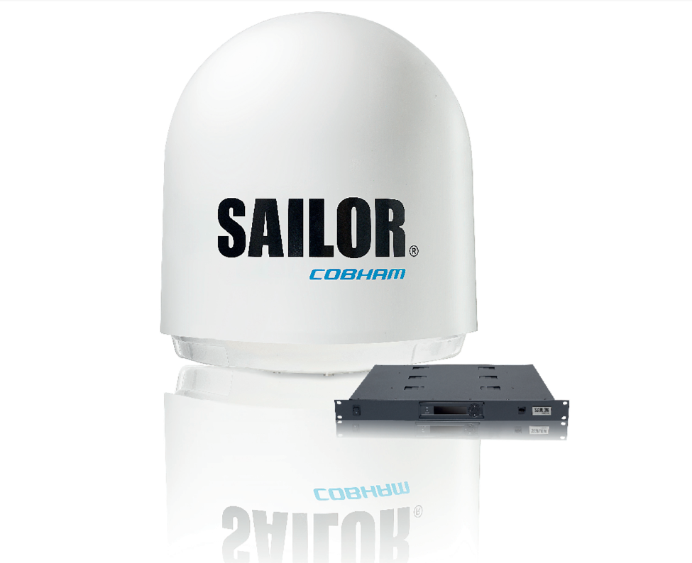

The discovery was announced Tuesday on Twitter by a French security researcher who uses the handle @x0rz (https://twitter.com/x0rz). He was experimenting with a new service from the Shodan search engine that tracks ships with very small aperture terminal (VSAT) antennas and publicly reachable web services. The researcher posted a picture showing that he successfully logged into the control panel of a Sailor 800 VSAT system.

Other security boffins joined x0rz’s experiment, some showing similar achievements: accessing Sailor VSAT system settings through a web interface (here and here), or via telnet and SSH (secure shell) protocols. Attackers with access to the VSAT configuration panel could change azimuth calibration settings, which would feed erroneous information to the ship. They could also install a different firmware, retrieve data logs or track the ship’s course.
Unauthorised changes to the configuration of VSAT gear alone is unlikely to allow hijacking of a ship, but it could lead to access into the local network from where attackers could cause damage to other connected devices, some of critical importance.
Exposing sensitive gear directly to the internet is a serious problem, as repeatedly highlighted by security researchers. Such a warning is also included in the user manual for Sailor VSAT systems, at least from model 600 onward – currently, the latest is model 900. The documentation for the kit is explicit, saying it “is not designed to be connected directly to the Internet” and “must be connected behind a dedicated network security device such as a firewall.” The default password issue is addressed as well, with a warning that it should be changed if communication ports are exposed to the internet, otherwise remote users with malicious intent could access the VSAT system and render it inoperable.
Image credit: Cobham
