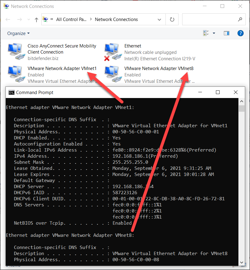

For example, if VMware is installed on your Windows computers, this MAC address will appear on both PCs: Ethernet adapter VMware Network Adapter VMnet1: Connection-specific DNS Suffix . : |

If your devices replace each other in Bitdefender Central and you’ve found out that they have one or more MAC addresses in common, you need to either remove, modify or disable the identical MAC addresses so that both systems can show up in Central. Below are three solutions with different degrees of difficulty.
Solution 1: Remove the app that generates duplicate MAC addresses – Difficulty level Easy
The easiest way is to uninstall the application that generated the same MAC address in the first place. If you no longer use that VPN app, virtualization software, etc. simply uninstall it.
How to uninstall an app on Windows | How to uninstall an app on macOS
Next, restart the system that is missing from Bitdefender Central, and you’ll be able to see it again under the ‘My Devices’ section.
Solution 2: Disable duplicate network adapters – Difficulty level Medium
If you wish to keep your virtual machine software or VPN, disable its corresponding network adapter instead. This way, Bitdefender Central will no longer think it’s the same computer and display only one at a time.
