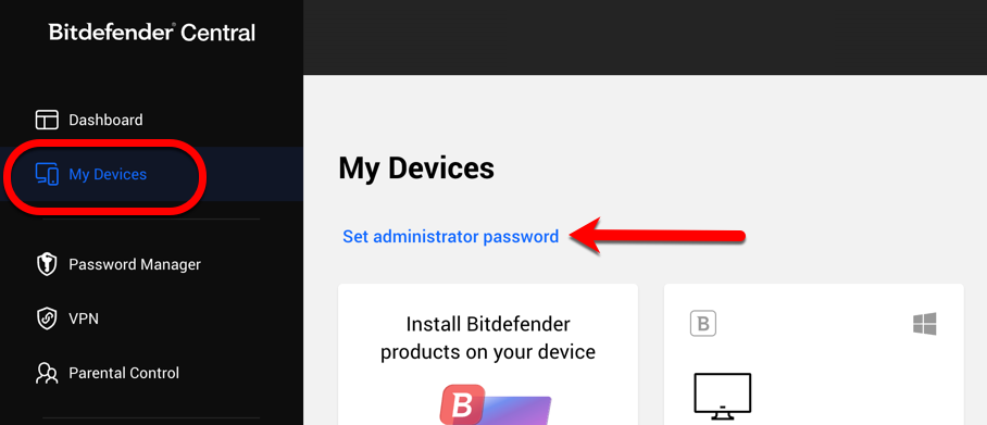

1. Log in to your Bitdefender Central account at https://central.bitdefender.com
2. Select My Devices on the left-hand side menu and click on Set administrator password.
password protect Bitdefender settings
3. Turn off the Administrator Password option within the My Devices section. The color of the switch will change from blue to gray.
Administrator password
The password set for Bitdefender settings will be disabled on all devices that use the Bitdefender Small Office Security subscription.
