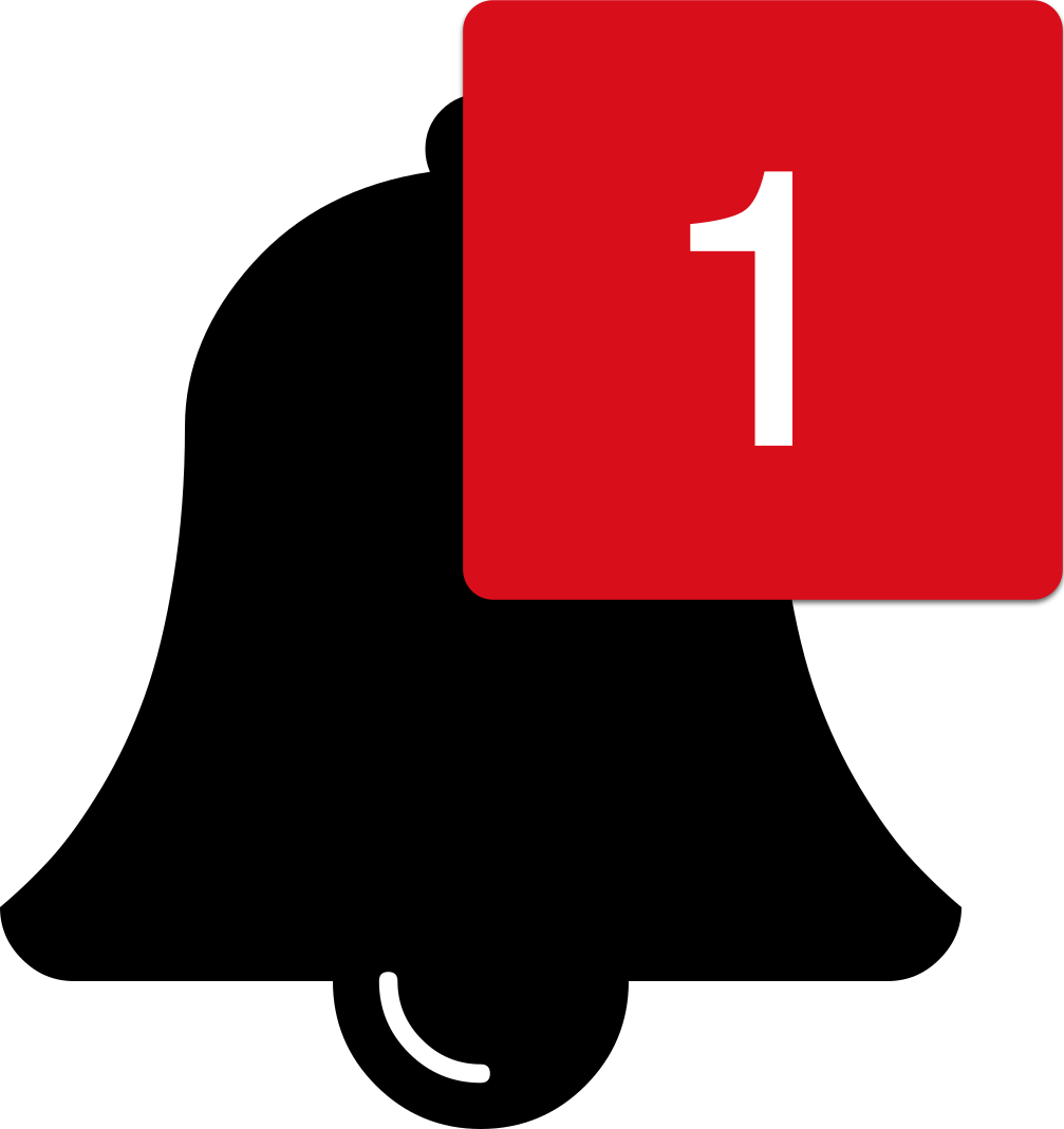

To be sure the infection is gone, bring up your Bitdefender security program and click on Notifications Bitdefender notification indicating an infectionin the menu on the left-hand side of the interface. Every time a critical event occurs, a counter can be noticed on the bell icon. Access the Critical tab, then click the entry concerning threat detection. It will show a short description of the action Bitdefender took on the malware, and the date and time when it occurred.
If the Notification indicates that Bitdefender successfully blocked the threat, you are safe. Bitdefender already took care of the infection.
On the other hand, if the Notification states that the threat could not be deleted, follow the steps below to learn how to deal with the malware.
