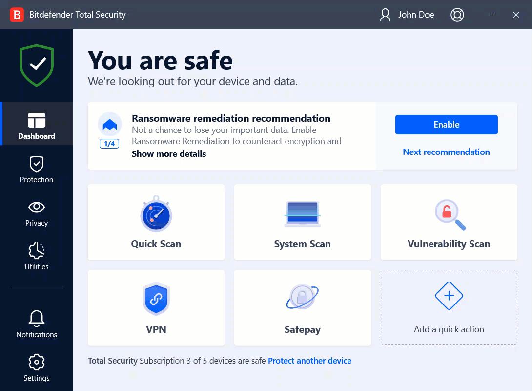

1. Click the Protection menu on the left side of the Bitdefender interface.
2. In the Antivirus panel, click Open.
3. Click the ••• button next to System Scan, then choose Edit.
4. In the Manage Scans window, use the drop-down menu to change Scan task priority from Low to High.
5. Click Next, then click Save.
6. Press Run Scan and wait for the system scan to end.
Bitdefender scan taking long - increasing priority
After making the above changes, you should notice that the Bitdefender scan is no longer taking an unreasonable amount of time to finalize.
