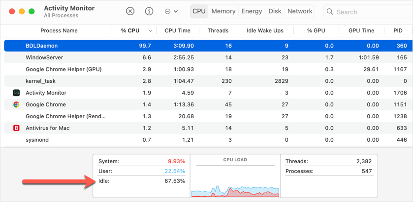

Activity Monitor shows BDLDaemon’s CPU usage in relation to the total number of processor cores. This means that if you’re using a Mac with a 6-core processor, the CPU usage can potentially reach up to 600%. Similarly, 8-core processors can go up to 800%, etc.
Actual system usage is indicated at the bottom of the Activity Monitor window. In this image, despite the impression that the BDLDaemon process is consuming 99.7% of the CPU, the system is actually 67.53% idle.
During an on-demand or background scan performed by Bitdefender, it is normal for CPU usage to increase. Scanning involves intensive processes that require significant resources to analyze files, folders, and system areas for threats. The temporary increase in resource usage that occurs during the system scan and quick scan is normal. It does not significantly slow down macOS and should not be interpreted as an issue.
