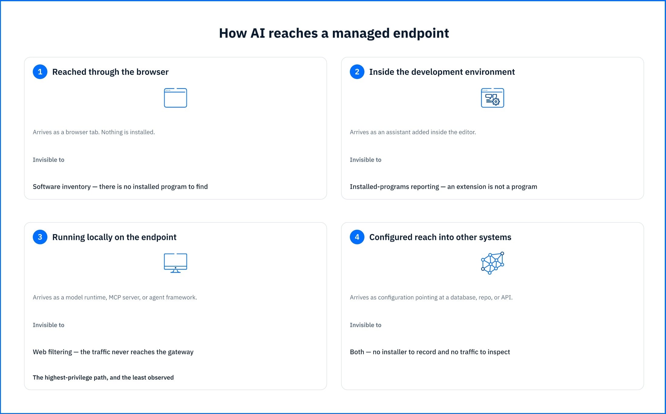

AI Visibility and Control covers four classes of exposure, and each one sits outside a control you already own.
ai-vis-control-image
AI services reached through the browser. Hosted assistants are the path most organizations already worry about. The inventory identifies which services are running, on which machines, and whether you have marked them as approved. A service with no findings is not automatically approved; a clean result on a tool your organization never sanctioned is still shadow AI. This ensures filtering decisions are based on real user activity rather than hand-picked domain lists.
AI inside the development environment. Coding assistants run inside editors that already hold source repositories, and often credentials and configuration files in the same working directory. They are rarely covered by whatever you decided about chat assistants, because nobody classified them as the same kind of tool.
AI running locally on the endpoint. Local model runtimes, MCP servers, and agent frameworks execute on the machine itself. A control that governs which websites an endpoint may reach does not see them at all. The MCP server is the sharpest case: its entire purpose is to hand a model access to something else, and it usually arrives as a configuration entry rather than as an install.
AI with reach into other systems. Where a tool is configured to connect to a database, a code repository, an internal API, or a third-party model service, that connection is part of your attack surface. AI Visibility and Control records the configured scope of those connections, not the data moving across them.

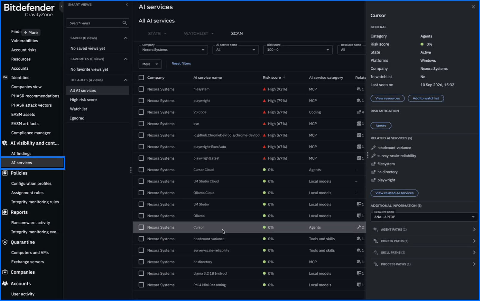

AI Visibility and Control appears in Bitdefender GravityZone Console as two views, each answering a different question.
AI Services answers "what AI is running in my environment?" It is the inventory: every discovered service with its risk score. This includes the function category, the related AI assets it depends on or exposes, its count of open findings, the affected resources and endpoints it was found on, its state of Active or Ignored, and whether it sits on the watchlist. Opening a service shows its details alongside mitigation guidance.

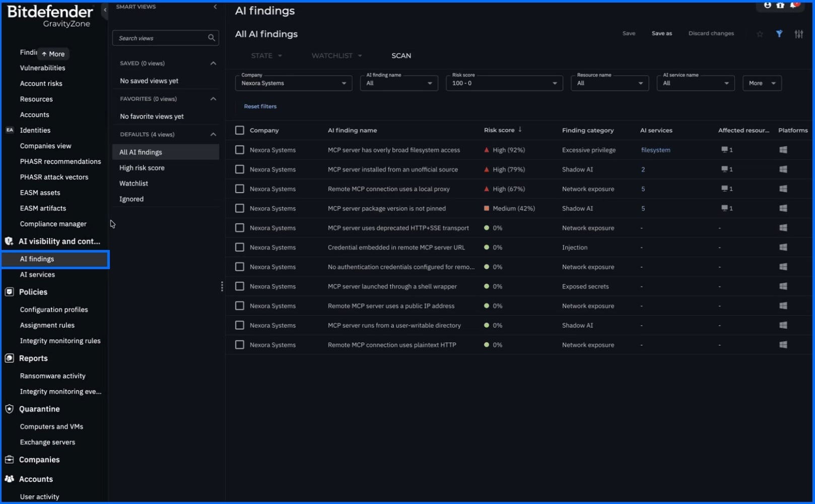

AI Findings answers "what should I look at first?" It is the prioritized risk view. Each finding includes a risk score, the service it relates to, the affected resources it was observed on, a link to mitigation guidance, and the endpoint-specific evidence behind it.
This enables you to see why a finding was raised on one machine and not another before deciding what to do. Most administrators work in AI Findings day to day and drop into AI Services for the full picture of a particular tool.

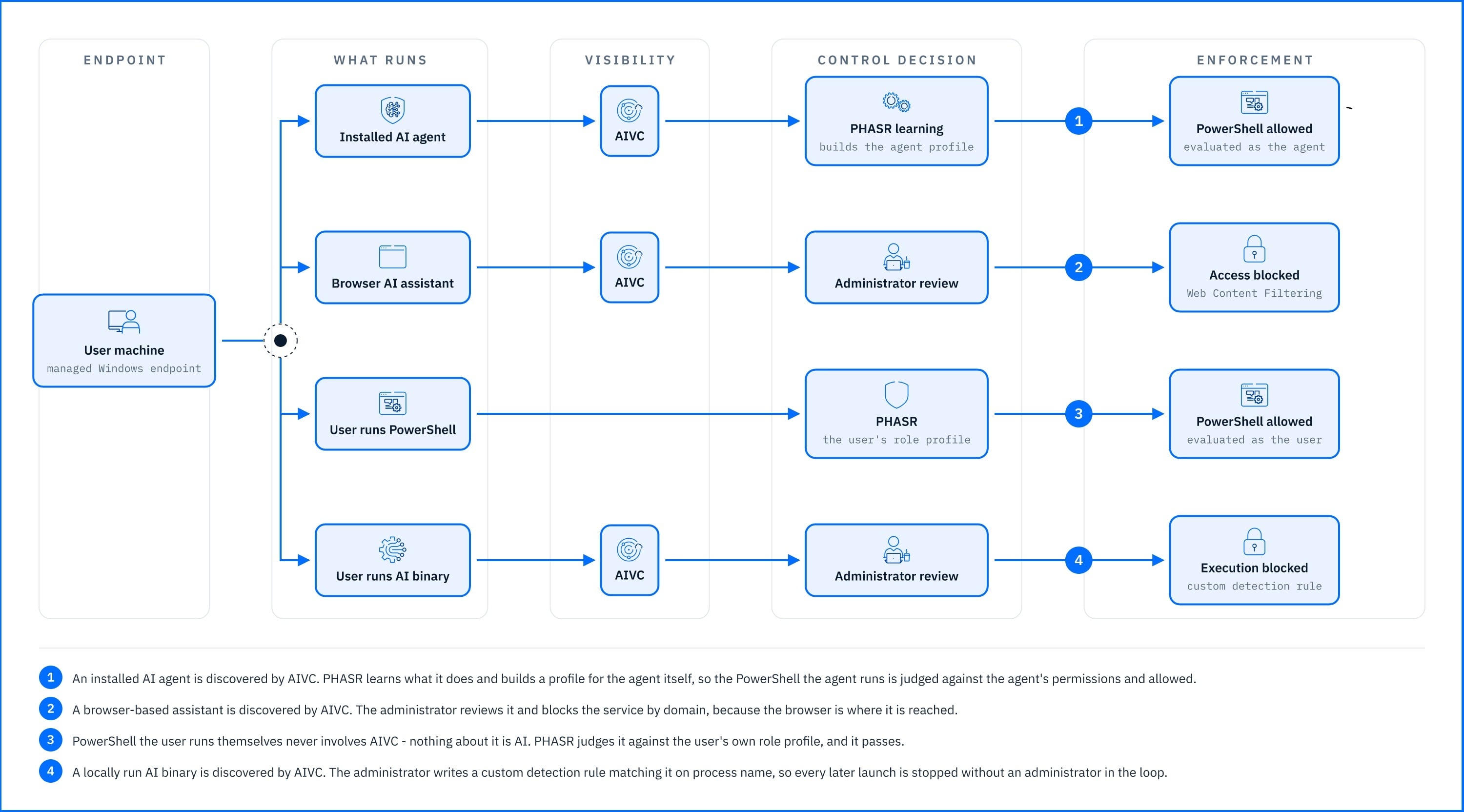

Blocking access to a prohibited service is Web Content Filtering. Most AI services are accessed through the browser, so once AIVC identifies which ones are in use, you block the domains.
Blocking a specific tool wherever it turns up is what custom detection rules do: once AIVC has named the tool, you define a rule that matches it on process name, attach Kill process as an automatic action, and every later appearance is handled without an administrator in the loop, and is company-wide or scoped to endpoints carrying a given tag.
Reducing what an installed tool is permitted to do belongs to hardening policies and to PHASR. PHASR for AI agents evaluates the agent separately from the person using the machine: processes started by a known agent binary are attributed to that agent's own behavioral profile rather than to the user's session, so the agent gets the tools its tasks require while the user's restrictions stay tied to the user's role.
